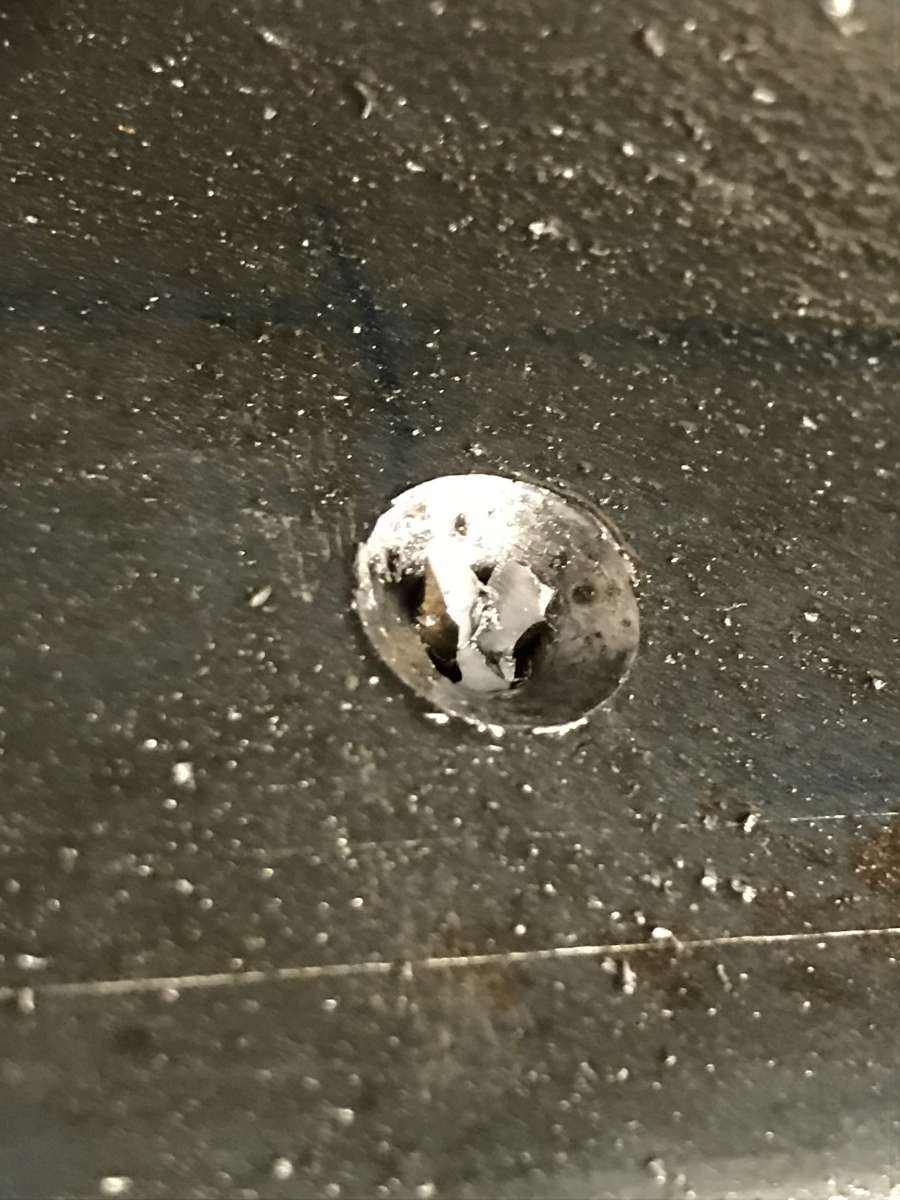

      How do I get abroken tap out. The previous owner ground it flat and placed a dummy bolt on the face of a steam chest.
      ADVISE PLEASE.

        First we need to know the size of the tap ? I would use a spark eroder but that’s because I have one. What metal is it in ? What engine. A steam chest with a missing stud or bolt in a working engine is not a good idea.

          What is the material it’s stuck in and what size is the tap?

            I broke a 1/4″ tap in aluminium after drilling undersize in error and after setting it up securely in a mill, used a solid carbide drill which got it removed easily. You have to be careful to have positive control of the feed, a drill press will be likely to break the drill.
            #831119
              The classic chemical dissolver is Alum, specifically Potassium Aluminium Sulphate, as sold by Amazon here.  Plenty of other sources.
              Watch out when ordering.  Other chemicals are called “Alum”, and they are more-or-less unsuitable compared with Potassium Aluminium Sulphate.  Ammonium Alum Aluminium Sulphate and the others are a waste of money.
              Make up a strong solution and fill the hole with it.  Leave for several hours, possibly a couple of days.  All being well the tap will slowly disintegrate.
              Potassium Aluminium Sulphate does not attack Aluminium, Brass or Bronze.  Can be used on steel, but it attacks the part as well as the tap, possibly causing unacceptable damage.  Keep an eye on it.  Not a problem if there’s enough meat to clean out and rethread next size up, but…

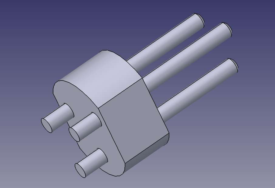

              If Alum is too corrosive, EDM or a mechanical method.   I once removed a broken tap with three piano wires passed through a rod, something like this.
              Screenshot From 2026-01-03 16-53-28
              Though it worked, more luck than judgement!

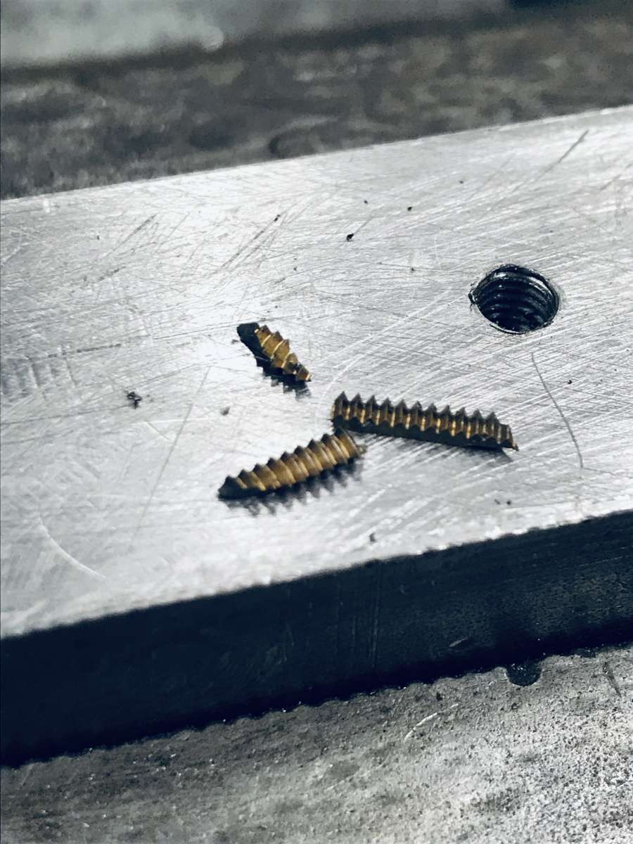

              #831149
              Dave S
                @daves59043
                I have drilled out taps with a single flute carbide cutter.
                For this to work you need a rigid machine, preferably with a quill and a quill stop.
                The problem:
                IMG_2203
                M4 IIRC snapped in a part I had a lot of work in.

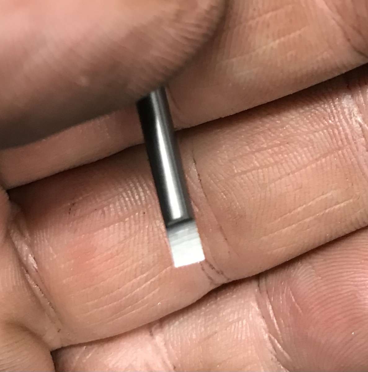

                The cutter:
                IMG_2204
                Made from a round piece of carbide on a single lip cutter grinder. Flat ended, with normal relief on the back

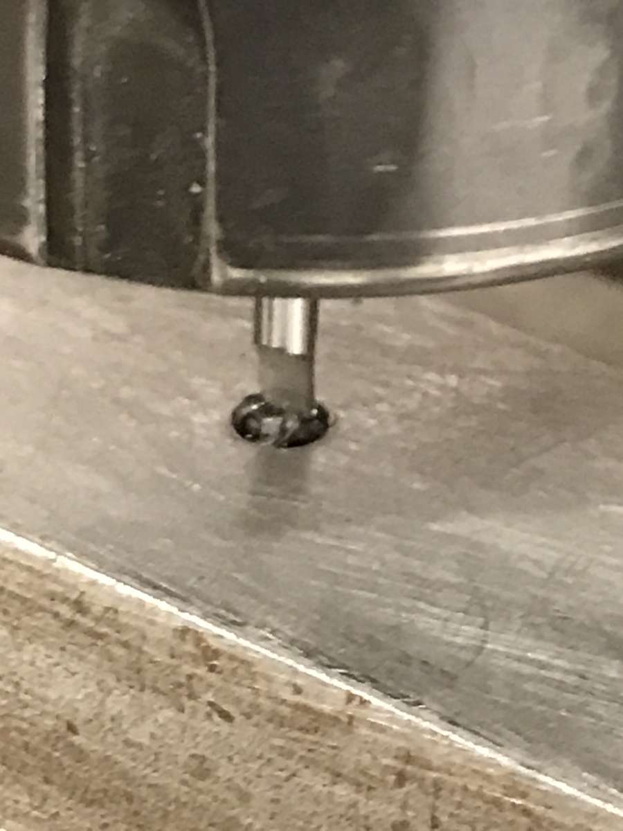

                Chucked up ready:
                IMG_2205

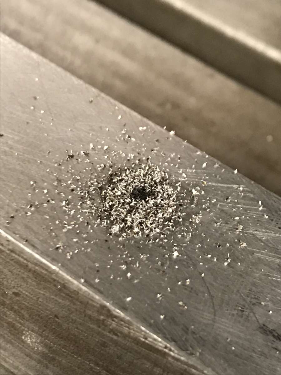

                Then peck drill 0.001” at a time, against the quill stop, and allow a bit of dwell.
                The tap comes out as very fine chips:
                IMG_2208

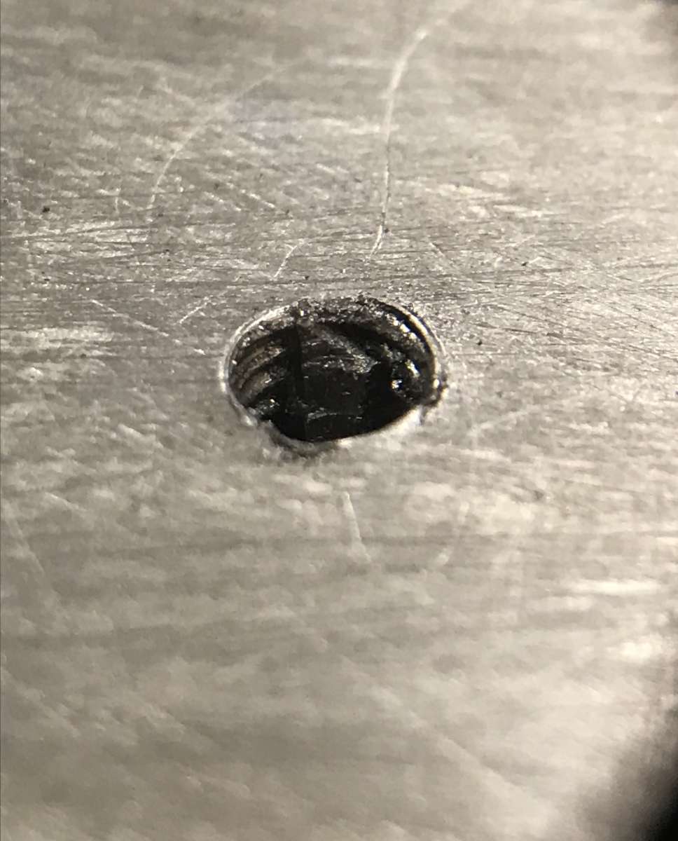

                Result 🙂
                IMG_2210
                Once you are through then you can pick out the pieces and with luck the thread is good.
