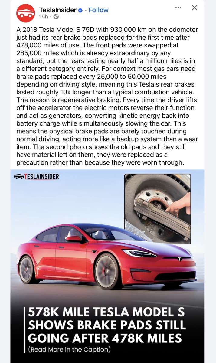

      That’s some mileage for a set of Brake Pads!
      IMG_0878
      #847453
      noel shelley
        @noelshelley55608
        Braking and it’s technology has changed over the last 50 years. Pads are much harder and much of the wear is on the discs. Those figures are interesting but I still won’t buy a Tesla. There are numerous scams in the motor trade one is that you will be told the pads AND DISCs need replacing and some times that all 4 sets at that. Noel.

          The driver is probably using the regenerative braking to slow the car, perhaps only using the brakes for that last bit of braking to bring the car to a standstill.
          I can bring my electric car to a dead stop by not touching the brake pedal, not easy to judge in a queue of traffic!

                I’m finding that after a couple of months with an EV I barely ever touch the brake pedal, although I have never been a “last few yards” heavy braker. Regenerative braking, at least on my car, seems very nicely judged for normal driving, especially in town. It shows in the way that energy consumption improves in start-stop conditions where the old diesel suffered badly.

                  The problem with regenerative breaking is that you need somewhere to put all that energy. I can see this on my Leaf, with a full charge there is almost no capacity for RB. So I don’t think you can simply skip the brakes, not without adding brake resistors or something similar.
                  And while RB is great it can also create new problems. Here where it’s wet, cold and salty, rust on the break system can be a major problem on older cars. Calipers and pads can seize up due to rust/dirt buildup if they aren’t used regularly, which causes the disk to rust. Running the brakes hot once a month can save you a lot of money.

                                More internet nonsense. Obvously an EV will use friction brakes less than an an ICE.
                                That is also the case for PHEV’s and some hybrids. Mild hybrids don’t have adequate battery capacity for significant dynamic braking. One downside, as I mentioned in the PHEV thread is you can get rusty brake disks due to lack of use. I can approach most junctions that I know in my PHEV using just the dynamic braking. It has paddles on the steering column to allow you to adjust the amount of braking. It is very noticable that dynamic braking is significantly reduced with a fully charged battery.
                                Changing brake disks at the same time as pads is not rally a “sharp” practice if there is any uneven wear or corrosion pitting. Discs are relatively cheap labour is expensive. Changing the disks at the same time as pads add little time and the new pads will last longer. What is sharp practice is charging the “book” labour hours for both the pad change task AND the disc change task. The disc change only task includes most of the labour for changing the pads.
