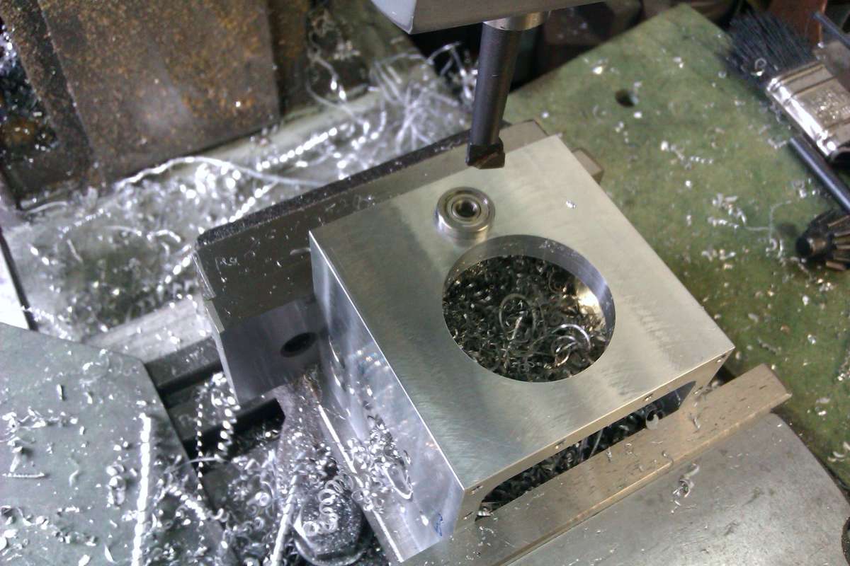

            Boring head also works for me.
            IMAG2715

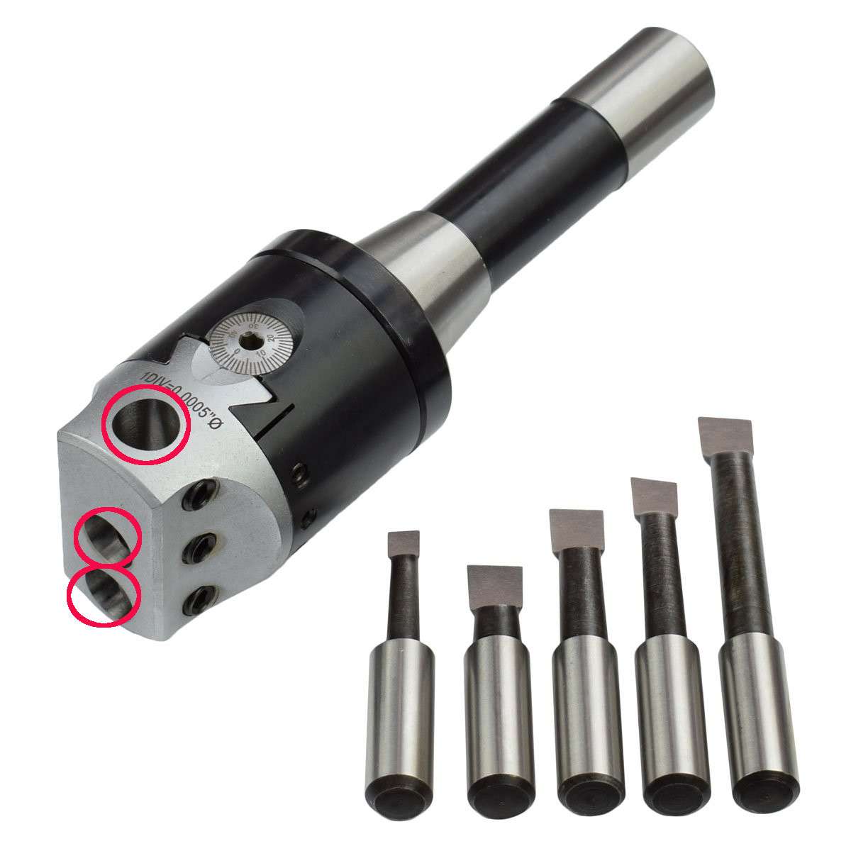

              Another vote for a Boring Head, which is a very versatile tool.  Apart from accurately making holes of any size or depth with reach of the cutter, they can hold work in a lathe to cut tapers.
              This example comes with a selection of boring bars.  Mine didn’t, and I just use the same bars bought for my lathe.
              2-inch-boring-head-R8-Shank-1
              The boring bars plug into any of the red-ringed holes.  This allows the machinist to select either horizontal or vertical reach to suit the job.
              Boring is a slow process but the holes are more accurate than other types.  Finish with several light cuts because boring bars are a bit bendy.

                        In the boring head picture I posted above can be seen a graduated wheel.  It’s turned with an Allen key.  The procedure is to drill a hole of known size, and set the cutter to just touch it.   Then calculate how many graduated turns are needed to reach the wanted diameter, and open up the hole with a series of shallowish cuts.  It’s usual to stop short, measure the hole so far accurately, and do the sums again.   Slow and accurate, not a roughing tool.
                        It pays to start big holes by roughing them out by chain-drilling, tank-cutting, sawing or trepanning.  Boring heads do a good job converting rough holes into precision centred well-finished and accurate ones.

                                As Nigel says really for fitting bearings you want to measure the hole the boring head has cut rather than a drilled hole and then use the dial to increase to the desired size measuring the hole to check or in the case of my photo use the bearing as a gauge. Much like boring a hole in the lathe you cut, take a measurement and then put on remaining cuts.

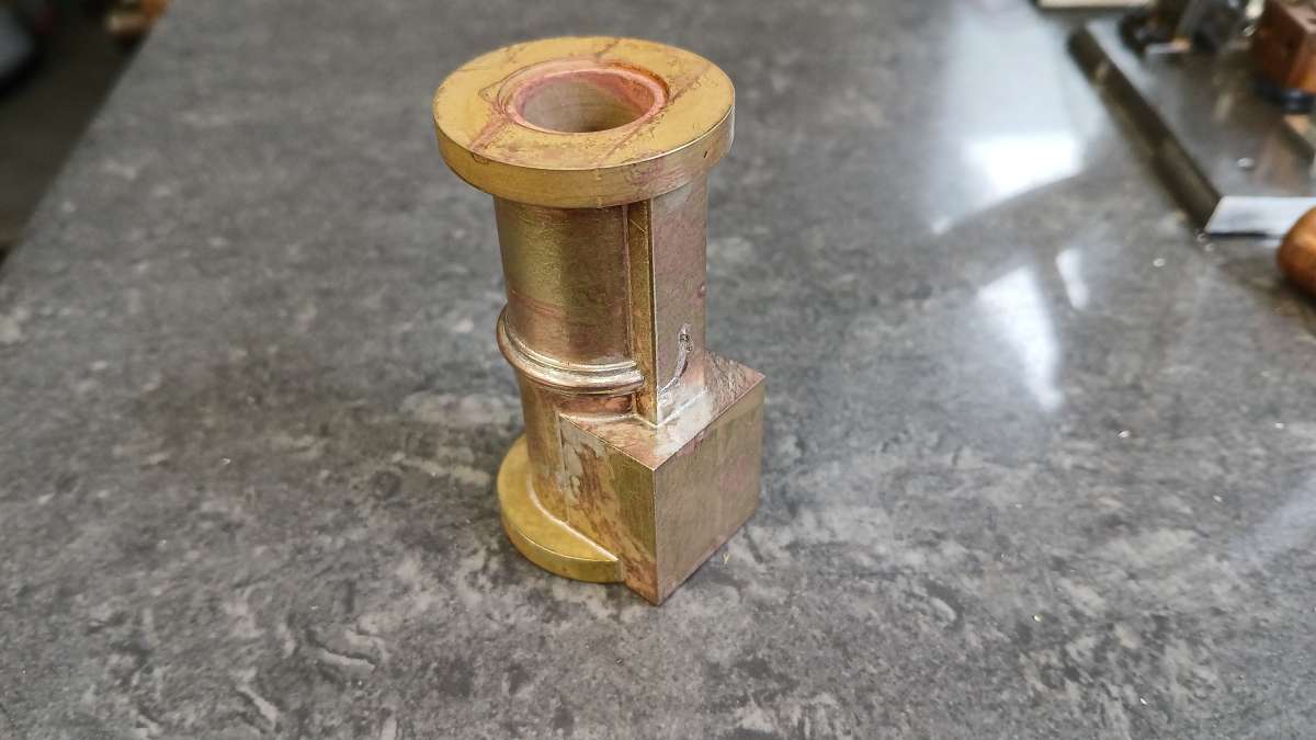

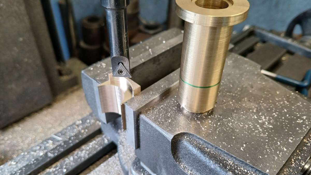

                                If you want to cut a concave surface where you can’t measure as it is not a complete circle then the radius can be set by offsetting the spindle from a flat surface (usually the edge of the work) by the radii you want. Then turn the haed back and forth as you wind on the cut with the dial until the tip of the cutter just kisses the surface.
                                One I did on Saturday
                                20240921_135732
                                Two arcs so it fits the cylinder and flange profiles
                                20240922_082605
                                Blind is not easy, a stepped hole like the two radii I show above is possible with care and the right shaped cutter but you need good control of the downfeed. For through holes you can just use the quill like you were drilling a hole but to stop at a set depth you would need to use the fine feed on teh SX2. Watch the speed as boring heads soon get out of balance so that may limit your cutting speed and on the SX2 1,0mm on radius would be the around the max cutting depth per pass for roughing 0.25mm or less finish pass
