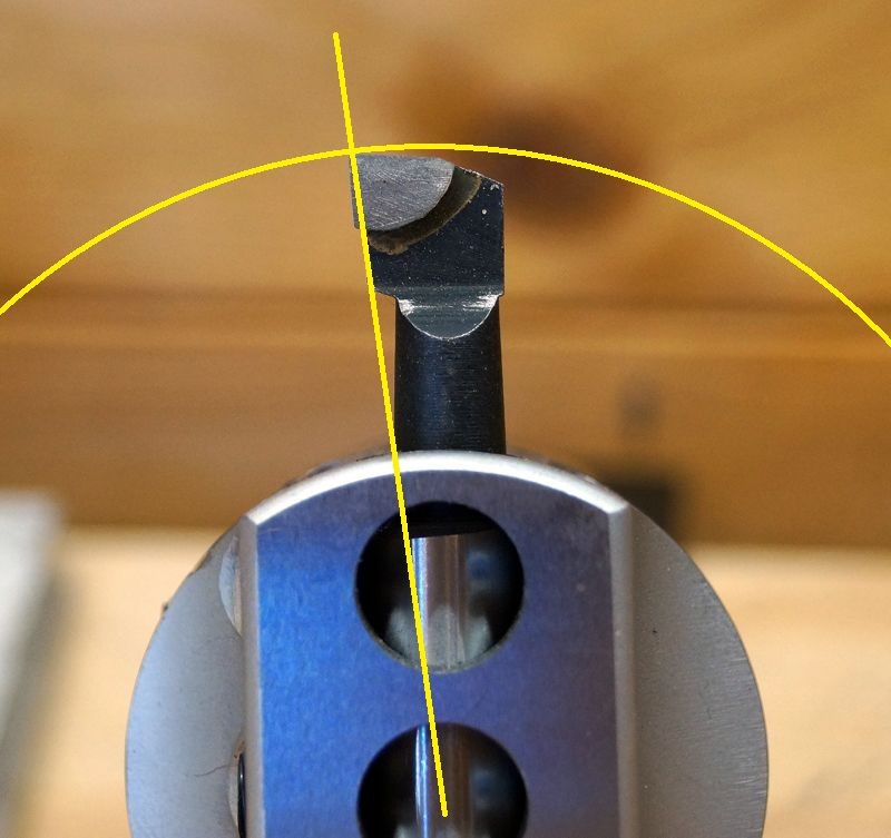

        Posted by Ron Laden on 01/11/2018 13:37:24:
        Posted by JasonB on 01/11/2018 12:19:47:
        looks like it will just clear but not sure what the finish will be like as it is slightly negative rake
        Thanks Jason, as you know I have no means of adjusting that at the moment but I am going to get a green wheel on order
        Ron
        Isn't the rake angle of the vertical edge more important?

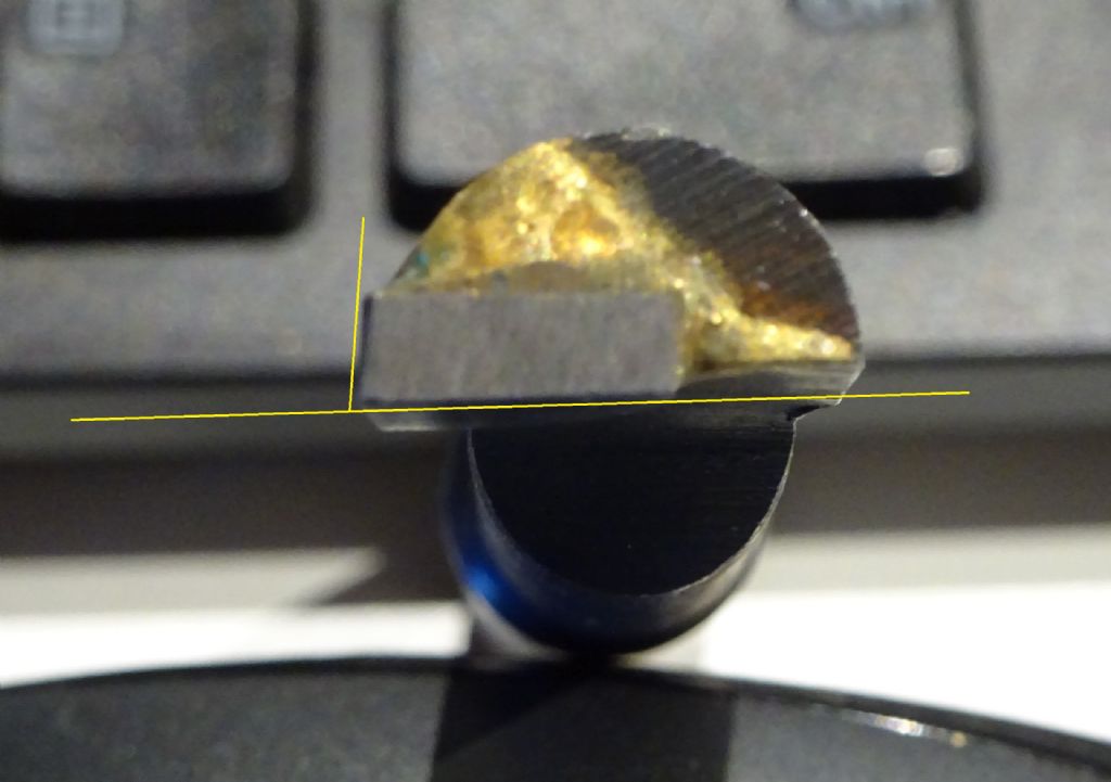

              #378792
                Posted by Neil Wyatt on 01/11/2018 20:48:59:
                Yes as the cut is downwards not outwards but as the unground edges meet at something like 87degrees by the time the flat face has been tilted up to clear the bottom of the cut you are close to or into negative rake. I you take the longer yellow line to be the bottom of the cut, the tool will need rotating anticlockwise so the flat face of the carbide does not rub so then the shorter line will become vertical or past vertical and into negative top take.
                Edited By JasonB on 02/11/2018 12:38:48
                #378799
                Ron Laden
                  @ronladen17547
                  Posted by JasonB on 02/11/2018 12:38:03:
                  Yep I did do that, rotate the tool to so the flat face cleared the cut. I was unable to grind the rake (no green wheel) but fortunately the tool cut nicely.

                    #379112
                    Ron Laden
                      @ronladen17547
                      Got a green wheel on the way so may have a go at reshaping one or two of the boring tools and using them inverted. It seemed to work ok with the 100mm hole I bored and that tool was as supplied, so with a bit of work may be able to get two or three usable tools out of the set for any side mounted boring.
