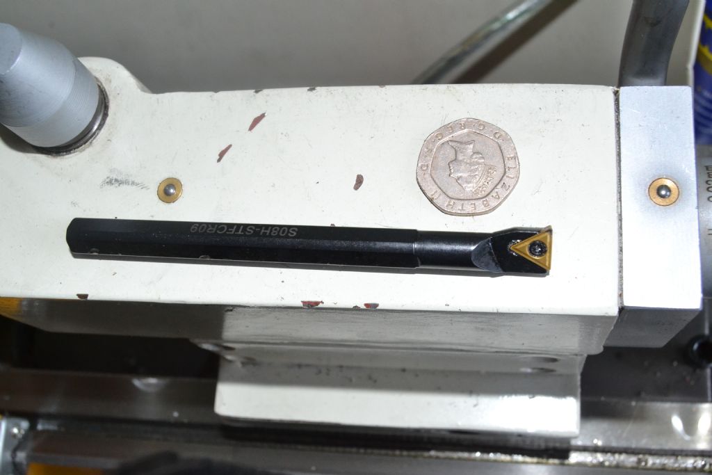

      I'm wondering how best to go about boring a cylinder on a small bench lathe, at the moment I only have this small budget boring bar which I bought to get me started in this hobby.
      It's an 8mm shank and when I bought it I seem to remember the maker stated it was designed for a max depth of 38mm (although I can no longer find that info so could be mistaken). It's been fine for the small jobs I've needed it for but I'm currently making a small horizontal engine that needs a 45mm deep bore and I'm also trying to make a 'beefy' wobbler a bit bigger than the usual 10 -15mm bore just as a bit of fun.
      Presumably the bar I have will be inadequate ?
      Can any one direct me to the sort of bar I might need or how I might go about making a bore of perhaps 60mm long on a 8 x 16 lathe ?.
      To be honest as a beginner the range of bars and the vast difference in price is a bit bewildering and I don't want to be buying something that won't do what I want.
      Many thanks
      Peter.

          If the bore length is going to be 45mm I will hazard a guess that the bore diameter is a bit more than the 8mm shank of your current boring bar.
          So…it will probably be ok for ruffing out, but ideally you want the largest diameter boring bar you can fit down the almost on size bore. Reducing flex and deflection.
          You could knock up a boring bar from a suitable piece of bar and a ground up broken centre drill if so inclined.

                  As a very rough guide it's generally reckoned that a normal boring bar will manage a hole 5 times the dia. of the bar in depth. Just keep making a bar to suit what you need. After a year or so you will have a good assortment

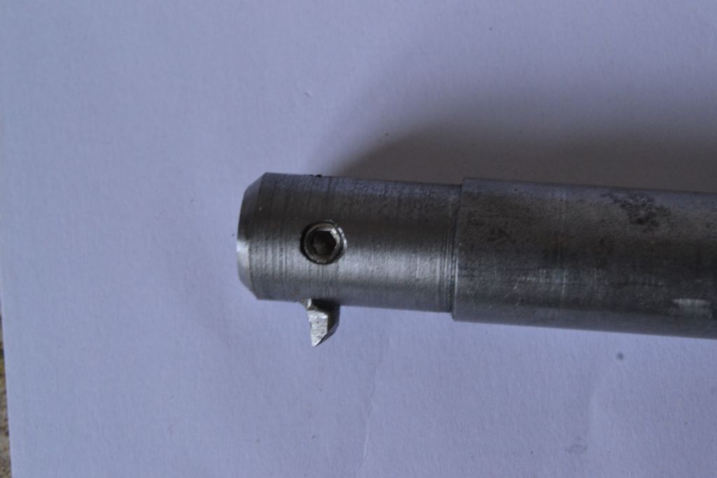

                                    My grinder arrived today so I've managed to knock up a primitive looking boring bar using an old drill bit and some steel rod.
                                    I've never done this before so wasn't sure about the angles etc. I'll see how it works tomorrow at least now I have a grinder I'm in a position to experiment till I can get something that works.
                                    Peter.
                                    Edited By Peter Nichols on 03/09/2015 17:51:38
                                    #203072
                                      Peter, the front edge of the cutting tool is OK but try and make the back a lot closer to the lathes axis, if you look at the lower one in my photo above you will see its almost inline with the bar/axis. This will give a better cut as what you have at the moment is not too far removed from a threading tool.
                                      Something like this wil do a good job
                                      Edited By JasonB on 03/09/2015 18:19:36

                                        Thanks for that, I can see what you mean and will have another go at it tomorrow.
                                        I did a Google search but although I found a lot about general tool grinding I couldn't find out much concerning boring bar angles.
                                        I'm hoping to try and have a go making the cylinder for the Potty mill engine tomorrow.
                                        Peter.
                                        #203077
                                          Angles are similar to an knife tool, but you need to relieve the front of the tool more. I use a curved shape to maximise the support for the cutting edge.

                                            In response to Peter's original post I seem to remember that when I bought a shop made indexable tipped boring bar with an 8mm shank diameter I was advised by the manufacturer to expect to be able to bore about two and a half times the minimum boring diameter deep before I should expect vibration trouble. I expect that the material being bored, the speed and the condition of the lathe would change this. Locking up whatever slides are not being used might help too.
                                            38mm deep could be about right for an 8mm shanked boring bar mounted in a tool post.

                                              Peter,
                                              That holder will certainly do the job yes
                                              You might be disappointed by the tool bit though. The shanks of drills are often quite soft. A broken centre drill or end mill might be a better choice.
                                              HTH

                                                With a drill the helical part is hard, but the plain shank is quite soft. The HSS to use is, taps, centre drills, end mills, or you can buy round HSS. But you'v got the right idea with the bar that you made, make sure that the leading edge is tilted a few deg up to give positive rake. That bar will last for years.
