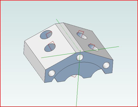

                  You can also use tham for non regular spacings such as a series of radial holes and tangental surfaces. The part below was done with the R?T vertical then rotated for the two angled faces and the four different angles for the holes then laid on its back for the curves all of which radiate from the same centre point
                  Edited By JasonB on 25/06/2013 10:01:46

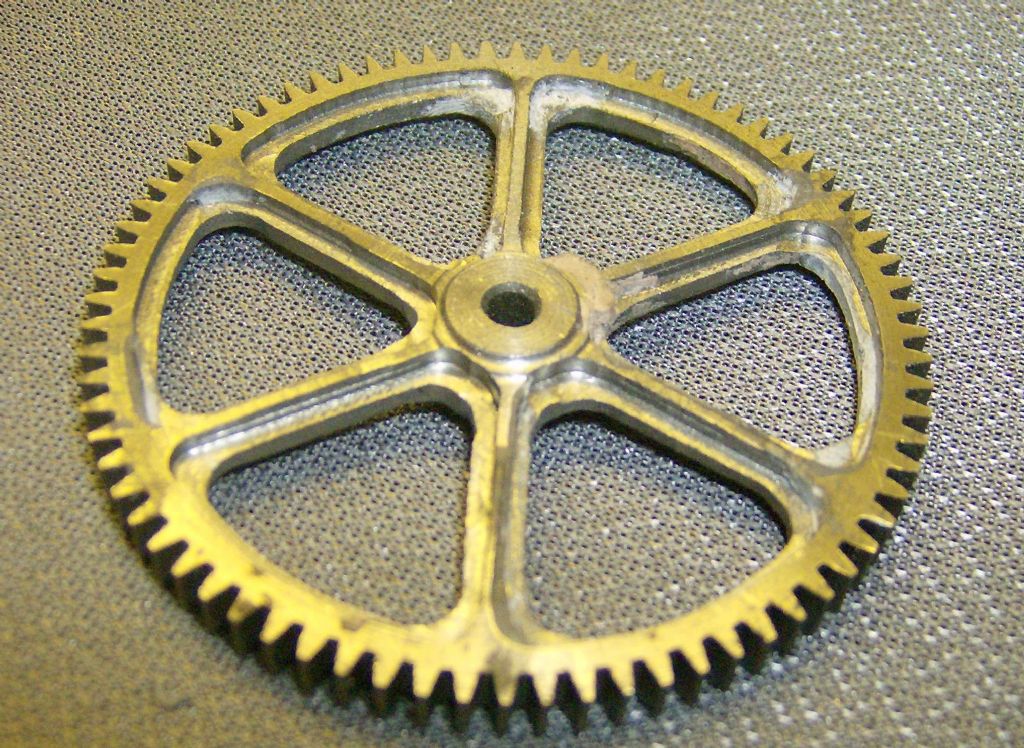

                      I do loads of jobs on my (home made) rotary table as its much more rigid than my (home made) dividing head. The handle is graduated to 1/10 of a degree and I find that accurate enough. Any technique that works with a dividing head can be applied to a rotary table, if you add dividing plates to the handle.
                      Examples of rotary table tasks:
                      Gear cutting-
                      Cuitting large gear
                      Profile milling (also works for cams)
                      Valve face
                      Co-ordinate drilling, milling and shaping-
                      Four wheels ready to go...
                      More milling to shape-
                      Main Gear
