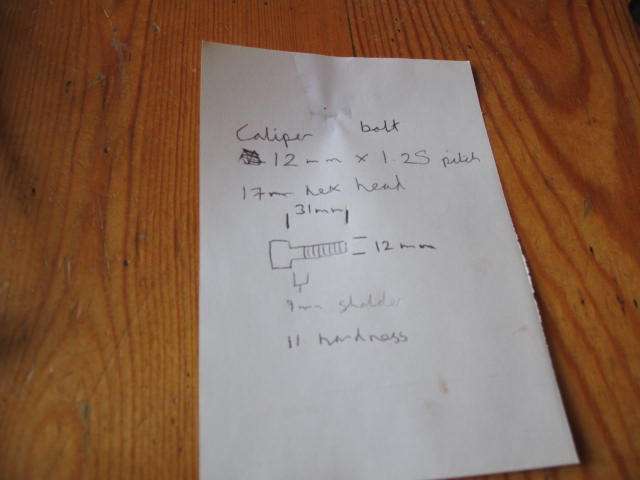

      Whilst overhauling my front breaks on my old hiace van I noticed the caliper bolts were stamped 11 (presumably a hardness rating).  The caliper mounting bolts were difficult to remove even after gallons of wd40 and eezit.  I was handling these bolts with kid gloves having sheared the heads off some m6 undertray bolts.
      This got me wondering does the hardness of the bolts have a relationship to how easily the heads will shear off if rust seized or over torqued?
      Also how does one go about selecting appropriate hardness of bolt even if your chosen replacement bolt is attainable?

                  Thanks guys for the info. I should have mentioned that the offending bolts were 12mm 1.25 pitch 17mm hex head.
                  Here is a pic of the dimensions, there is no flange to the bolt just a large steel washer.IMG_6295
                  If anyone knows of a supplier of said bolts Im all ears. Not looking to pay toyota dealership prices though.

                          To answer the OPs questions:
                          1. Yes, and it’s as simple as you’d expect. Stronger bolts are stronger.
                          2. You can’t unless you know the actual load. Most times you can swap out a bolt for one of a higher grade, but there are cases where that can be bad too. For instance tractor power couplings tend to use 8.8grade bolts as shear pins, swapping that for a 10.9 or 12.9 could cause real damage.
