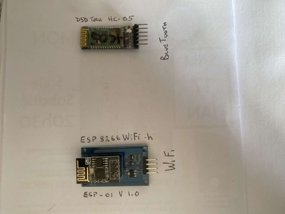

      I muck about with the Arduino micro controllers for various projects for my sins.  I am now using bluetooth and the DSD Tech Bluetooth software for the Iphone so that I can look at the readings remotely. Currently using a DSD Tech HC-05 but disappointed with the range – about 10 mt.
      I also have a WiFi card ESP8266WiFi and Arduino Manager on the iPhone (which is set up for an Arduino R4 with WiFi, not the ESP8266 card).  Arduino Manager seems to be the answer but at first glance seems very complicated.
      The router is in a house with 1mt thick stone walls and dg windows, one of my projects is in the garden about 14mt from the router, although there is a WiFi extender only a couple of mt from the project (Weather station with real time clock, memory card and temperature sensors).
      My question is Which would give me a better range ?

        forgot to add the photo
        WiFi or BlueTooth Large

          Generally speaking you would get longer range with WiFi as many BT devices operate at quite low Tx power (though the maximum permitted is 100mW) being designed for “personal area networks”.  Neither of those modules look like they have very effective antennas, if you could find a WiFi modules that has an actual socket (they do exist) and fit a better antenna it would give better range.  I know of some work that was done evaluating a range of commercial WiFi routers from a number of manufacturers and basically the antennas designed in were c**p.  I doubt that the WiFi antenna in your phone is that good but using a better antenna at one end of the link will help a lot.

            Bluetooth is explicitly designed to be short range.  Low-power and an inefficient onboard antenna reduces the risk of neighbours and family interfering with each other.   Intended to replace headphone and keyboard cables, so normally less than 10m, obstacles permitting. BLE perhaps twice as far – I posted some figures recently in another topic.  Max range about 0.5km if both transmitter and receiver have good antenna in the clear, after that the packets time-out. BT won’t decode packets that take too long in transit.
            WiFi is better – perhaps 100m outside,  but very dependent on the environment.   Not good at penetrating thick stone walls or steel-framed buildings.  WiFi eeceivers and transmitters can be had with coax sockets for an external antenna (beam on a mast), and transmitters powerful enough to wifi a large building or a camp site.
            Short range WiFi devices like ESP microcontrollers normally link to an existing home network, so worth looking at plugging a better antenna into the router and/or adding a WiFi extender.   Position the router for range too:  top floor locations are usually better than cellars!
