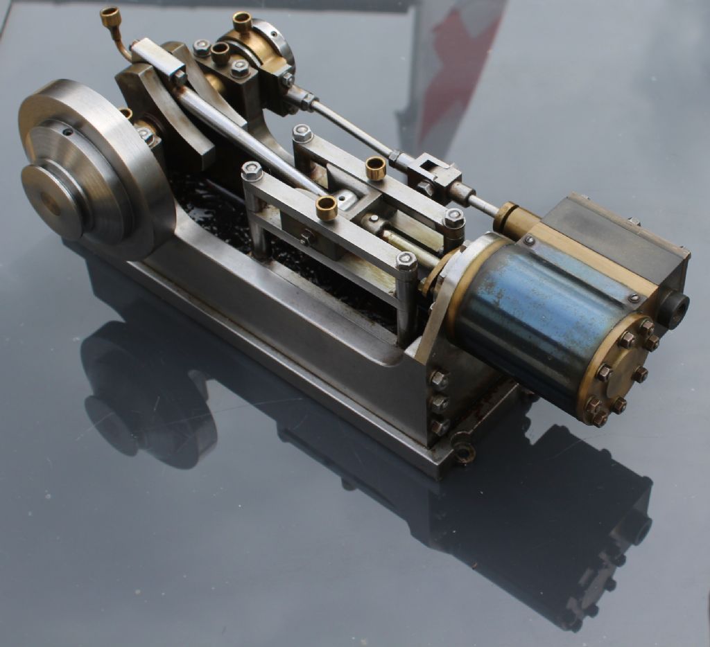

              I had not realized that aluminium sheet was/is being used as cleading. When I was nearing completion of this model I needed cleading around the cylinder. I used thin steel shim coated in oil and heated over a gas flame. I was pleasantly surprised how it "blued" easily.
              35 years on and apart from some slight tarnish I hope you'll agree it has aged gracefully.

                Nice engine Rik,and very nicely blued cleading. I have an S50 mill engine with blued steel cleading which gradually lost its colour with time (too much handling!). I polished off the remains of the blue, and reblued it in the same manner as you. I too was surprised how easy it was to get a satisfactory result.
                Maurice.

                      Mmmm yes a handsome engine Rik
                      Some engines just catch the eye; your own design?
                      I like the flywheel/ drive pulley arrangement, also the bespoke oiler on the big end.
                      The cleading looks good as well

                          Thanks for compliments chaps and apologies for muscling in on Maurices thread. Geoff, not my own design but from plans I purchased which were listed at the time in ME plans handbook #3 of 1978-1979. The drawings are still available here:
                          **LINK**
                          I paid £1.10p for my drawings back then!
                          I thought at the time the model seemed a bit of a titch so I scaled things up and made it twice the drawing size. Mine is just over a foot long and weighs eighteen pounds.
                          It runs OK on compressed air filmed here some years ago in my tiny and now defunct workshop. I have a better camera now wink (and a better workshop) yes
