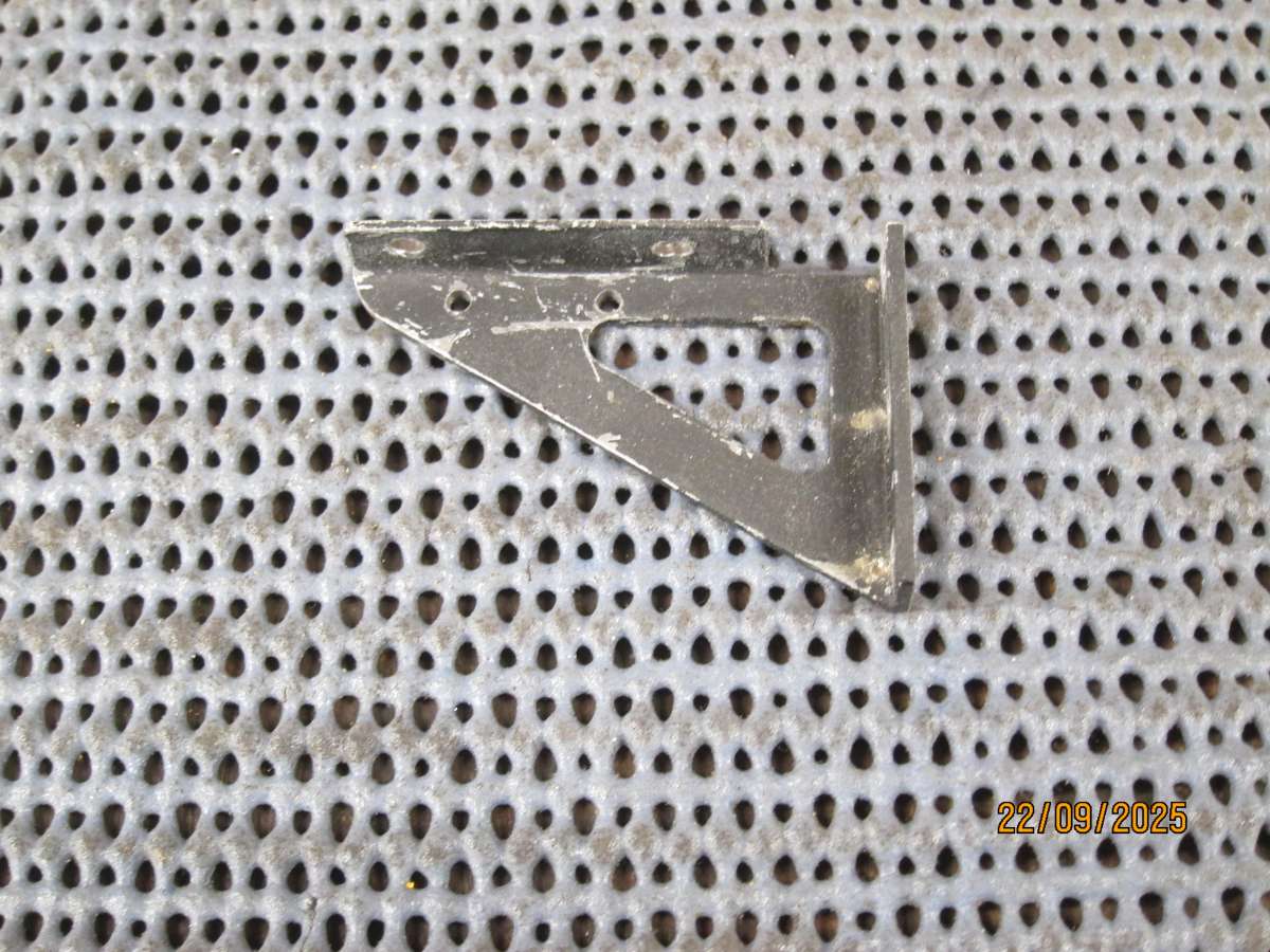

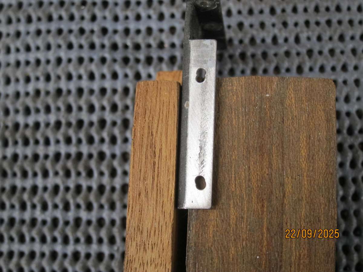

      I am looking for ideas on the best way on how to recover a  loco platform bracket fabricated from bms following a poor (very) effort on my part to re-centre the two of 6BA clearance holes along the top face.  Options are to 1) to remake, 2) drill out the faulty holes and solder a bms plug and re spot or 3) use something like J-B Weld followed by re-spotting.
      Before taking any further decisions I would be very interested to hear how others might proceed.

        I’d bore out oversize and solder in new metal. Preferably plunge cut with a milling cutter in the right positions to open out the holes. That way any new tapped hole won’t be affected by being partway in a joint but right in the middle of the plug.

          I guess it is not structural and by the time it is in use, any feint marks will be covered by paint.  You could drill out, very lightly countersink both sides and peen a plug in place (Brass if you like). Then gently heat and apply soft solder (Just to make sure it won’t turn during drilling) clean up and drill 6Ba clearance.
          If it were structural, start afresh.

              I have Rotabroach mini cutters down to 6mm and they would be my choice for cutting over the holes to plug the plate. They are good where there is a risk of existing holes deflecting the cutter and far stiffer than a small diameter cutter as they are mounted on a Ø13mm shank. They are designed for making holes in sheet metal up to 6mm thick. You could probably make your own shank to mount one on but even the smallest ones are not cheap. It depends on how much time you have invested into this part and the risk of further problems if a drill or milling cutter wanders.

                    Not a fan of JB Weld, Devcon is vastly stronger. But £££ more.
                    For something like that Devcon would do just fine given a bit of “countersink” round the edges to make sure it didn’t go through.
                    In practice, as it’s steel, if I needed a quick fix I’d hit it with the welder. MiG or Stick depending on what I felt like whilst muttering that I really should have got a TiG years ago.
                    Hafta say that after way too many years, and not telling you how many wasted hours, this ancient penguin is finally realising the best way to fix a reasonably simple job gone wrong is to do over. That looks to be a simple bent bracket so definite do over. After making a former to do the ends round and hold i steady whilst the holes are added.

                      Make some big washers and use them to cover up the slots. Unless you need to use the holes for positioning. No one will know!!!

                        Solder or glue some strips to the inside faces, then redrill with a slot drill in the right place. Just an upmarket version of Chris suggestion

                            My thoughts with JBWeld or other epoxy fillers was that due to them being softer than the steel it is quite likely that any drill will want to wander into the softer filler material so you would be back where you started. Possibly plunging with a 3/32″ milling cutter for 6BA clearance would be less likely to wander into the soft stuff.

                                  Drill larger, put in a tight threaded plug with a dab of loctite retainer, re-drill on the correct centre.
                                  Or Silver solder in the plug, then re-drill….

                                      Further to Jasons point about drill wander if using a filler where there is still some overlap between metal and the filled hole.
                                      Realistically it’s best to use an oversize hole so you are only drilling filler.
                                      If overlap is the only way you need a good starter mark and some sort of drill guide.
                                      For the starter mark something better than a pop mark is pretty much essential. For baby stuff I used to like a no 0 centre drill but you have to be very careful of the 1/32″ diameter point. A no 1 is way better but sometimes the 1/8″ point is too big. Nowadays I’ve gone all modern and invested in a couple of spotting drills. Even stiffer than centre drill and much less vulnerable.
                                      Frankly for a job like that I’d not only knock up a bending former but also arrange some form of guide plate for the drill. That sort of narrow flange bend is often not dead flat despite the main shape following the correct bend angle.  The slightly not flat portions are very effective at dragging a small drill off line. Showing it a milling cutter to make the surface flat is always a good idea.

                                        Following the advice provided the problem has now been resolved. The faulty holes were end milled out to 5/32 dia and loosely plugged from the underside with 3/16 dia top hat section brass plugs to give an effective doubling of plate thickness. Plugs silvered soldered into position, new holes spotted through followed by tapping out 6BA. I am very pleased with the end result which was well worth the additional effort. Thanks to all who provided help and assistance.
