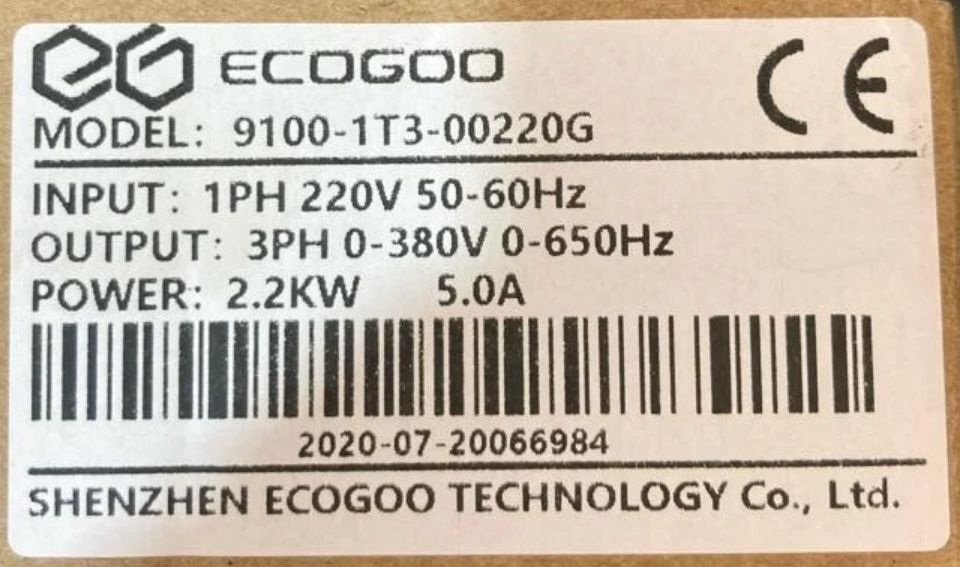

                                  I don't know if you are aware that there are 240 volt single phase input VFD's with 380/440 three phase outputs available.
                                  https://www.aliexpress.com/item/4000976184024.html
                                  HTH.

                                    Hmm. If you read the overview it is slightly ambiguous. Many of these inverters can output 380V 3 ph if supplied from two phases of a 3-ph supply so the input is 380V, but of course with variable frequency. If supplied from 220V they only output 220V. This one doesn't really clearly say that it does give 380V output since one of the several input options is 380V. Over on eBay there are a lot of rather more expensive devices also from China that will only supply 380V with a 380V input.
                                    #514454
                                        Whilst that might be true for some devices it isn't in this case ! Its a straight 230 volts AC input and 380 volts three phase output. Yes there are some 380 volt three phase input 380 volt three phase output ones on there.

                                          • Look further into the VFD's posted by John. From what I understand this would give me a single speed on the current motor but then give me speed control through the vfd?
