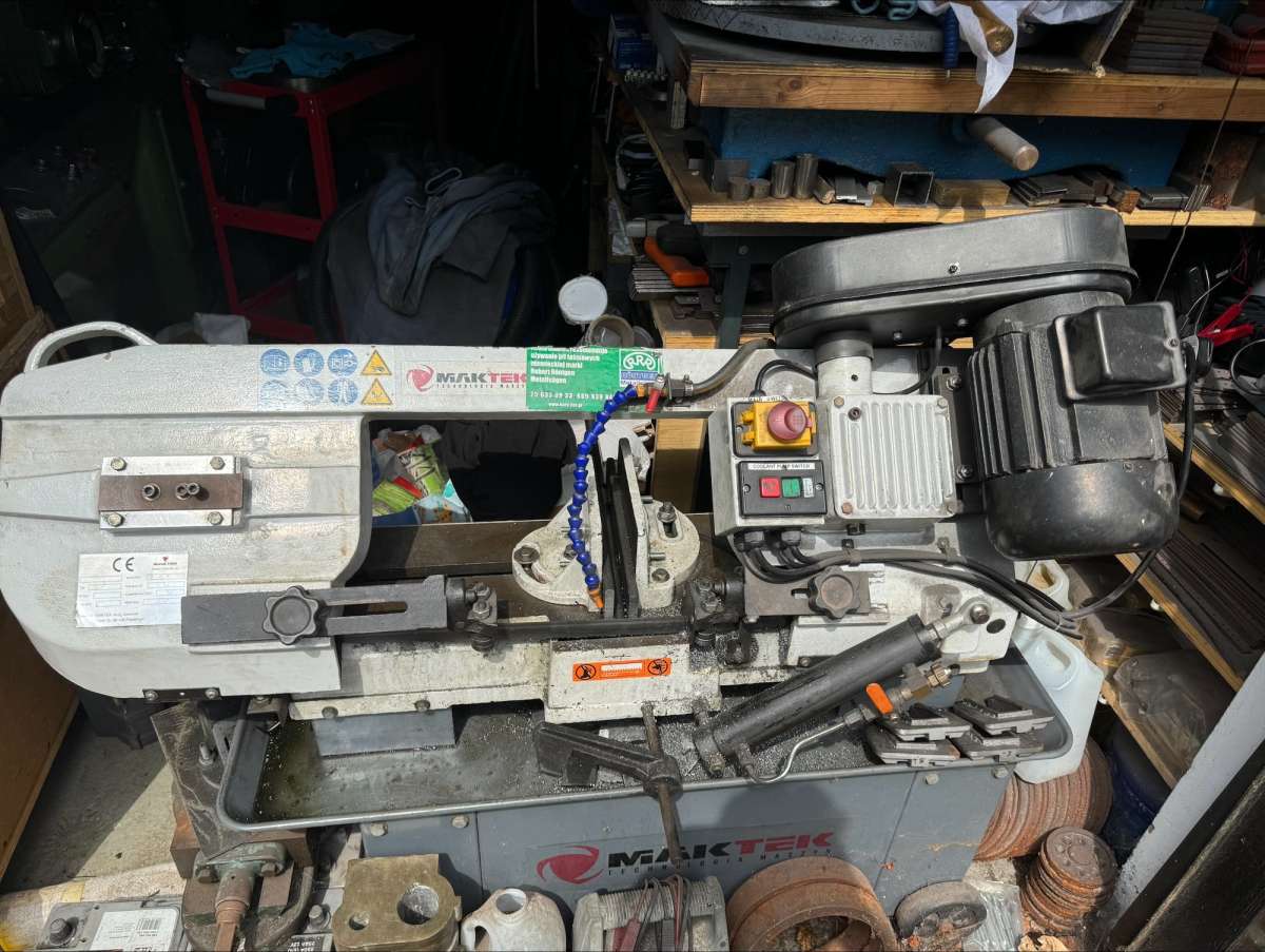

      Dear All,
      I have a horizontal band saw that I have used for nearly 10 years on a rotary converter. This has given me 400v and the saw has worked very well. The rotary converter has now died and I have converted my Bridport to a VFD and again it works really well and I no longer have the horrible noise of the rotary converter.
      My question is do I need to buy another VFD (230-400v) for the saw or can I convert this motor to run on 3-phase 230v as I already have this VFD? Or can I run it on 1-phase 230v, which I doubt?
      Any suggestions will be very useful.
      Thankyou in advance.
      Dave.HBS01HBS02

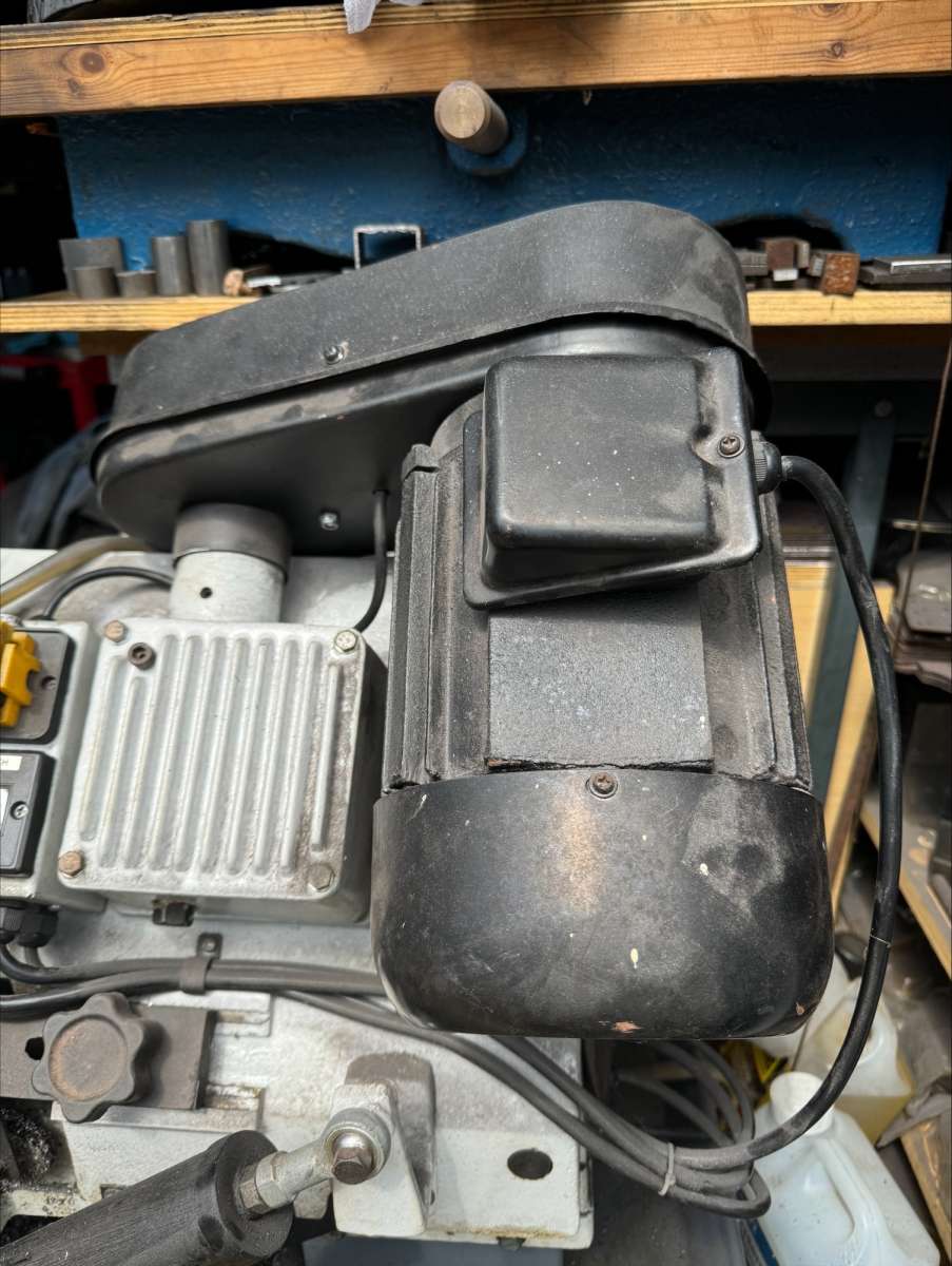

        Take off the connector cover and see how many terminals there are ? If there are 6 then it is easy to reconnect to delta ie 240v. Then use a VFD. If only 3 it may be more difficult to find the star point and separate the 3 tails. Good Luck. Noel.

          I have looked under the connector cover and there are only 3 terminals? Does this mean I am stuck with having to use a 400v output?

            You can certainly run it on a 220V VFD, but single phase is probably not going to work very well.
            For single phase, you would need to connect it in a Steinmetz connection with a capacitor providing an approximation to the third phase. Looking at that saw, the motor looks reasonably powerful so it would be a big capacitor. You’d probably need to step 240V mains up to 400V with a transformer too. So practically, I wouldn’t go down this route.
            If you open up the connection box on the motor, is it dual voltage, ie. are there links which enable it to be reconfigured from star to delta (or mesh). The motor plate may tell you already if it’s dual voltage. If so, reconfigure it to 220V and use a 220V VFD. If not, use a 220V VFD and refer to this article:
            https://inverterdrive.com/howto/240V-Supply-to-a-400V-AC-Motor/
            I’ve been running my Elliott Omnimill like this for years and it works well.
            I see you mention already having the VFD. Personally I’d have a dedicated VFD per machine. Depending on which VFD you have, there can be issues switching at the synthesised 3 phase outputs, and I’d ideally rate the VFD to match the motor (but I haven’t always stuck to this).

                    Looking at the connections there will only be 3 and possibly underneath links. Can you take the electrical cover off and post the photo?
