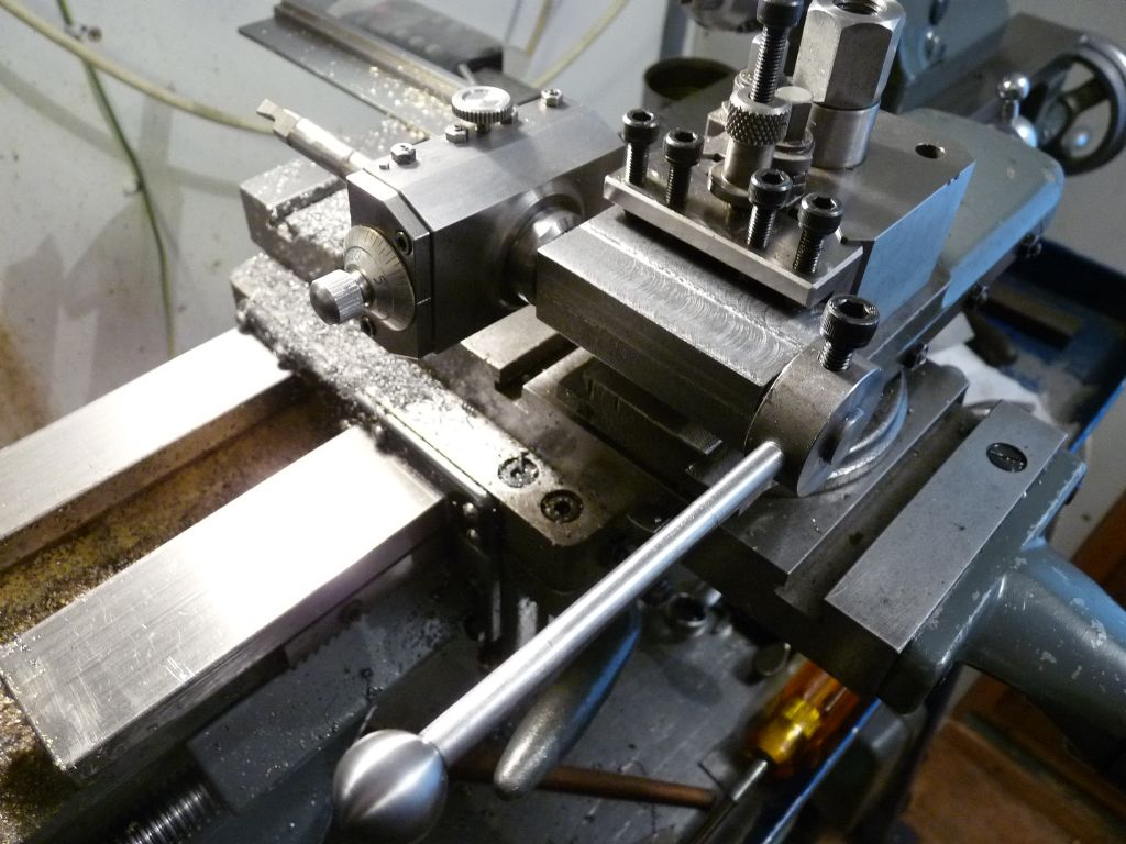

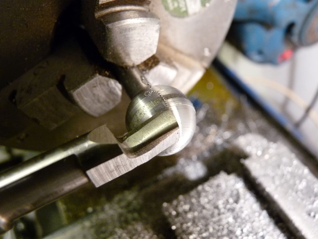

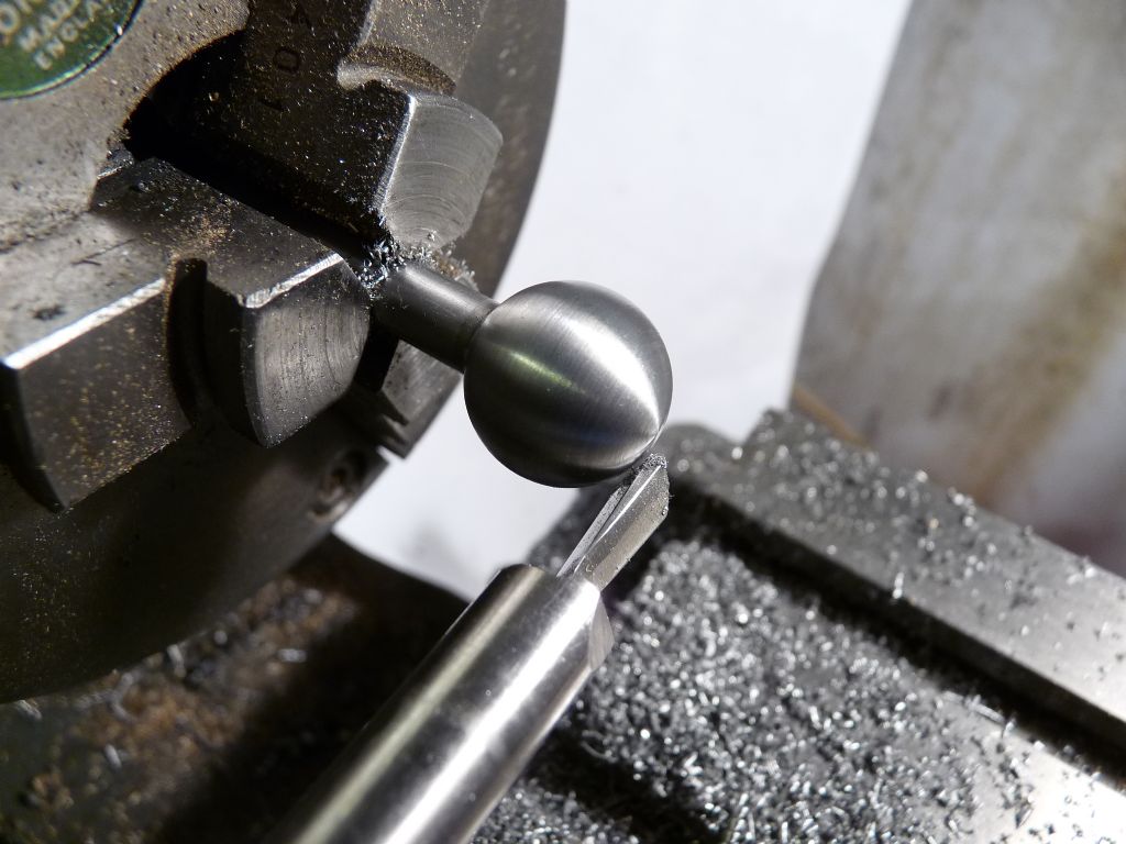

                                    I was making this attachment when the article about using a boring head as a ball-turner was published.
                                    It works very well once you get your head around setting it up and grinding a knife tool on the end of a 3/8 HSS toolbit.
                                    I made the adapter for the George Thomas type boring head made many moons ago.
                                    Setting up is made a lot easier with the QCTH.
                                    Getting the cutting tool geometry is a bit tricky
                                    The finished ball for the handle of the ball-turner attachment! The finish is straight from the tool.
