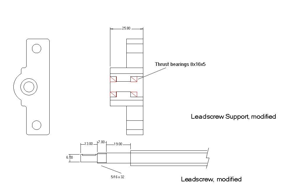

                  I found that even wth the leadscrew nuts adjusted, there was still more backlash than I liked (I don't recall the numbers). This was traced to float at the hand wheels. Adjust out the float, too tight to turn. Easy to turn, too much float. Much improved by boring out the bearing blocks to add needle roller bearings. Smoother as well. There is plenty of metal. If you mess up, the blocks are cheap enough to replace. I could probably come up with a photo or two if interested. SX2P Bearing Block
                  #407094
                  Russell Eberhardt
                    @russelleberhardt48058
                    Like Alan, I added thrust bearings to the support blocks. Here is a DXF file of my working drawing for the modification along with a slight mod to the leadscrew:

                    #407373
                    Alan Vos
                      @alanvos39612
                      Posted by Alan Vos on 29/04/2019 18:36:38:
                      Correction, thrust ball bearings. The thrust needle roller bearing is helping clamp the tool post.

                        #407514
                        Alan Vos
                          @alanvos39612
                          Posted by BOB BLACKSHAW on 02/05/2019 08:47:27:
                          Can you tell me what bearings I need, and where to get them.
                          I used F8-16M (2 per axis) from ARC. (Do ARC keep order history for ever?) Russell's drawing showed the same size and the same general arrangement. Though I did not modify my leadscrew. Diagram 4, part 23 of the SX2.7 looks much the same.
                          IF I recall correctly, the fiddly bit is getting the outside bearing slightly proud so that the handwheel neither binds, nor shows a large gap.

                            #407579
                              her you go as you will need something to open the DXF file that is on dropbox anyway.

                              #407581
                              Russell Eberhardt
                                Hi Bob, I'm not sure if you will need to modify the end of the leadscrew. I was fitting a stepping motor for CNC so possibly needed a bit more length at the end.
                                Yes, the thrust ball bearings came from ARC.
                                FYI a DXF file is one that can be opened by almost any CAD software or just a DXF viewer.
                                Russell
                                #407627
                                Alan Vos
                                  @alanvos39612
                                  One additional note. To avoid binding, you need to align the centre of the bearing block with the centre of the leadscrew nut. When you re-assemble, leave the bearings and two bolts attaching the bearing block slightly loose. Crank the handwheel so that the bearing block is as close to the leadscrew nut as it goes. Tighten the two bolts. Now you can set the bearing pre-load.
