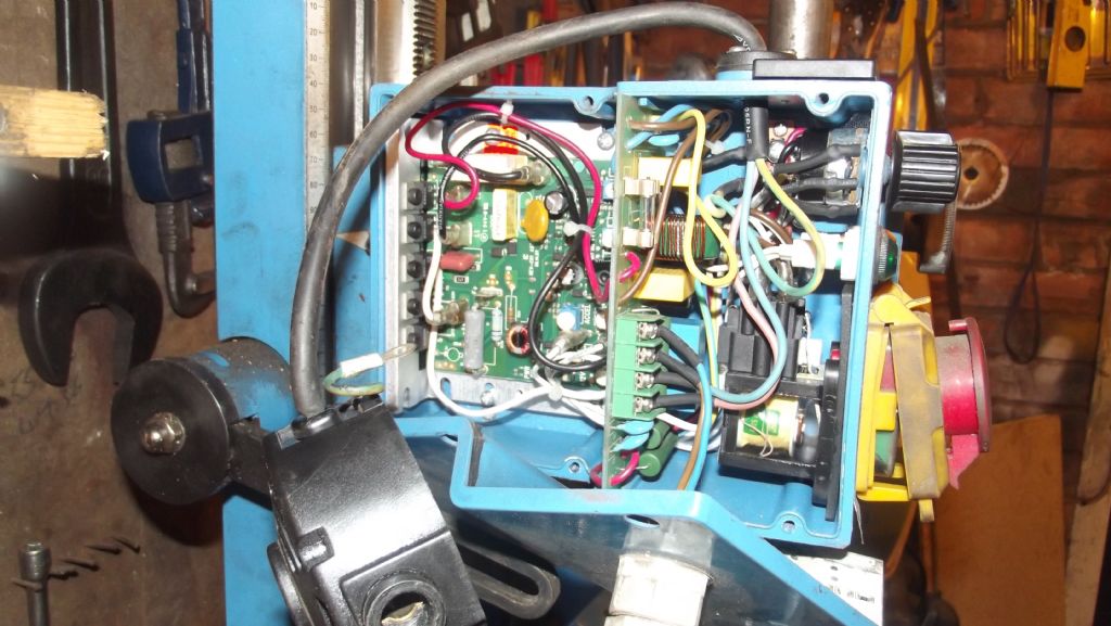

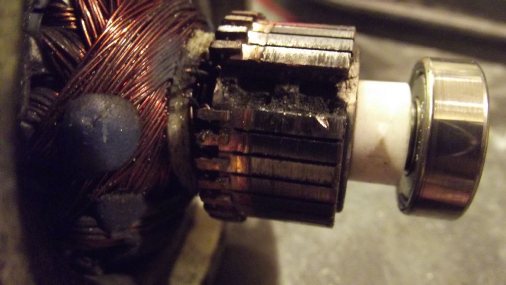

      025.jpgLight load, low speed and crack – see below! Can I buy just the centre part of a motor? Its a derivitive of the Sieg X2, mine came from America but it looks identical(PCB picture also for identification).

        #218587
        John Stevenson 1
          @johnstevenson1
          Not worth pi$$ing about, just get a new motor.
          Arc, Machine Mart, Chester, Warco, all sell them

                #218610
                  File up a couple of new segments from copper or brass, fix them using epoxy putty, skim between centres and reconnect the wires (their tails seem to be there).
                  Or do what I did – replace the motor with a layshaft and a pulley (turned on the mill) and run the lathe using an old motor. Once running make a few stepped pulleys (I made 2 and 3 step ones for six speeds which became twelve with back gear).
                  See the first part of THIS article.

                      #218619
                      Speedy Builder5
                        @speedybuilder5
                        I would ask the question WHY ? Is here a problem with the controller ?
                        BobH
                        #218623
                          Posted by Speedy Builder5 on 31/12/2015 07:32:54:
                          Unlikely, the commutator has partially disintegrated. It may have overheated because of sparking.- heavy wear showing extended use is evident so the brushes would have been worn unless replaced recently. It probably should have been skimmed but that's with the benefit of 20/20 hindsight..
                          I think I'll check mine though.

                            #218643
                            Ian S C
                              @iansc
                              You used to be able to buy new armatures, I bought one for a Black & Dekker drill about 25 years ago, maybe more, but I don't think things work that way now, maybe with some of the more expensive, industrial type machinery. I'd go with JS, heave it and get a new motor. Don't bin it, there's a shaft, a pair of bearings, then bin it.

                                #218753
                                john swift 1
                                  @johnswift1
                                  Hi fizzy
                                  I'd check the speed control board is OK
                                  use an ordinary tungsten filament bulb as a dummy load instead of the motor – "green" led or compact fluorescent bulbs are no good for this
                                  I'm sure I've seen 240V 100W GLS bulbs on sale 2 or 3 weeks ago in one of the pound shops
                                  PS
                                  just checked and poundland have them
                                  http://www.poundland.co.uk/home-and-pet/around-the-home/lighting-and-electrical
