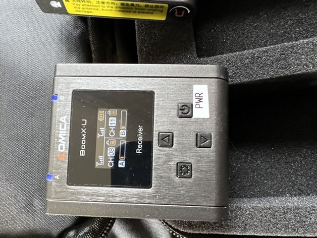

                          What channel numbers do the displays show when they are in operation?

                            #610711
                            Ian Parkin
                              @ianparkin39383
                              Simon

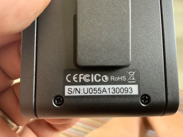

                                Ian Parkin
                                  @ianparkin39383
                                  What does all this mean?
                                  #610721
                                    Posted by Ian Parkin on 22/08/2022 14:08:54:
                                    CE asserts the item meets European standards.
                                    FCC is the US Federal Communications Commission, and an FCC certificate means the item conforms to US emissions requirements. Industry Canada (IC) is like the FCC, and I think they issue certificates too.
                                    Shock horror, the device isn't marked with a UKCA mark! UKCA marks aren't quite as rare as hen's teeth because I've seen one! (Only one. Are Brexiteers happy with that? Two and a half years after finally leaving the EU, we're still using CE marks. Write to your MP!)

                                        Think I'm confused too, if only because channels 8 and 11 aren't UHF, and that is part of the description. They're VHF. There is a licence free VHF frequency allocation (from memory it's 173.8 to 175 MHz which is within Ch7). I've got two separate stand alone lavalier systems on this frequency range you can have if that helps.
                                        I'm wondering if the manufacturer isn't using the standard channel designations, but is using sub-channels within the main frequency allocation. There should be a table of operating frequencies as part of the user manual.
                                        Failing that, I'm coming round to the "send it back to Amazon" school of thought.
