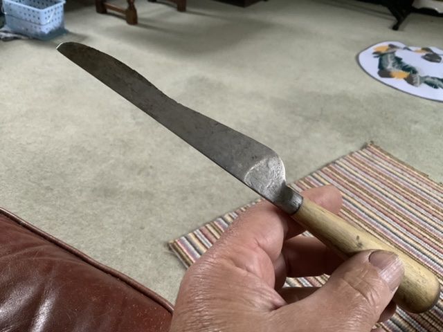

      My mums had this knife for as long as she can remember
      It’s got a simple round wooden handle all together its 10 inches long
      the steel is impossibly thin at the edge……at the handle end its 60 thou at the top
      the end and edge is only 2-3thou but it cuts brilliantly
      can anyone shed any light on its makers..what its made of…etc?

          Blade is likely carbon steel which holds an edge better than Stainless steel but obviously corrodes as for the maker some one in Sheffield?

              Carbon Steel was used in all Chef’s knives pre abt 1990 (I still have such a set of Sabatier knives) – they take an excellent edge (try the old demo of slicing a tomato thrown up in the air) but they corrode and will stain some foods – modern hygiene regs saw them replaced with stainless steel that don’t hold an edge in the same way.

                The usual method of sharpening was to use a stone to grind the cutting edge (Nowadays, we would probably use a few strokes of a diamond hone, )
                From the curve in the carbon steel blade, it has been sharpened many many times, but not uniformly along the length of the blade.
                It might well be about a hundred years old. My granny used knives like that!

                  Ian, Any marks or logo stamps anywhere on it? They can be VERY faint but show up in a raking light.

                    Looks like an old knife, so high carbon steel. I guess it started as a standard kitchen knife and has been resharpened so often that the original shape has been lost and it's thinned down remarkably.
                    Being pedantic about Tony's comment: although carbon steel takes an edge better than stainless, stainless holds an edge better than carbon steel because it's tougher and harder. Whilst Carbon steel can be made wonderfully sharp it needs frequent grinding and stropping to keep it that way. And as Tony says, knives made of it corrode easily and had to be repolished frequently as well. They don't last forever.

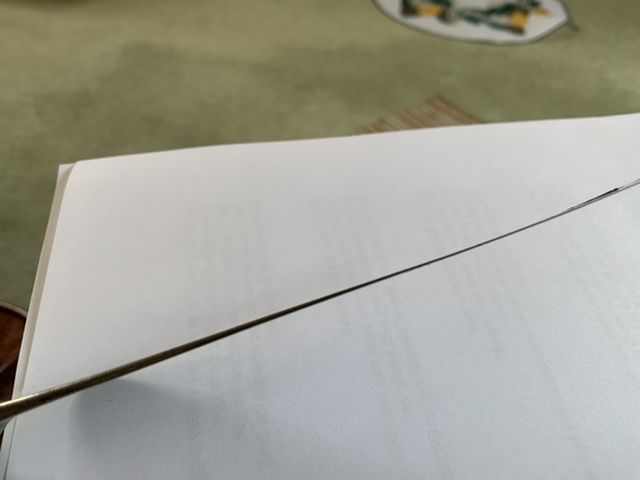

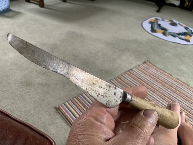

                          Another picture as i said the top near the handle is 60 thou but very quickly thins to less than 10th of and at the edge all along its 2-3thou
                          would it have been made like this?
                          many years ago someone said a knife like this was special as it has a funny area near the handle end visible in the 2nd photo above..something about how it made..
                          its really like a 3 thou length of feeler gauge with a thicker back7b88df64-8009-407e-adf6-5fd3ce6ab775.jpeg

                              The best (+ sharpest) tools were composite with I think the high carbon inner sandwiched between two lower carbon strengthening layers – weren’t Japanese woodworking tools built this way as well as their famous Samurai swords

                                Likely a well used carbon steel carving knife originally supplied as a set of three implements ie. the knife, two pronged fork and a honing steel to keep it sharp.
                                A good quality carving knife is still a delight to use we have one and a honing steel (when the wife comes in I’ll ask her where it is)
                                Many very fine ones originated in Sheffield from the 1900s.

                                  Year of sharpening on the back doorstep will do that

                                      I believe, with a blade so thin, it would be called a ‘Ham Knife’
                                      https://www.houseofknives.uk/blogs/news/what-you-should-know-about-ham-knives

                                                Doesn't a ham knife have the dimples along the blade ??

                                                Clive Brown 1
                                                  @clivebrown1
                                                  The roughened area near the handle in the 2nd. pic. might be where a mild steel tang is forge welded to the thin, high carbon blade. This could make for a better, more malleable tang.
                                                  As for manufacturer, Sheffield was home to a great many self employed cutlery craftsmen, (little meisters) who, perhaps, might have sold some of their output individually rather than through established trade names.

                                                    Carbon steel blades were usually welded to an iron tang, and the remains of that create the puddle look. I believe welding was originally for cheapness because steel was expensive before Bessemer. Carried on later because it was found the combination is less likely to break at the tang.
                                                    Frances mentions sandwiching a high carbon steel core inside a mild-steel envelope. Same reason: knife steel is brittle, prone to crack, and supporting the hard blade inside a tough low-carbon steel makes the whole thing stronger.
                                                    Stainless knives don't need any extra help at the tang – the alloy used for knives is tough and hard without being brittle.
