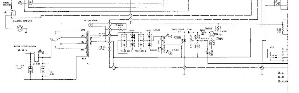

                    Hi Swarf Mostly!, if you have Phono inputs on your amplifier, you should have the Earth post near to where the inputs are. Transcription decks (record player) with a magnetic pickup should have a thin wire with the phono input/output leads, this is done this way to prevent earth loop hum. The common connection from the pickup is totally insulated from the deck's metalwork and the thin wire, earth's the metalwork of the deck directly, rather than taking the long route round via the earth pin plugs, my Pioneer PL-3000 has only a twin mains cable and nothing on the users side has any connection to the thin wire and I've seen this with other decks with magnetic pickups, that I have had in the past. Although my Technics SU-3050 shows no earth connection through the mains plug on the schematic diagram, there is in fact a three core flex connecting it to the mains even though there is an isolating transformer that is the only part that connects to the mains.
                    I think both these where made before double insulation became more of the norm, as both the CD players plugged into the amp only have a twin plug-in mains flex and my double cassette player/recorder also only has a twin core flex connecting it to the mains.
