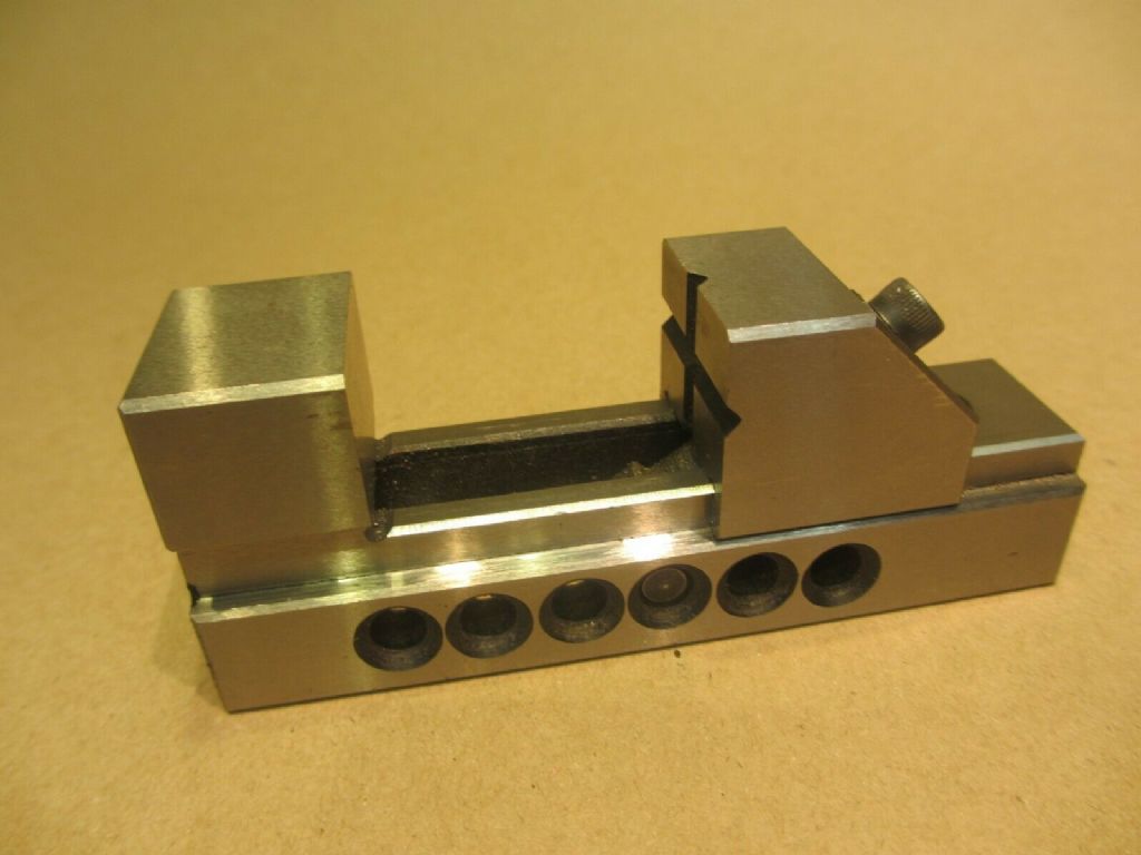

                                      #444647
                                      Chris V
                                        @chrisv
                                        The Mill also came with this vice, how do you fix properly to the table please?
                                        Cheers
                                        Chris.
                                        #444656
                                        Clive Foster
                                          @clivefoster55965
                                          Either with flat bars on suitable parts of the side ledge or via rods in the round holes. Obviously avoiding parts of the ledge that the moving jaw will cover and the hole used by the tapped rod that holds the tightening screw.
                                          Mix and match clamping as appropriate to the job using whatever is to hand or what you can make if you have nothing suitable. I'd use bars and step blocks 'cos I have some that should be suitable. I don't use that sort of vice but if I had to make something I might well do some small blocks with around stub to fit the holes. As ever whatever works for you.
                                          If its a good example of the breed all the sides will be accurately squared up and at right angles to each other. Which can be a gread help when settling into position either by running a dial gauge down the side or by pushing up against a previously set fence.
                                          Clive
                                          PS
                                          Video here showing how blocks with round projections can be used.  Those are general purpose ones, if you make your own you can make them exact to size with a fixed lip opposite the round stub rather than the adjustable plate shown.
                                          https://www.youtube.com/watch?v=7Wuhm8qzkOU
                                          Edited By Clive Foster on 04/01/2020 19:19:02
                                          Edited By Clive Foster on 04/01/2020 19:20:08

                                            #444757
                                            not done it yet
                                              @notdoneityet
                                              Some sizes of that type of vise have been found to contact the mill table at times, when tightening the jaws with the tightening bolt at a steep angle. It is worth checking that there is clearance between bolt and bed to avoid possible surface damage.
                                              #444802
                                              Chris V
                                                @chrisv
                                                Thanks not done it yet, it appears mine has enough clearance, but I would not of thought of checking that?
                                                Cheers
                                                Chris.
