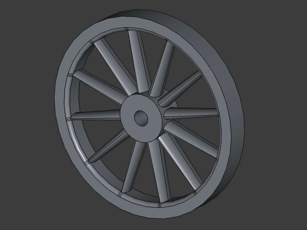

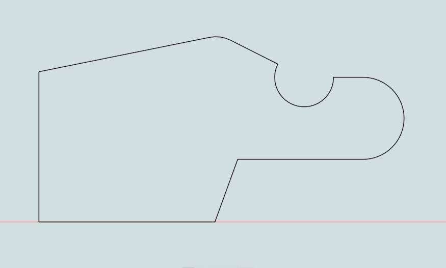

                                    Piece of cake. Two sketches (could have done it with one), one revolve for hub and rim, one extrude (with draft) for a spoke, one circular pattern for the set of spokes and joining all the bits into one, and (and this surprised me a bit) just one fillet operation to do them all.
                                    Flywheel fillets

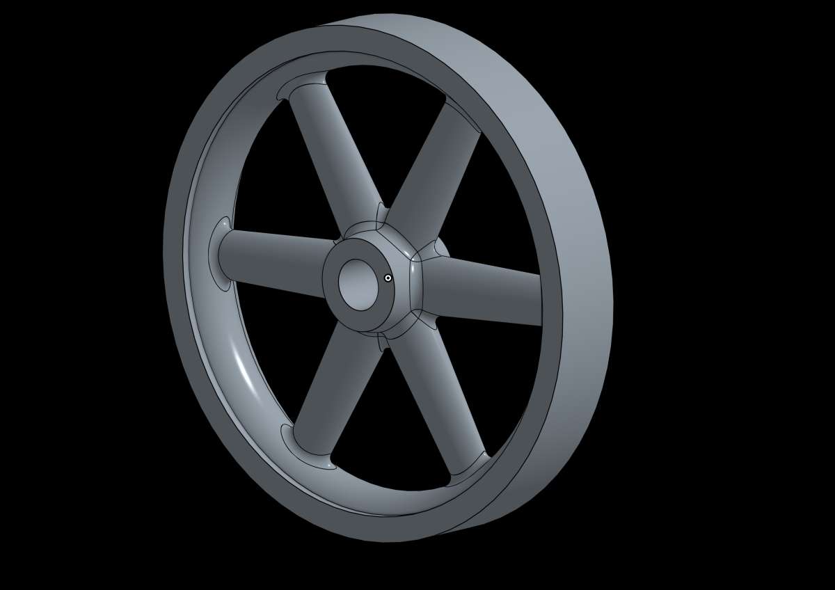

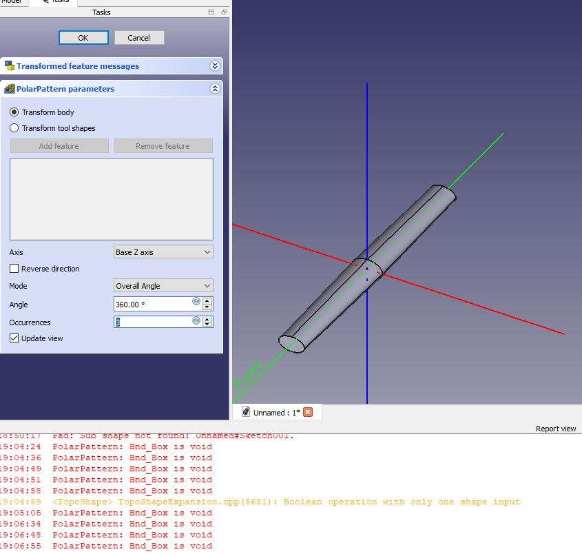

                                            Not for me. I can quite happily get it to form a pattern of six spokes when they are simple circular section with no taper. Even does it with elliptical spokes with no taper
                                            But as I’m a bit of an advanced motorist I like elliptical section spokes with some taper. If I use EXACTLY the same methods as for the plain round spokes Freecad falls flat on its face after a few spokes. As I said it happily formed the default pattern of 2 that comes up then clicking the up arrow I can get 3, 4 and 5 spokes but then it fails to do six. Tried another combination of ellipse profile and taper and that could only manage 3 spokes before the error messages came up. Omit the taper and it manages to do six spokes.
                                            If you want to try it the base of the spoke at the ctr of the flywheel is 7mm x 4.6mm, extruded 30mm and has -3 deg taper. Though with this size spoke it can only manage a pattern of 2 and can’t manage the -3deg either so had to try with less taper!
                                            Plain round
                                            spoke 1
                                            Elliptical
                                            spoke 2
                                            Attempts at tapered ellipse with all the failures
                                            spoke 3

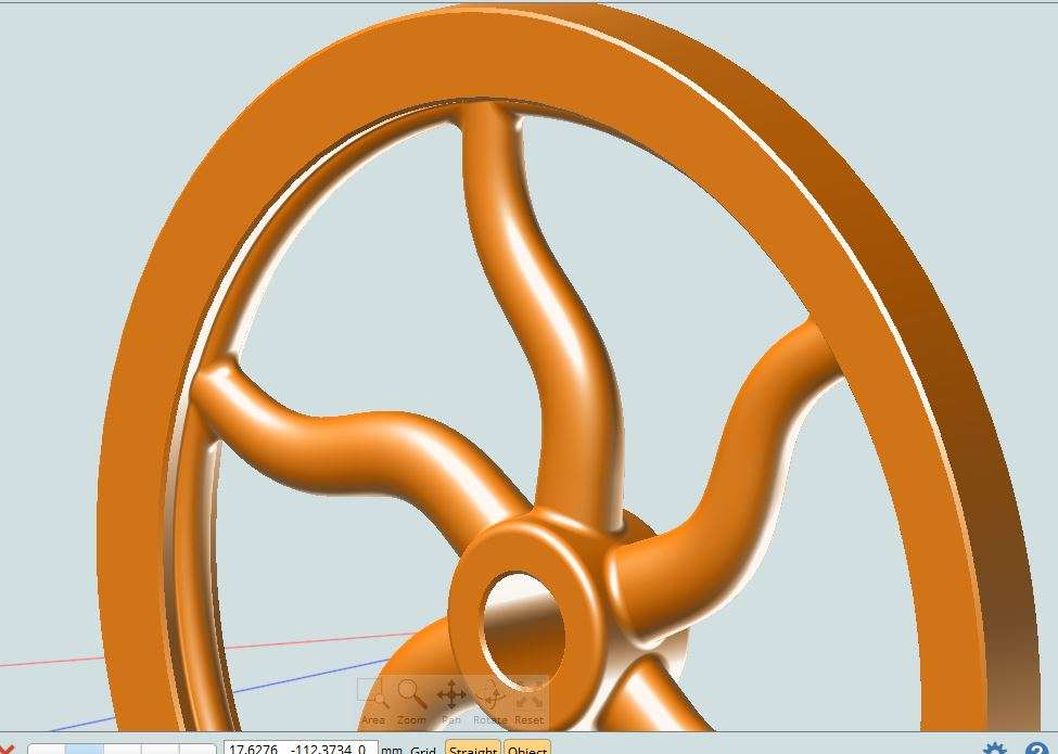

                                              I managet to get MoI to construct a flywheel with six curvy elliptical spokes, complete with fillets and blends.
                                              Capture
                                              I wouldn’t know where to start with that in FreeCAD yet, although I will persevere. It’s the number of error messages and convoluted procedures that just seem to constantly get in the way of getting something drawn.

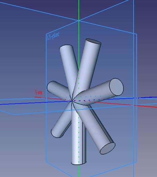

                                                It seems FreeCAD has a problem with polar pattern if the “spokes” are tapered and there are more than so any. I have raised this as an issue and they are working on it. Hopefully it will be fixed in 1.1 which is not too far off.
                                                #835044
                                                  Thanks for that Roger, good to know I’m not a learner driver but maybe Dave has not traveled far himself just sticking to simple journeys.

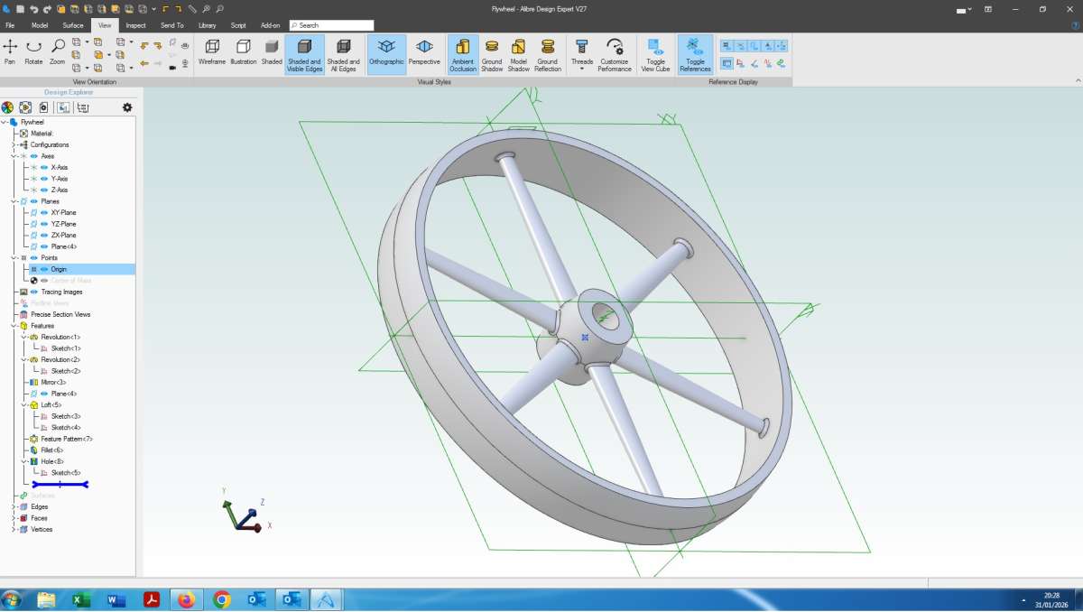

                                                  Roger Woollett
                                                    @rogerwoollett53105
                                                    It can be done.
                                                    The trick is to
                                                    Create the hub (xy plane)
                                                    Create a spoke (yz plane)
                                                    Shift the spoke sketch attachment position along the z axis
                                                    Polar pattern the spoke
                                                    Draw the rim (xy plane)
                                                    Flywheel
