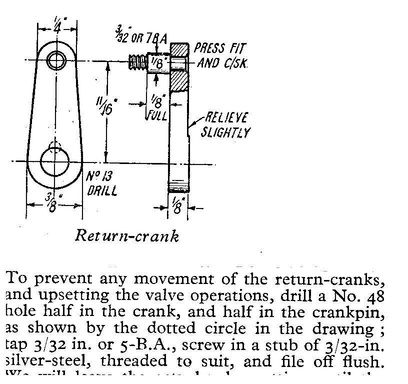

                Many thanks for all of your replies … I think that I have found the solution to my problem after watching an excellent YouTube video about setting Walschaerts valve settings.
                It seems that the return crank on one side of my loco had rotated out of position slightly. I have now adjusted the crank and all looks to be good
                Not sure why that had happened ( the plans did not show any permanent locking system ) so I need to keep an eye on this!
                Mike
                #536870
                Nick Clarke 3
                  @nickclarke3
                  Drawing and extract from magazine:-
