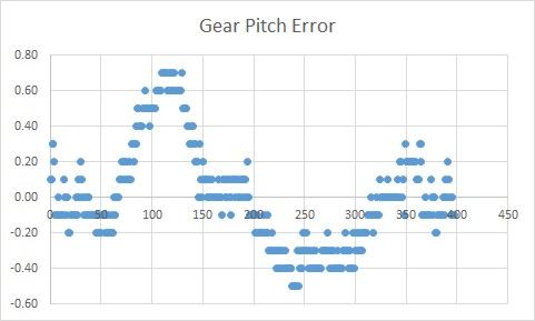

        > Practically this means that you could mark out the first plate by almost any means and the second plate would be pretty good. ..
        The accuracy of the second plate would be largely limited by the accuracy of the gears. The maximum error would be:
        max error in worm + max error in gear + (max error in plate/number of teeth in gear)
        After one cycle of making plates, the error in the gear is likely to be the largest of these. The worm would have to be very poor to have a large error as you are always using the same short section of the thread, but a gear can have a significant maximum angular error between two teeth without it being very noticeable. The chart below shows errors in a hobbed gear I made –  a maximum of 1.1 degrees error!
        This was made by indexing the gear around while attached to a digital level, my (rash?) assumption is that the level is more accurate than the gear.
        Edited By Neil Wyatt on 17/03/2015 09:17:32

          Posted by Neil Wyatt on 17/03/2015 09:07:36:
          … shows errors in a hobbed gear I made – a maximum of 1.1 degrees error!
          A very rash assumption, I would say, Neil
          [unless, of course, you have an extraordinarily precise digital level]
                  Well the Wixey website says:
                  Resolution: 0.1 degrees
                  Accuracy: +/- 0.2 degrees
                  Repeatability : +/- 0.1 degrees
                  I'm happy to accept that mine is equally accurate. I can vouch for the repeatability and +/- 0.2 degrees is better than +/1 0.6 degrees.

                        Posted by Neil Wyatt on 17/03/2015 17:32:51:
                        Neil,
                        I can see no reason why a hobbed gear should be that bad. The hobbing process should automatically even-out most errors.
                        Did you re-mount the gear, between cutting it and measuring it ?
                        … If so, then I suspect that some of your recorded errors might be from eccentricity in the mounting [it's surprising how much angular error can be produced by a few thou' offset].

                            #183630
                              I can – I should have pointed out that it was free hobbed.
                              The first one had an extra tooth, despite being gashed.
                              I think the cause was insufficiently deep gashing.
