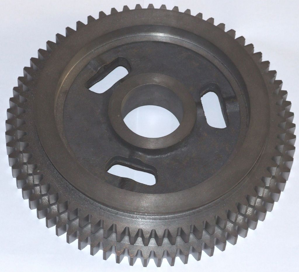

                                            #72744
                                            Anonymous
                                              Just to round off part of the thread I have now started cutting the gears using my new division plate. Two sets, each with one gear with 63 teeth and one with 69 teeth.
                                              Here’s the division plate in position:
                                              The larger of the two gears being cut:
                                              And finally the two gears, together with the part machined differential centre:
                                              For reference the larger gear is a shade under 12″ in diameter.
                                              The more observant will note the green clamp in the picture of the gear cutting in progress. This is to stop the gear rotating during cutting. First time round I optimistically assumed that the dividing head spindle lock and tailstock would be sufficient, given that the cutting forces, in theory, are along the x axis. Sadly my optimism was misplaced, and on the 60th or so tooth the gear slipped by about 20 thou on the periphery. I’ve been round and recut the gear, and I’m sure that in practice it would work, but I’m not happy with it, so I’ve ordered a new casting. An expensive lesson learnt.
                                              Regards,
                                              Andrew
