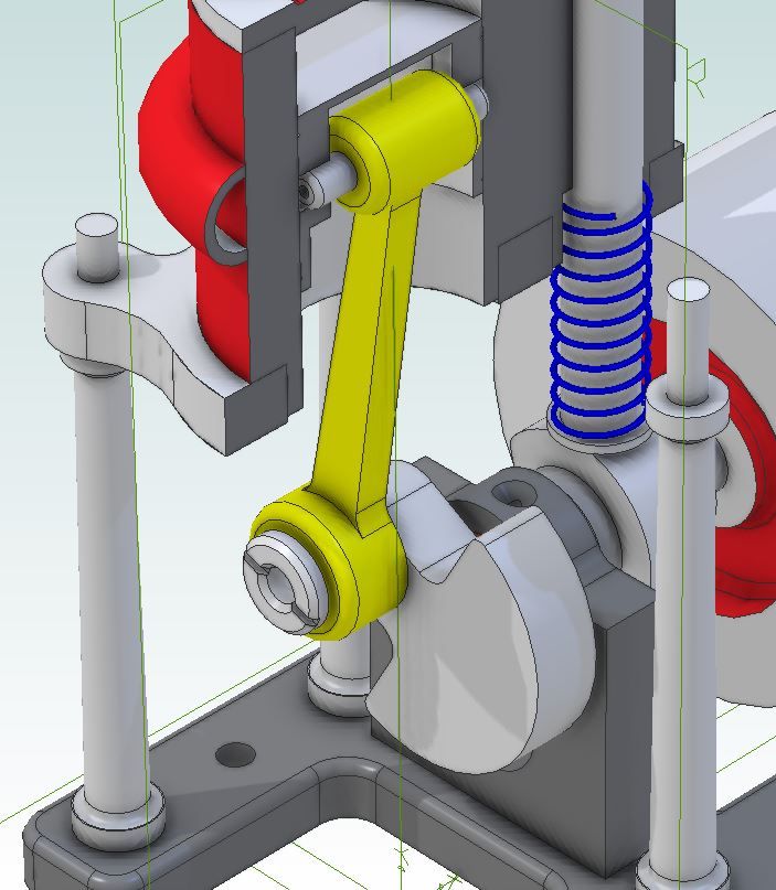

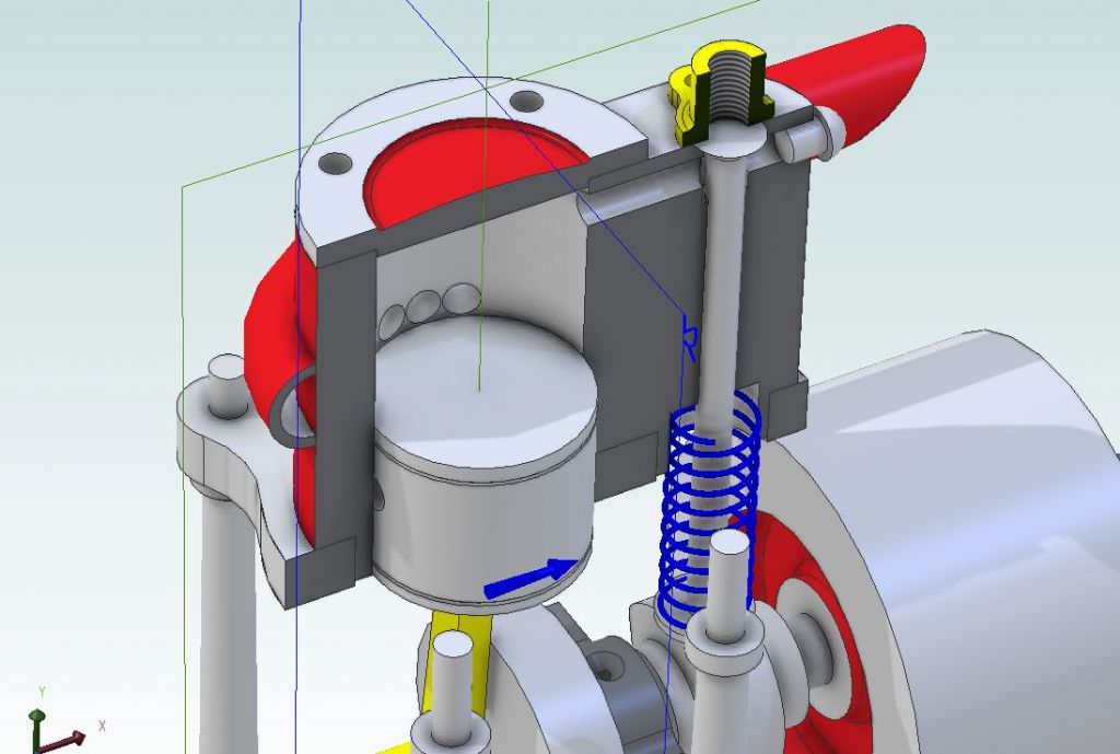

                  #574179
                    A little more temptation, this would roughly be the poppet valve version which does not need much changing. Not shown is the cam that would need altering to work the other way as the valve now lifts to open the inlet rather than lifting to close.

                      #574205
                        I've kept this one quite close to the original sizes by working with the conversion of 1/16" on the original equals 1.5mm which works out well in most cases giving whole millimetre numbers or #.5mm if a 32nd . This means that the original 3/4" bore comes out at 18mm ( 12sixteenths x 1.5mm).
                        The Uniflow design has the inlet at the top of the cylinder and the exhaust so it is just fully uncovered when the piston reaches BDC meaning the air/steam flows in one direction. So as the valve opens around TDC the piston is pushed down, valve should close just as the exhaust ports start to get uncovered which then lets any still expanding steam out of the cylinder. On the up stroke it is only the momentum stored in the flywheel that moves the piston and that also has to compress any remaining air/steam as the exhaust and valve are closed, probably works better on steam as you will get a little condensing of what was left in the cylinder so less force needed to bring the piston back to TDC.
                        The exhaust could just as easily be two separate stubs sticking out each side of a single at the front provided it did not reduce the area, I have seen images of it with just the bare holes. Really just comes down to how you want it to look and where you want any oily exhaust to go. This was quite likely to find it's way into a boat so out the back seems like a good idea.

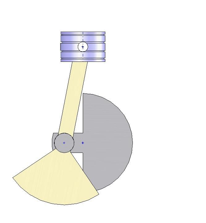

                          Niels Abildgaard
                            @nielsabildgaard33719
                            A little engineering can make it much sweeter running.
                            Make piston and pin as low-mass as You dare.
                            Put a mass on the conrod opposite piston so that piston -pin and conrod balances on the crank hole.
                            Put countermass on crankshaft so that the hole mowing cirkus has center of mass on crank centerline.
                            It sounds complicated but is about half an hour on a CAD system.
                            The engine will be much,much nicer running fast.
                            If there is interest I will make some picture.
                            Offer me a bore (mm please) ,stroke and conrod inter hole distance and I go ballistic.

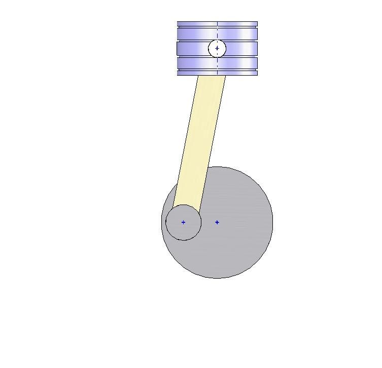

                                    #574274
                                    Niels Abildgaard
                                      First picture is the original parts as described by Jason
                                      #574275
                                      Niels Abildgaard
                                        Next picture is balance improved by Niels
                                        #574276
                                        Niels Abildgaard
                                          The conrod has got an extension so that center of mass for piston parts and conrod is at the crank hole?
                                          The crankshaft is then modified so that all moving parts are mass centered on centerline.
                                          Edited By Niels Abildgaard on 04/12/2021 19:43:13

                                            Nice idea Nils, but what I think you've done is swapped liner vibration for rotational. The conrod/weight assembly is being accelerated/decelerated in a rotary motion, and the only force which can supply this is side force at the piston, reacted by another force at the crankshaft, so the engine assembly sees a twisting vibration. Whether this is better or worse than just balancing half the reciprocating and all the rotating mass would be an interesting experiment.
                                            The only way to fully balance a single cylinder engine is to have 2 counter-rotating weights (used in many modern motorcycles) or to have a second throw to the crank which wags a dead weight up and down (think boxer engine, but only one active cylinder). I read that Triumph (the old one, pre bankruptcy) actually drew something up on these lines
                                            #574371
                                            Niels Abildgaard
                                              Posted by duncan webster on 05/12/2021 18:47:04:
                                              It is my feeling that trading forces for torques is a good deal,but as you say an experiment will be nice.Then afterward everybody can join with What did I say and that is nice in this troubled times.
