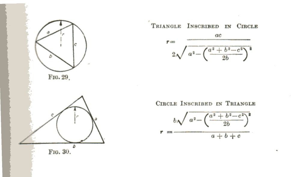

        #116907
          Mark,
          Not stupid at all.
          Try this
          or this
          Edited By Michael Gilligan on 15/04/2013 08:14:38

                                    #116968
                                      Bob,
                                      Fair comments! and I'm with you 100% regarding the state of modern "Education"
                                      There was a reason for my pointing Mark in the direction of the co-ordinate geometry method … Because it is the way that the CAD programs [as mentioned by Paul Lousick] do it.
                                      Many people are fascinated by CAD's ability to draw a circle through any three points, and I thought it worth showing how it's done.

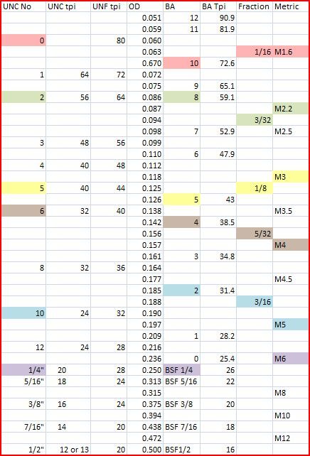

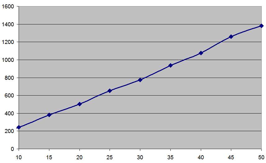

                                      P.S.  Here is a very handy little chart
                                      Edited By Michael Gilligan on 15/04/2013 18:20:11

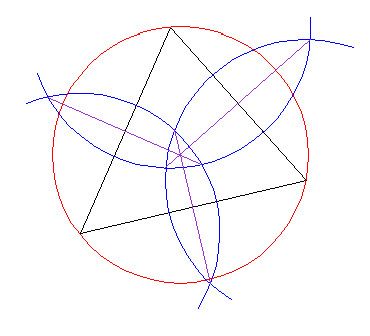

                                        If you can mark the hole centre positions on a piece of paper held against the metal, the PCD centre is simply the intersection of the perpendicular bisectors of the lines connecting the centres.
                                        The lines connecting the hole centres are chords of the PCD circle. The bisectors of these lines must pass through the PCD centre. This is trivial geometry.
                                        The diagram shows that it works even for non-equilateral triangles.

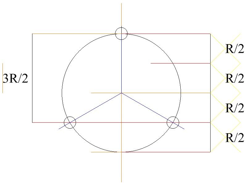

                                            #116980
                                            MICHAEL WILLIAMS
                                              @michaelwilliams41215
                                              Try using maths instead of just using it :
                                              Conceptually measure the orthogonal distance between any one hole centre and an imaginary line going through the other two . Relationship between this distance and PCD can be established by simple inspection of the geometry .
                                              Measured distance = 1.5 R
                                              or
                                              PCD = 4/3 times measured distance .
                                              Very easy to actually do in practice :
                                              Put a pin in each hole , sit two pins on vernier jaw , measure distance over third pin then deduct one pin diameter .
                                              Use a true bar to span the two base holes if a long distance apart and deduct thickness of this as well .
                                              Michael Williams .
