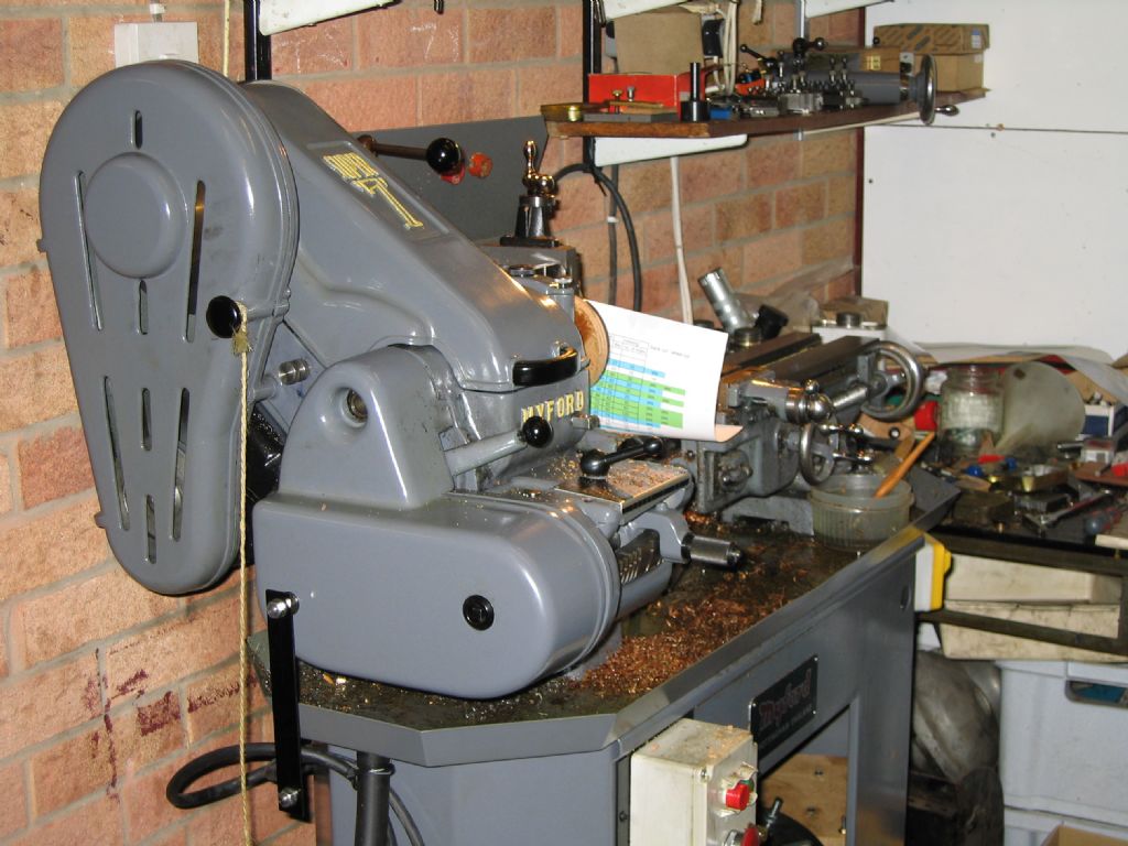

      I’m Jim, and I’ve recently embarked on the exciting journey of lathe ownership with a 1950 Myford/Drummond Type M. It’s a charming piece of history that seems to have undergone some restoration not too long ago. As with any vintage machinery, I like to give it a thorough once-over to ensure everything’s in tip-top shape. I fully appreciate that this lathe has been around for 75 years, so I’m not expecting perfection—but it’s all part of the adventure! 😄
      First Observation: Headstock Endfloat
      The initial thing I noticed was a significant amount of endfloat on the headstock shaft. To address this, I adjusted the collar at the rear and the two bushes at either end. Now, I’m curious: what’s the best method to ensure that the headstock and chuck are running true?
      Second Concern: Saddle and Cross-Slide Play
      Moving on, I’ve observed that the saddle and cross-slide have a fair bit of play, which causes the tool to shift upon contact. I managed to eliminate the play in the saddle by adjusting the grub screws. However, I can’t seem to locate similar screws on the cross-slide. So, my next question is: what’s the most effective way to address the play in the cross-slide?
      Final Query: Overall Alignment
      Lastly, I want to ensure that everything is running true—specifically, the headstock and saddle. What are the recommended practices to verify and achieve proper alignment?
      Thanks so much for your guidance!
      Jim

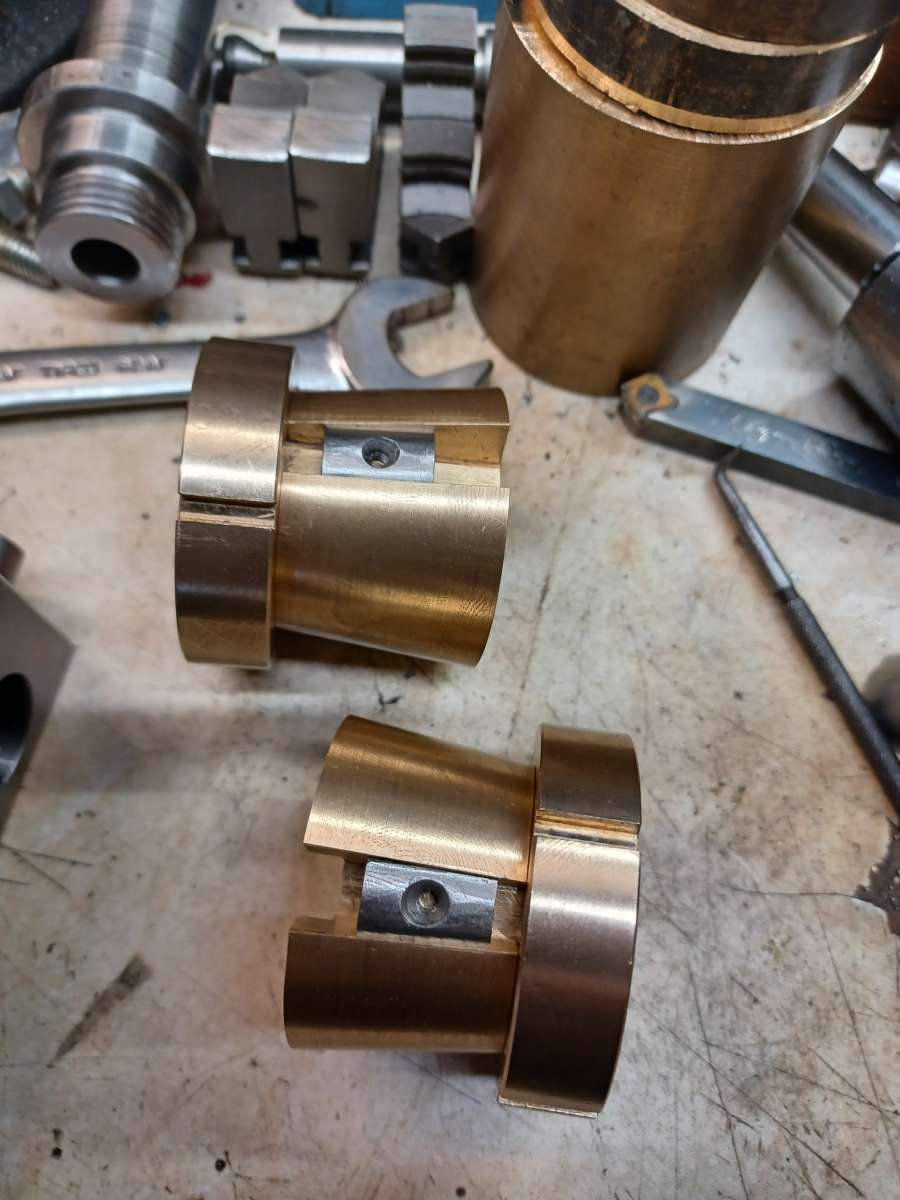

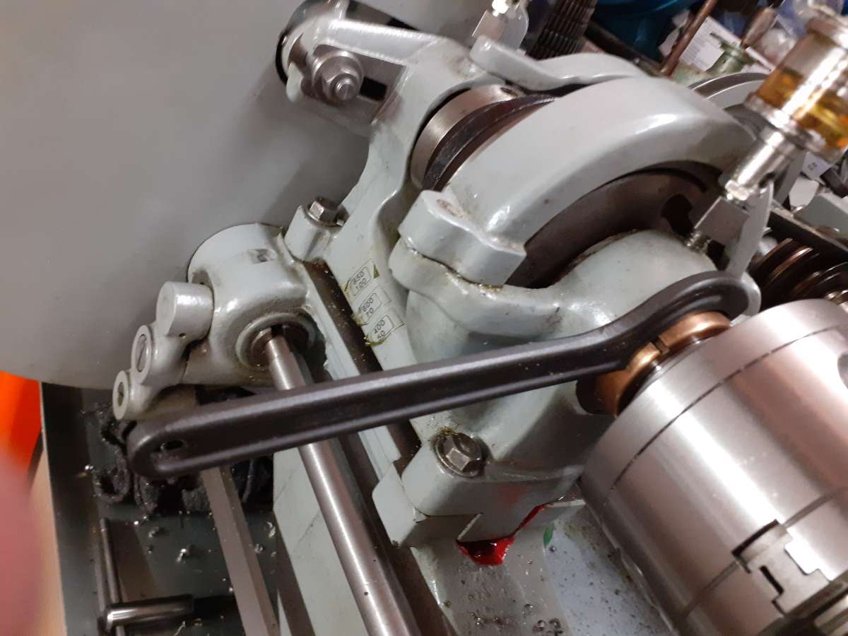

          Hi Jim. It sounds like you need to see how to adjust the bearings here is a link to my YouTube video on how to adjust the bearings.  https://youtu.be/1m00-xASpS0          Also these bearings are plain Phosphor bronze and shouldn’t be run to fast. Basically the bearings are tapered on the outside and fit into a matching taper in the casting so when you tighten the ring nut on the bearing it pulls the bearing in to the casting and closes it down on to the spindle and reduces clearance which is better.  To adjust these bearings you have firstly have to slacken the lubrication bolts which press on to a steel wedge which clamps the bearing failure to release these can stop the bearing from being adjusted and strip the thread on nut or bearing. The bearings are adjusted by firstly slackening the end float nut on the spindle to give a little clearance for the adjusting ring nut movement. Then you need to slacken the lubrication bolt which in turn should slacken the wedge in the matching slot which when you tighten the ring nut closes together slightly by action of the taper in the headstock casting. It is possible that the wedge is stuck and you may have to slacken the ring nut firstly and give it a slight TAP with a soft mallet to release it. Then tighten the bearing ring whilst rotating the chuck by hand till it feels like it is stiff to turn but you can still turn. then re tighten the wedge and oiler bolt which will very slightly ease the friction and spin with no play. Make sur that there is oil on these bearings before adjusting and do each one separately before taking up the end float with the thrust adjustment collar ring on the spindle. always run the spindle at a medium speed firstly checking for any excessive heat increase and then at top speed, which should be around 1000 RPM max.
          Pictures of the bearings with a wedge and the adjusting C spanner.
          20230804_161842[1]
          20200204_171140[1]
          If you need any further help as Keith says there is a wealth of help on the Drummond lathe web site.
          David

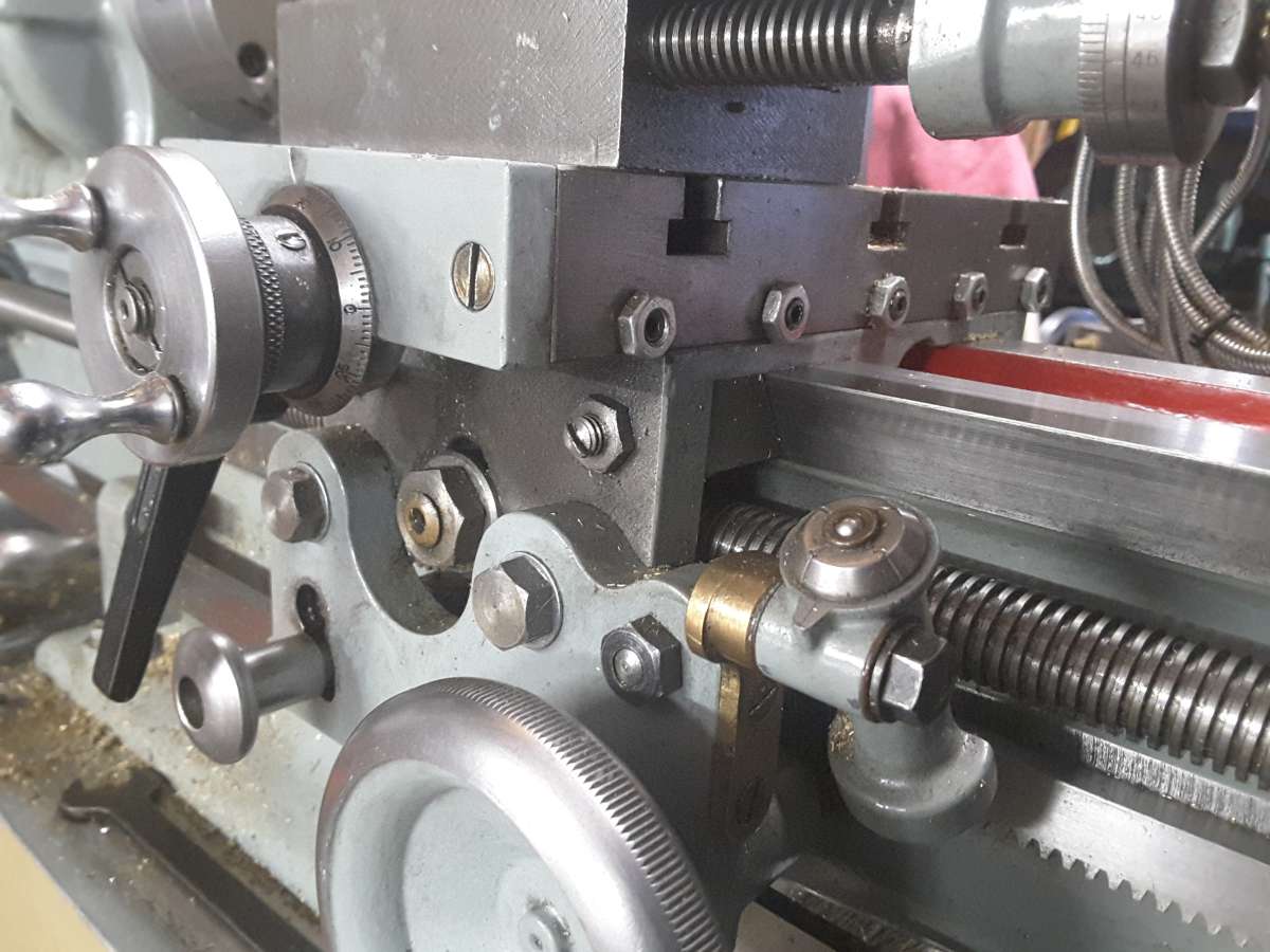

          #801093
          David George 1
            @davidgeorge1

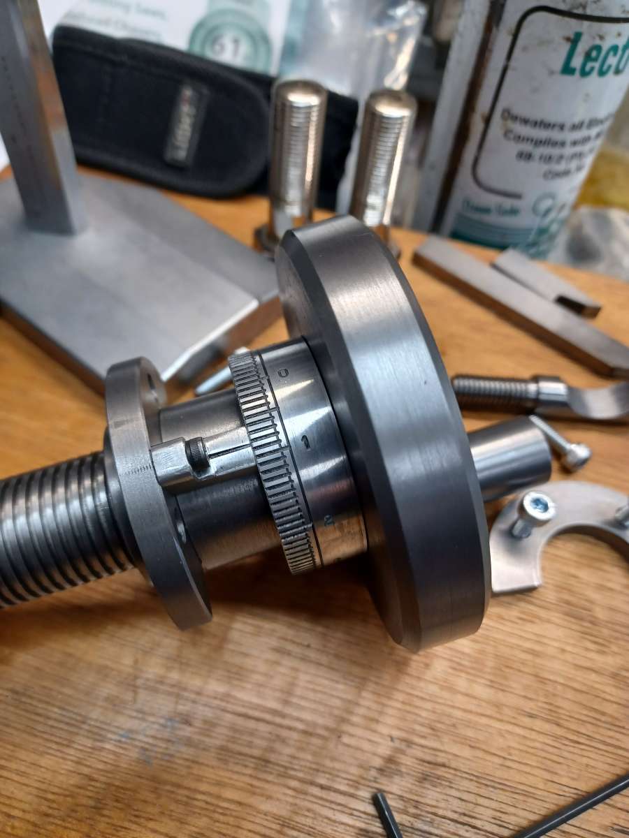

            The cross slide On my M Type lathe is adjusted by grub screws on the right hand side edge of the slide. there were no locking nuts on my lathe so I replaced them with longer grub screws and lock nuts. when adjusting  my cross slide I remove the two screws which hold the front handwheel plate and and unscrew the handwheel assembly firstly. This means you can slide the cross slide by hand and get a feel that it is just tight enough to just slide evenly across and with no play or tight spots. I remove the slide before adjusting to give it a clean and lubricate before adjusting. When replacing the handwheel wind the  feed screw in fully before tightening the two screws which hold the front plate on the the cross slide as there is clearance in the holes and it helps to keep all in alignment.
            20190208_164941[1]
            David

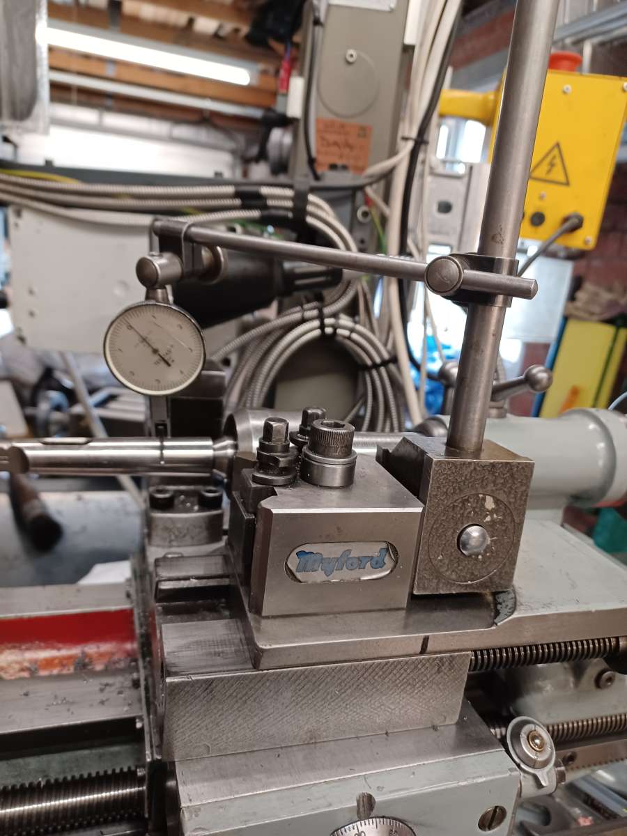

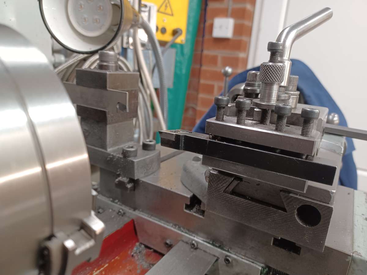

                #801228
                David George 1
                  @davidgeorge1

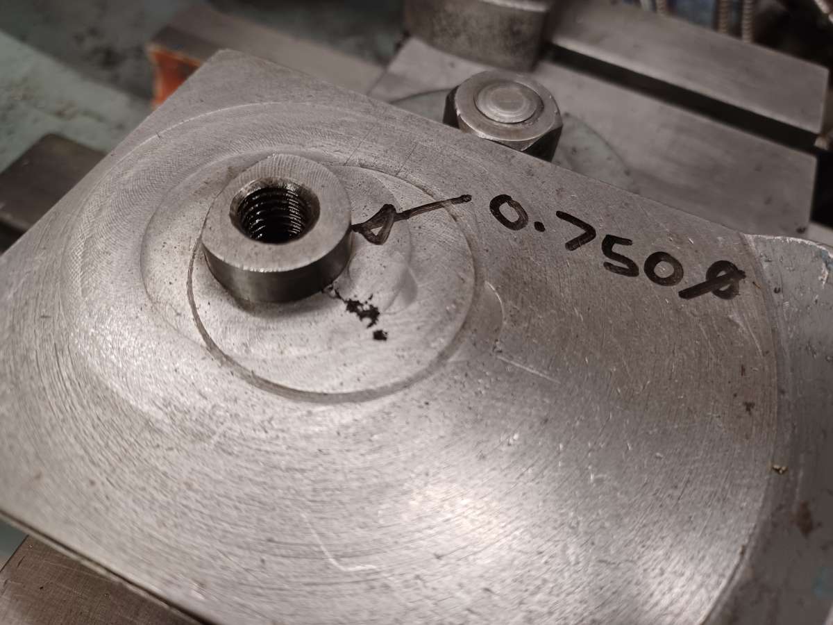

                  I have a Dixon toolpost on my lathe I removed the fixed stem except for a short piece so that it can be made into a location upstand with a taped hole for the clamp bolt.
                  20221226_131625
                  20221226_131515
                  20230327_090749
                  David

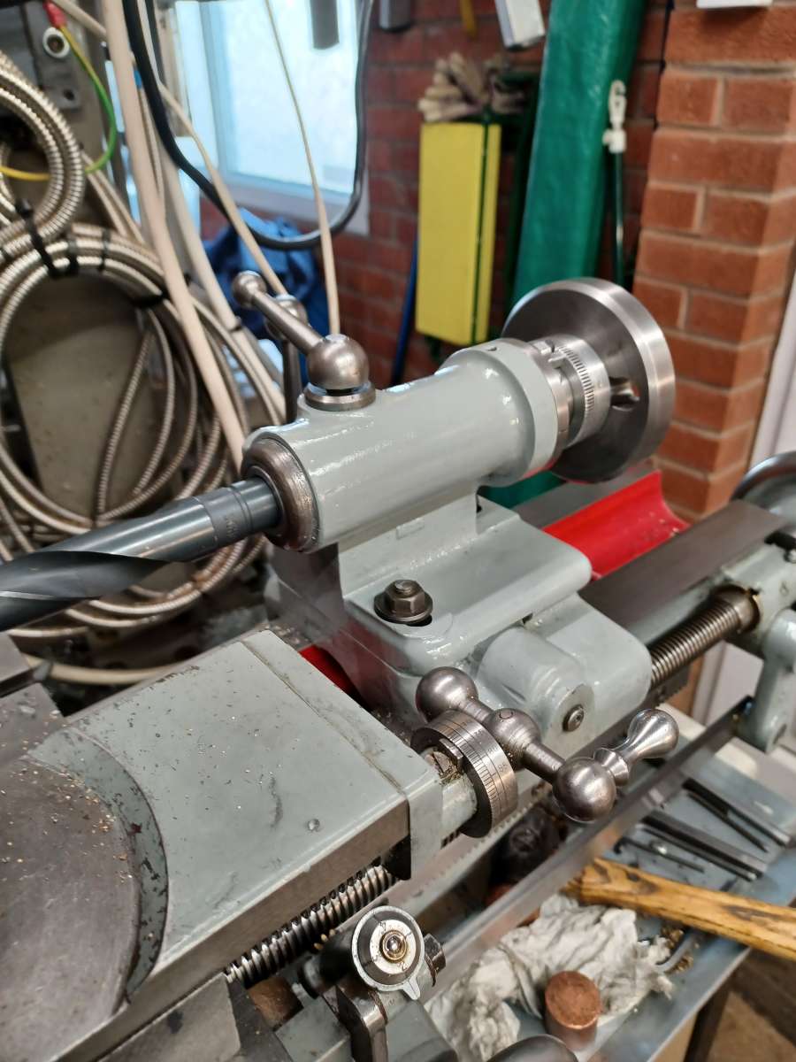

                    #801259
                    David George 1
                      @davidgeorge1
                      Yes but it is a bigger job as I had to rebore the tailstock make a new quill and handwheel etc.
                      20220315_090128
                      20220322_140844

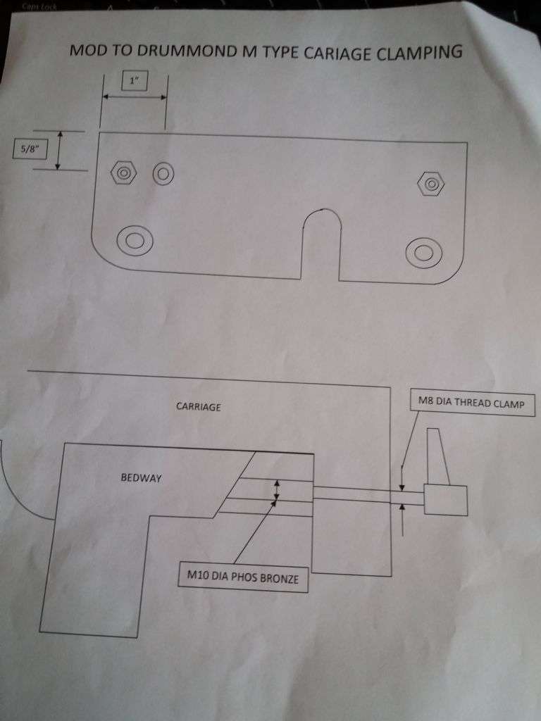

                      I have also done afew other mods and additions like a rear toolpost for parting off, A new spindle with with MT2 bore, A longer cross slide feed screw and front bridge to give more cross slide movement, Saddle front lock handle, Tumbler reverse feed with finner feed gearing and a few other tools which help me use the lathe
                      Saddle clamp3
