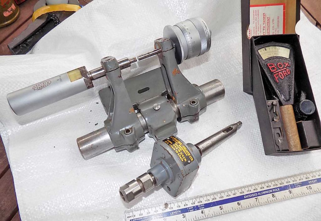

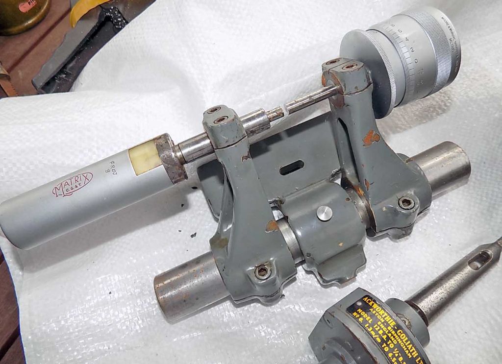

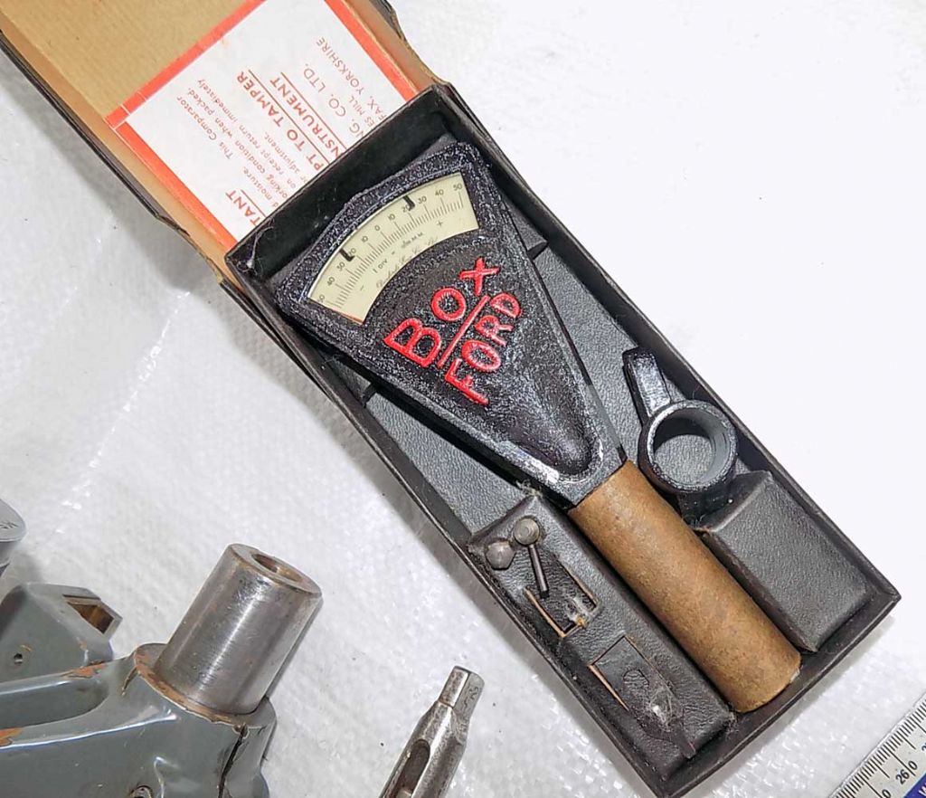

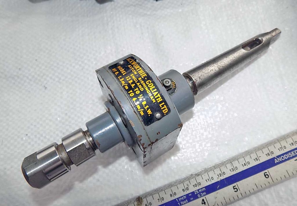

      Hi All,
      Good day yesterday at our local large boot sale, got these items, one of which I am not sure of its exact purpose so any help would be great.
      Pretty sure that the Ackworthie is a tapping accessory but have never seen the BOXFORD item before and have no idea of hat the MATRIX item was used for..
      Cheers, Martin
      #33261
      Martin King 2
        @martinking2
        #370155
        Rik Shaw
          @rikshaw
          Ackworthie is tapping head, Matrix is a bench inspection micrometer and Boxford looks like a bore sizing gauge.
          Rik
          #370157
          Clive Brown 1
            @clivebrown1
            Isn't the Boxford item their take on a dial indicator?
            Clive
            #370162
            michael potts
              @michaelpotts88182
              `Hello Martin.
              The Boxford item is a dial indicator as Clive says. It is for checking variations from a zero position ( In the centre of the dial ) such as centring in a lathe chuck, or on a rotary table.
              Mike Potts.

                    #370184
                    John MC
                      @johnmc39344
                      The Matrix device is, as has been said a bench (inspection) type micrometer with a fiducial indicator on the left hand end of it. This ensures that the micrometer is always used consistently, that is to say it is not over over or under tightened onto the work being inspected.
                      #370219
                      Martin King 2
                        @martinking2
                        John MC. is that the small dial with the discoloured cover?
                        Andrew Tinsley, You could try 15.9650° S, 5.7089° W wink, no guarantees of course……
                        Thanks folks for the info, the Boxford item seems very well made indeed and in great condition.
                        Regards, Martin

                            Posted by Martin King 2 on 03/09/2018 14:37:42:
                            Yes it is.

                                        If the fiducial indicator and the micrometer itself are in good shape in a temp controlled 20 deg C room you can easily measure to +/-.0001" with the Matrix unit. The fiducial indicator part (big drum at left) is designed to accurately and repeatably control measuring pressure to achieve the higher accuracy than normal micrometers.
                                        If bashed or left in the rain for months or years it may not be OK. If in good nick it is a valuable tool for close tol work.

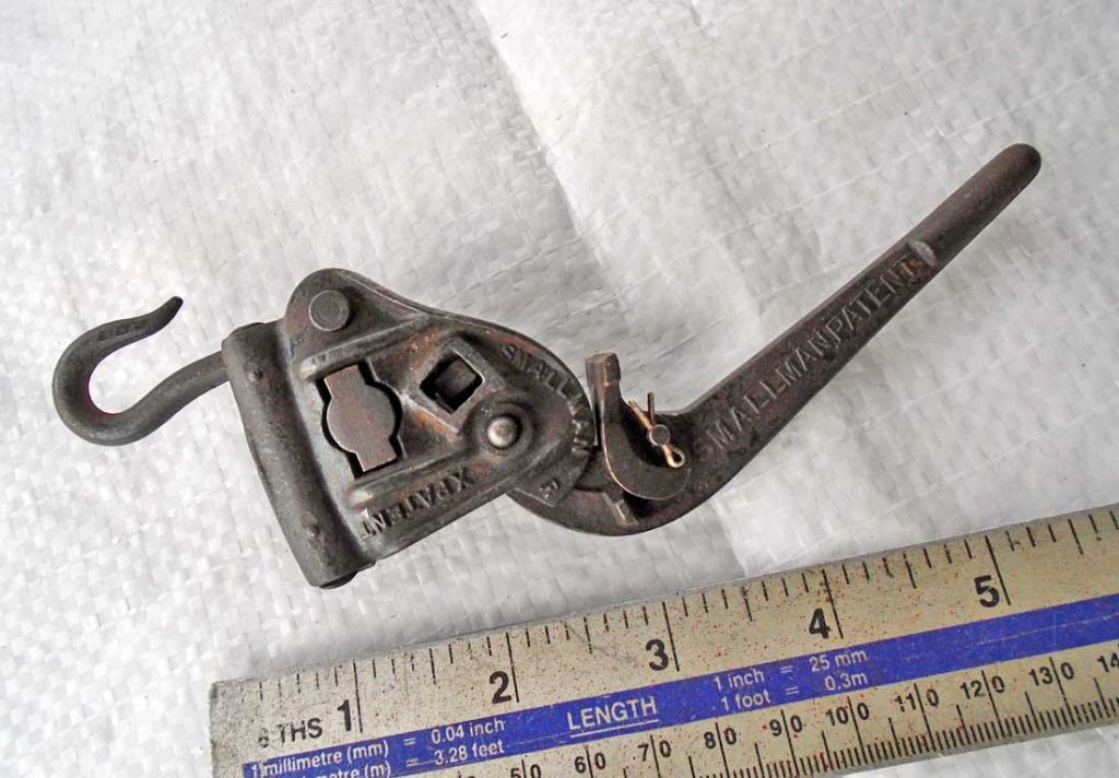

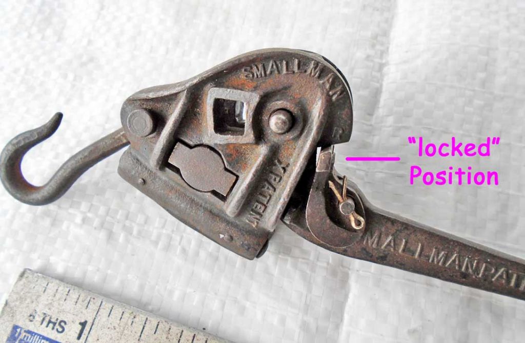

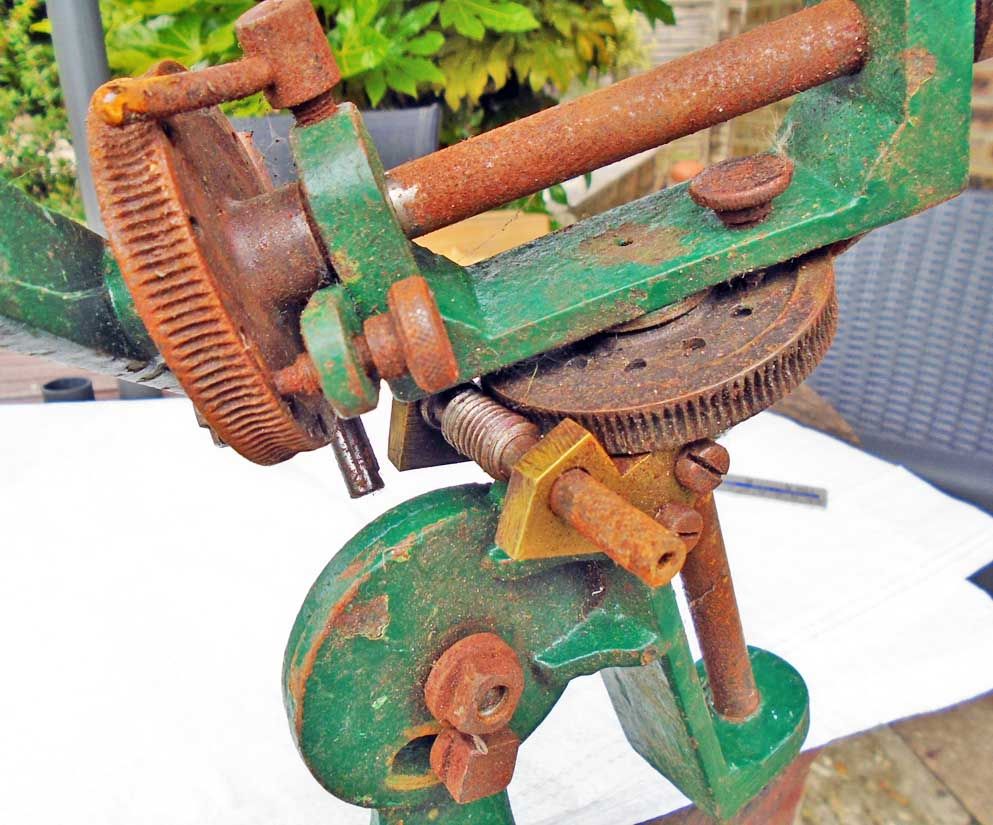

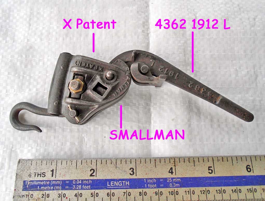

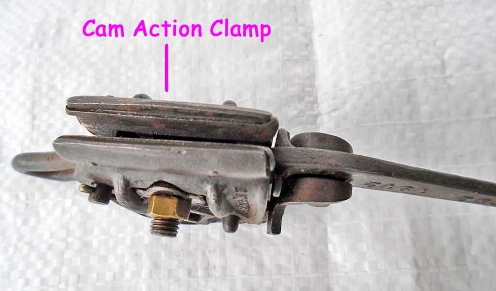

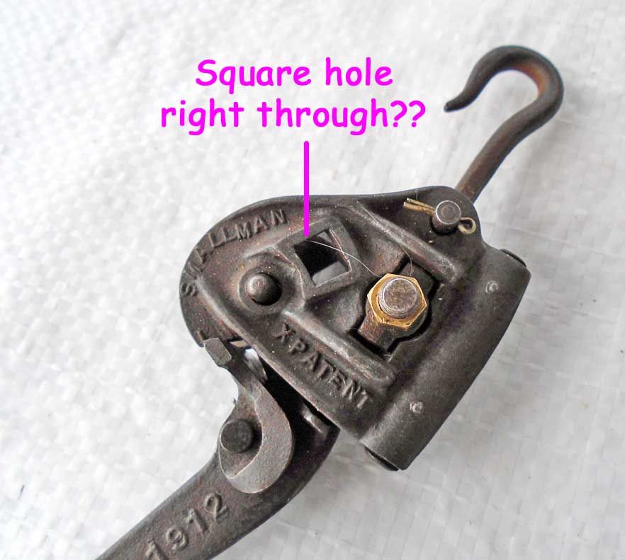

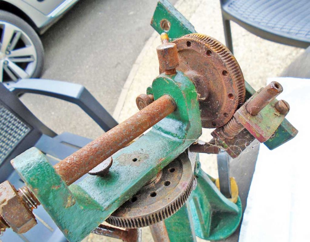

                                          Hi All,
                                          Here are todays 2 car boot mystery item finds! The first is very strange and I have no idea what it is for, only 6 1/2" long overall, beautifully made from castings as shown:
                                          Not sure if there is a square shaft part missing? The lever locks into position and closes the clamp section as it locks?

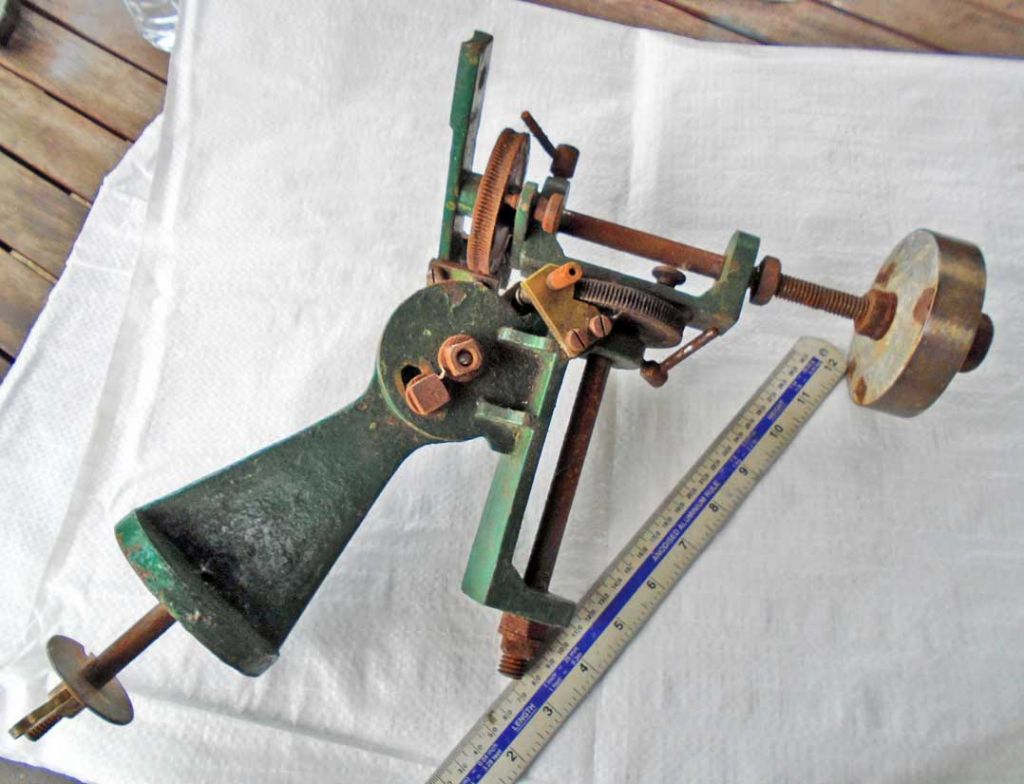

                                          The second item is , I think, some sort of dividing head or indexing unit but no idea what for or from?
                                          Should clean up OK by the looks of it. The really odd thing was that 1/2 an hour later at a different stall a clearance guy unloaded a really nice boxed MYFORD dividing head with plates just as I was walking by;
                                          When asked how much he said "a tenner if I don't have to lift it back on the van"! Xmas is early!
                                          Cheers, Martin
                                          #415724
                                            Martin
                                            1. looks interesting [and, I guess, might be using forgings rather than castings]
                                            2. could well be an equatorial telescope mount
                                            3. crying 2
                                            Edit: http://collection.sciencemuseum.org.uk/objects/co8413014/larger-smallman-patent-haula-hook
                                            Edit: http://www.healeyhero.co.uk/rescue/individual/Bob_Bradley/Bk-3/B3-1928-D.html
                                            Edited By Michael Gilligan on 23/06/2019 13:27:03
                                            #415725
                                            Martin King 2
                                              @martinking2
                                              Hi Michael,
                                              I thought forgings NOT castings just as I hit the "post" button, blush, castings would of course break easily.
                                              Does the X Patent mark mean it is USA in origin? If so, probably quite old?
                                              I had not thought of a telescope mount! Sounds about right, perhaps Neil will bne along with some input?
                                              3 Love the emoji! Dividing head now gone!
                                              Cheers, Martin

                                              Martin King 2
                                                @martinking2
                                                Michael, just checked out your very kindly supplied link, all is now clear! Many thanks.

                                                #415728
                                                Maurice Taylor
                                                  @mauricetaylor82093
                                                  The smallman clip was used to fasten a small rail truck on to a haulage rope which ran between the tracks .A larger version was used on the 2foot gauge tracks in coal mines.

                                                    old mart
                                                      @oldmart
                                                      The telescope is fixed to the far left end opposite that balance weight.
