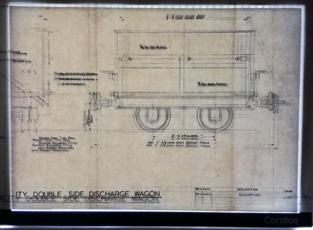

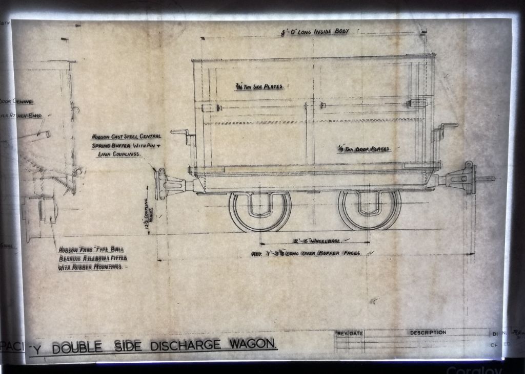

                                                Hi Nigel Graham 2, I don't know what Brother you were looking at, but I have had a Brother A3 printer/scanner model MFC-J6510DW for a number of years, the scanner will scan a full A3 size page and will print out onto a A3 page. However, like most printers and scanners, it often seems to depend on and the flexibility they are used with, some seem to only work with the software provided as my Epson A4 scanner will. My Brother one that I've mentioned seems to be happy using a number of different programmes. Below is the results of scanning part of a drawing, the first being the result of the scan done by its own software.
                                                discharge wagon #1.jpgYou should notice that although is has produced an A3 scan, but it's not clear at the top and bottom of the view, that there is a small margin all around it, but it can be seen at both of the sides. When printing this out in Microsoft Office Picture Manager, this also puts a margin around the image, and thus you get a smaller print than the original as can be seen when overlaid on top of the original drawing on my light pad.

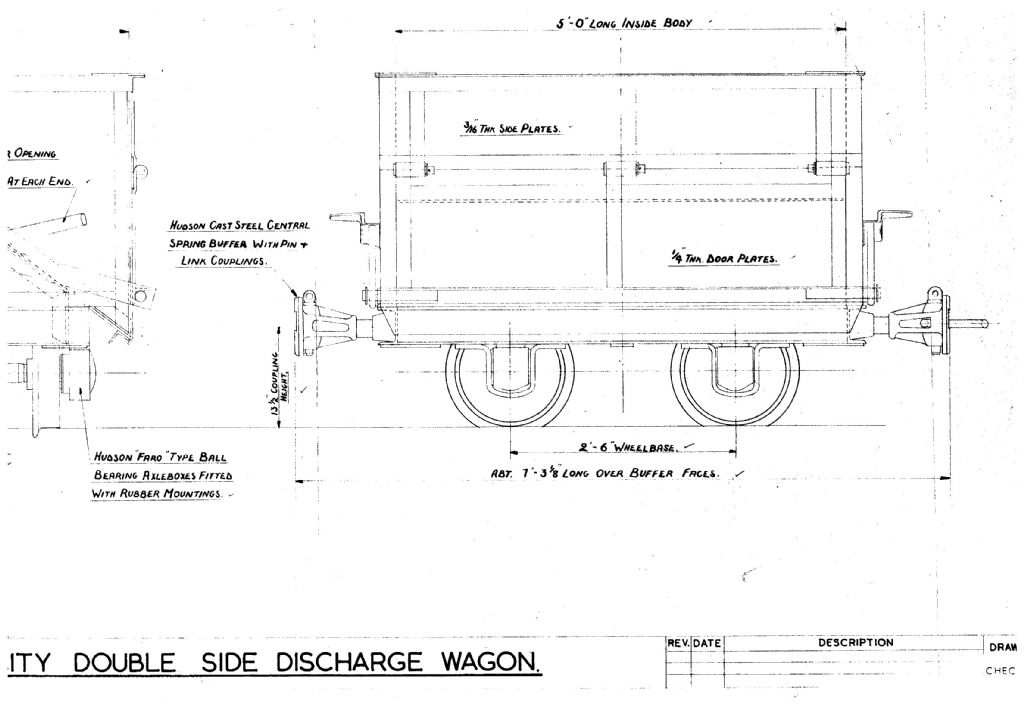

                                                To get over this, I first cropped off the margin on the scanned image and printed it out and setting the option of "fit to frame" although I had cropped it a bit too much.
                                                Now when overlaying it onto the original drawing, it is slightly bigger, but is very close to the correct size. I do have a programme that the scanning and printing can be controlled very well, but scans and drawings have to be done on a page that fits into the margins of the printer one is using, the only problem is that it's an old programme from the Window's 95 era and will only work on a 32 bit OS and is really fully good as far as Windows XP. But my Brother one will work with XP OK.

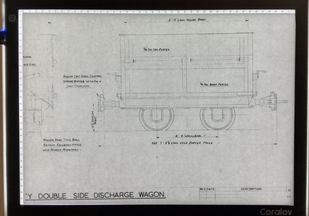

                                                    Hi, I forgot to add the photo of the second overlaid print, in my previous post, where you can see it's almost the same size as the original, just a tad bigger, but still an A3 print.
