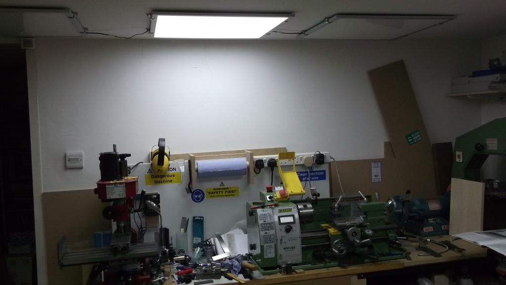

            I too have a cellar workshop (set up years ago mainly for woodwork) = T+G wooden floor suspended on small battens – around the metal bashing half of workshop I've now fitted a rubber mat (the thick one mainly holes as sold by Axminster + others) – works well but also built a small plastic guard around the mill to prevent swarf thrown off over the wooden floor – replaced lights recently with 4 600mm sq LED panels (now around ?65 + VAT from distributors such as Wilts) cool white JCC tiles mounted flat (2mm spacers) to ceiling – no problem with heat so far after a year as only 30W spread over 4 sq ft – later installed 2 extra switchable panels one over the other side of a mill and a lathe as central light over middle of bench was excellent but with older eyes brighter lights help for detailed work.
            Extended the original 32A ring main with flexible trunking and added another 16A switched spur off the box (all ccts use RCBOs) – left room in fuse box for another 16 or 32A cct if needed
            The one remaining nuisance is that the drill press originally bought some years ago is in woodworking half and metal swarf doesn't mix well with woodwork (neither does wood working dust agree with metal work – I need to improve dust extraction from a saw bench not designed to allow easy extraction) but not really enough room for a second drill press tho.

            Muzzer
              @muzzer
              Similar looking 600 x 600 and 38W LED are now under £40 (inc VAT) from Toolstation. Looks like a good deal.
              My main suggestion would be to go for well diffused lighting so you don't get any significant shadows – like these panels Frances mentions for instance. And it's difficult to have too much lighting. I find those single LED lamps (eg the ubiquitous example from IKEA) almost make it more difficult to see what you are doing.

                I think you will find that modern electronic ballasts for fluorescent light work at a much higher frequency than 60Hz. There can be a problem with the old ones in the Europe with 50Hz as they can make 3000rpm look stationary but in practice having seen this it's more a case of the rotation rate looking a little odd even if the rpm is carefully tuned.
                I use a modern lower diameter 5ft 60w tube light with an electronic ballast plus local machine lighting. That gives a decent level of room light but my ceiling is pretty high. As you can see from the photo that has been posted ceiling lighting doesn't produce very even lighting. The local lights I use are sold by Ikea. They are on flexible stems that can either be fitted with a shelf clamp or a base for wall fixing.

                  my photo is very deceptive in that camera is looking direct at panel and has made rest of area look dim – the actual light in lumens/sq foot over workbench considerably exceeds the standards required- light actually is very diffuse over the bench – the added two lights were there mostly to compensate for the shadows caused by the equipment itself – I have a small LED on flexible stem to put light right at mill cutter tip if needed
