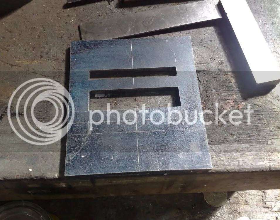

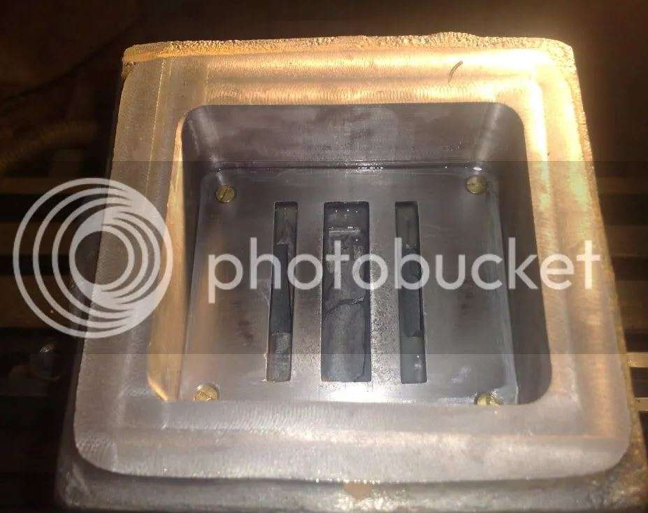

                The one that springs to mind was on a 4″ compound traction engine, the guy set it in with araldite and I think a couple of small CSK brass screws in the corners.
                The other way would be to make the plate a little larger than the inside of the valve chest so the chest would hold the plate from being able to come out of the  portface.

                  Found the old pictures
                  kev 1
                  kev 2

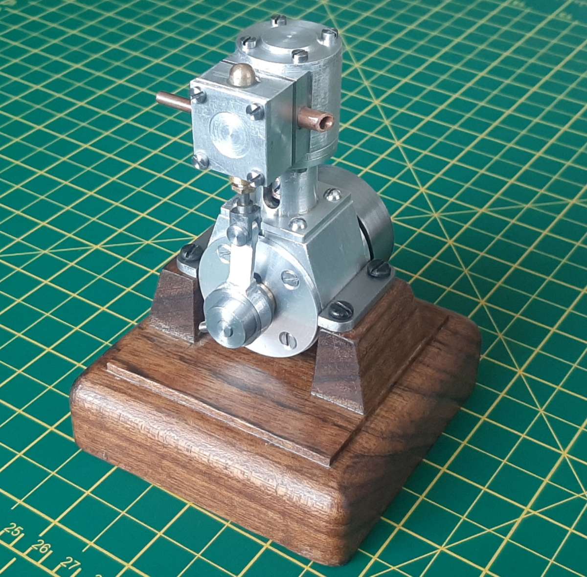

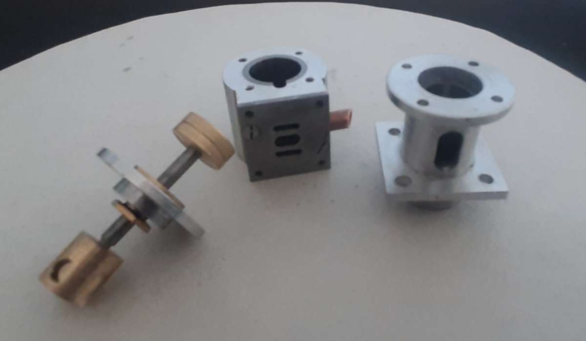

                    Hi Ian,
                    I made a small alloy engine with cast iron inserts in the cylinder and the cross head guide.
                    Also a cast iron port face jb welded and screwed in place. The engine runs really well20250417_12173020250503_101852geoff
