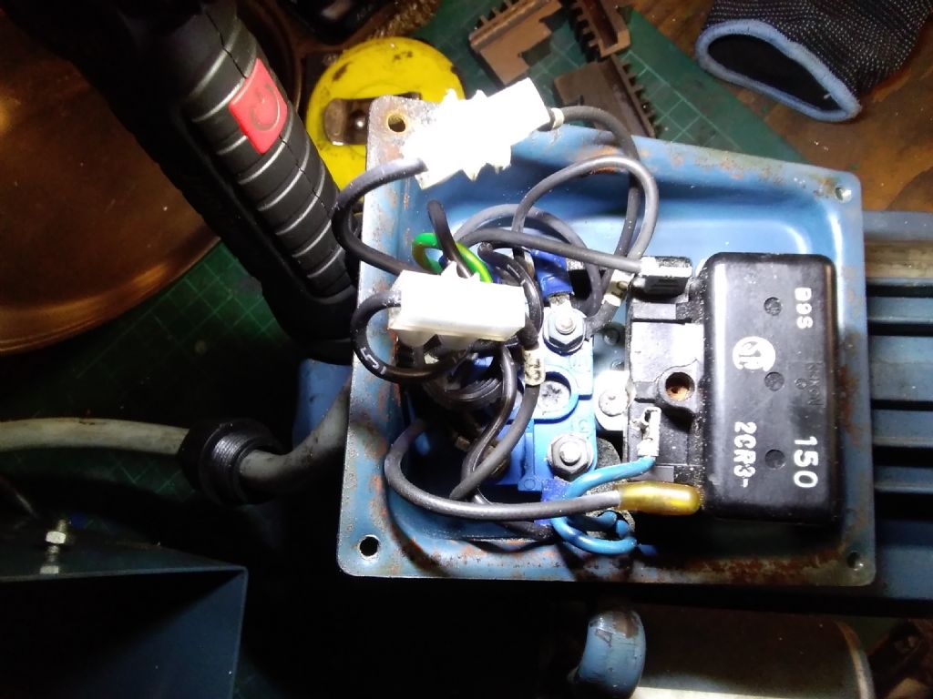

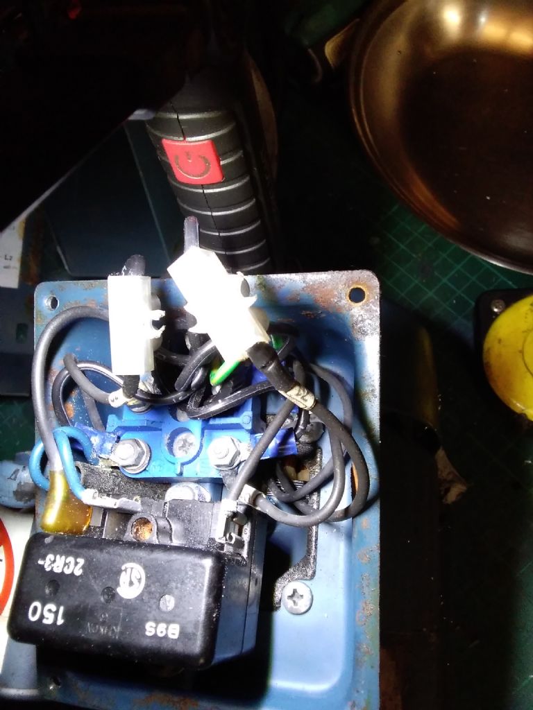

        I've just removed this small motor from my lathe with the intention of using on something else, it has a 2 direction switch wired up, if I could have some input from you clever electrically minded folk, I want to wire it with a simple NVR switch, no reverse needed, the motor has 2 live and 2 neutral, how do you do this on this setup with 4 wires?
        Please excuse my ignorance on electrical matters.
        I'll upload a photo in a moment.

        #449529
        Pete.
          @pete-2
          Motor 1
          #449530
          Pete.
            @pete-2
            Motor 2

              That looks like a start relay so the motor may have start & run windings. Some do. That could be connected to a timer or a centrifugal switch on the motor shaft.

                Thanks Steve, do you know how to wire up a simple 2 wire nvr switch rather than the 2 direction switch currently fitted?

                  From your picture I would not know. Without a wiring diagram I cannot help, sorry. Maybe someone will be along who can help.

                    Sometimes there is a wiring diagram on the inside of the cover but failing that is there a plate on the motor. There seems to be markings on the cables that may give a bit of a clue, draw a sketch with cable markings and conections woukd help.
