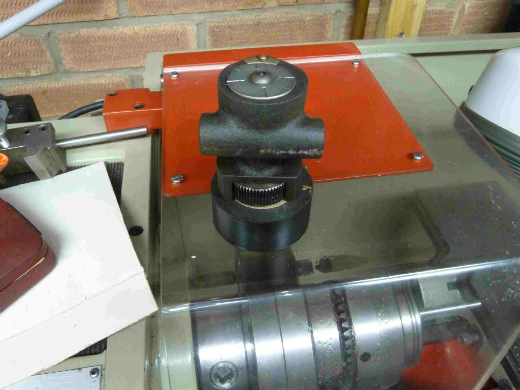

        Hi
        Is anybody able to identify which lathe does this thread dial indicator come from? I’m having a clear-out so it needs to go to somebody who can make use of it. Note the worm gear has radiused teeth. The number of teeth are not marked but if I've counted correctly, its 64
        I’ve done some Googling and the closest match I can find is:
        TU-2506V from the photo in **LINK**, so its possibly off a far eastern lathe
        Any help gratefully received
        Many thanks
        Tony

          Hi
          From what I can see it comes off a standard Asian 920 lathe supplied by many companies.
          Regards.
          Keith Wood

          Roger Provins 2
            @rogerprovins2
            Agree with Keith – looks the same as the one on my 9×20 Chinese lathe.
