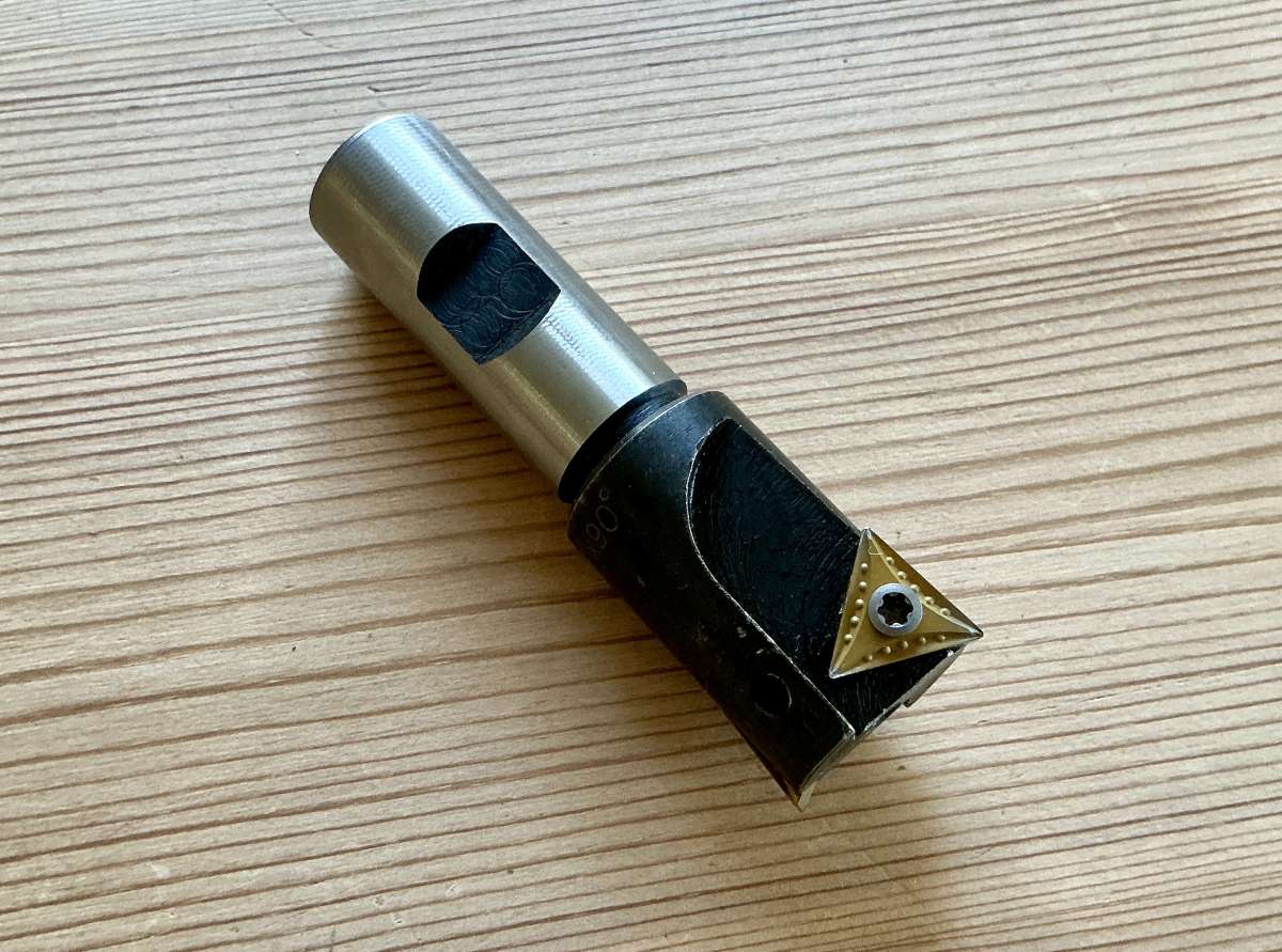

                                              And was wondering if they will also work on my End Mill? Many years ago I bought the Little Hogger set from Chronos. I had to stop using it for a while as they didn’t have replacement inserts. I then started using TNMG inserts for turning and couldn’t help noticing that they were the same size as the inserts for my mill. A quick test proved they worked very well for this unintended use. Much cheaper too. Chronos only seem to sell sets of three different inserts for the Little Hogger but I only generally use this one.
                                              IMG_5139

                                                The Little Hogger indexable endmill would not be happy with TNMG  inserts, they are more likely to use TCMG type which look similar but are single sided with a 7 degree clearance angle wheras the TNMG are double sided with zero clearance, the sides are square, 90 degrees. The sides of the cutout for the insert are angled to match the 7 degrees, so the bottom of the cutout is smaller, I cannot understand how you got the TNMG’s to even come close to fitting.
                                                Users of HSS tooling have a legitimate reason to use a QCTP as the height changes every time they are sharpened, at the museum, we have at least 60 tools using carbide inserts, all at exactly the same height, so we don’t need to worry about tool heights and both lathes share the same tooling. Only boring bars have shims, kept in the box with the bar. Having 60 or more QC toolholders would be pretty expensive and take up a lot of room.

                                                  I’m sorry to disappoint but I am using TNMG inserts (as in the picture) in my little Hogger and it works well. I’ve only tried steel cutting inserts so far but I’ll try the polished ones for aluminium at some point.
                                                  #811811
                                                  old mart
                                                    @oldmart
                                                    It is very unusual for a milling holder like yours to use negative inserts by design. I have got some TNMG 16 inserts in aluminium grade and they work well. I don’t think those discounted inserts would be any good for milling, the cutting edge is much too limited, the cutting edge only extends half of the side. I bought a box of very similar and found they would be more useful in a big lathe which could cut most of the depth of the cutting edge per pass, say 6mm depth of cut. I tried sharpening n edge with a diamond wheel and the insert cut aluminium quite well, but they will not be likely to get much use.
                                                    #811816
                                                      The Triangular little hogger inserts do not have any clearance angle. And as for the pocket that looks as though it opens out towards the bottom, certainly NOT angled to match a 7deg edge. So I can understand Vic getting on OK with TNMG.
                                                      The angled outwards pocket means the neutral edge insert locates against it’s side a sthe pocket is a little shallower than the insert’s thickness and also means you don’t risk damage to the actual cutting edge on the back side by trying to seat it down into a 90deg internal corner.
                                                      The cheapies he shows will be fine too provided the vertical depth of cut does not exceed the cutting edge. Note that the pocket geometry makes them unsuitable for milling a vertical edge, really only for flat surfaces.
                                                      TNMA is the most likely code as there is no CSK on the hole.
