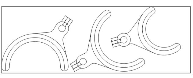

        I've suffered a small setback in my effeorts to build my gearbox design. The gear selector forks are supposed to be made from bronze. I asked for a quote for their production and supplied a suitable drawing of the largest of the three. Unfortunately the casting producer has to sub-out the 3D printing of the moulds. The castings would have cost about £65, which I thought was very reasonable, but the mould printing was going to add another £135 or so to the cost! I can't justify that outlay, so I'm thinking that I might have to carve them out of bronze or brass plate. The finished articles are 10mm thick, so we're talking seriously thick plates here. Or I might get away with two brass plates of 5mm, soldered together. I can't go any thinner, or the joint lines will interfere with the machining. Any ideas, anyone? Or alternative suggestions. I could easily fit them on a plate 170mm x 60mm, as below:
        P.S. The design has changed, slightly since I drew this, but you get the idea.

          Get a bit of hollow cast bronze and make the "C" shapes, looks like you may get two from one piece and the third from a smaller dia. Then Silver solder on the other bits.

                        Does it really need to be 180 degrees? Would 90 do? Then the bearing part could be machined from a bar with a bit more waste. Perhaps it could be bent from bar to get part way there. The mounting part doesn't need to be bronze.
                        #429584
                        Ian P
                          @ianp
                          I know you said you have changes the drawing now but if optimising material usage saves money the layout you show could be much improved (as long as its being cut with steerable blade like a fretsaw, but much more manly.
                          If these forks sit in grooves of gears that are close fitting on the shafts/splines then would just say 120 degrees of the circumferencial engagement rather than 180 be OK, would save even more material.

                              Yes, I'm sure that I can optimise the layout to use less material; the drawing was just one I bashed out to illustrate the basic shapes and scale. You're right about the angular dimensions, too. I'll bear that in mind.
                              I have some aluminium plate 12mm and 10mm thick, so I'm now considering making them out of these in the first instance. Firstly, it will let me practice the machining sequences and by making them 2% oversize, I could use them as moulds later. More thought required. In the meantime, I've got more than enough gear and spline cutting to keep me occupied!

                                    If the central one could have a fractionally shorter arc they would all come out of the 2" x 1/2" bronze bar I suggested from M-machine if your sketch is 60mm high. and no need for any soldering.

                                        I have taken on board all the leads and suggestions and have decided on the M-Machine metals route, using ½" x 2" bronze bar. By also reducing the angular bearing arc to 120°, I can further reduce the waste material. I don't want to go any less, for aesthetic reasons. It just doesn't "look right".
