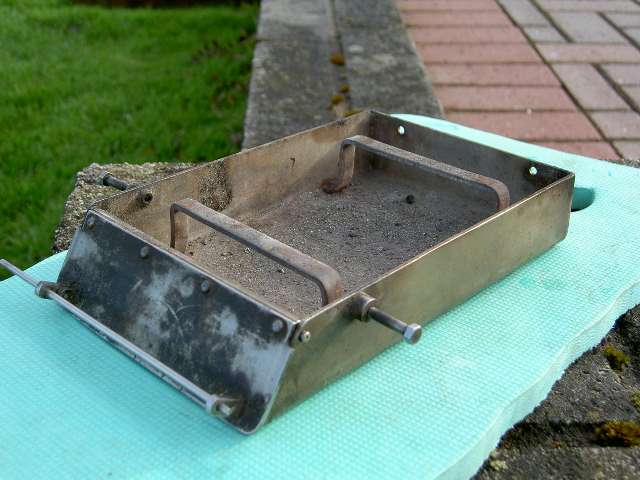

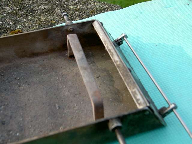

            MichaelR
              @michaelr
              Ashpan for Durham & North Yorkshire 2″ Scale
              Dominic, This will give you some idea.
              MichaelR
              PICT0021PICT0022
