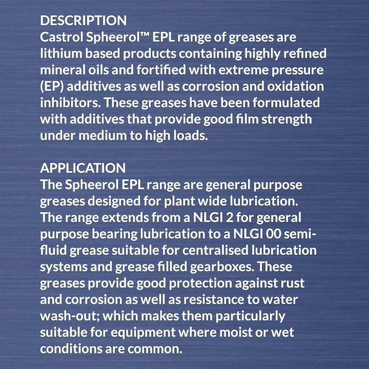

                        Semi Fluid EP Greases are semi fluid, extreme pressure, lithium thickened greases developed for lubrication via automatic lubrication systems and applications such as gearboxes where a grease is preferred because of leakage problems with conventional gear oils.
                        Does this answer the question?
                        Description:
                        Castrol Spheerol EPL 2 Lithium Grease NLGI2
                        A multi-purpose semi-fluid Lithium, EP grease suitable for use in Centralised Lubrication systems and enclosed gearboxes.
                        Castrol Spheerol™ EPL is a range of greases which comprises lithium based products, containing highly refined mineral oils, fortified with extreme pressure (EP) additives as well as corrosion and oxidation inhibitors.These greases have been formulated with additives that provide good film strength under medium to high loads.
                        The Spheerol EPL range comprises general purpose greases designed for plant wide lubrication. These greases provide good protection against rust and corrosion as well as resistance to water wash-out; which makes them particularly suitable for equipment where moist or wet conditions are common.
                        As used in Boxford VM30 mill gearbox

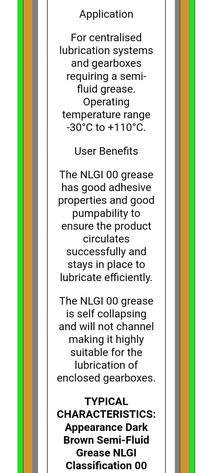

                                      Could Kwil clarify if the number 2 Castrol is suitable, as I'd planned on the replacing the grease on my boxford vm30 gearbox in the near future, I found this that gives the impression the double zero grade is the semi fluid?

                                          The brownish grey colour you mention makes me think of the semi fluid grease we use on rotary gearboxes at work : Rocol aerospec 100 semi-fluid **LINK** Probably not the same material as it's quite expensive, but maybe a similar composition.

                                            Posted by Pete. on 29/04/2021 20:34:58:
                                            The double zero is one grade thinner than zero. The number 2 Castrol is one grade thigher than number 1 etc.
                                            The numbers are from the NLGI Consistency number

                                              I meant is the number 2 semi liquid, it says 'general purpose bearing grease' in the information I found, which makes me think not, or is number 2 semi fluid, and the double zero near oil consistency?

                                                  The information in the Miller version of the NLGI 00 seems to confirm it's the 00 grade that is suitable for enclosed gearboxes, but happy to be corrected if anyone knows better.

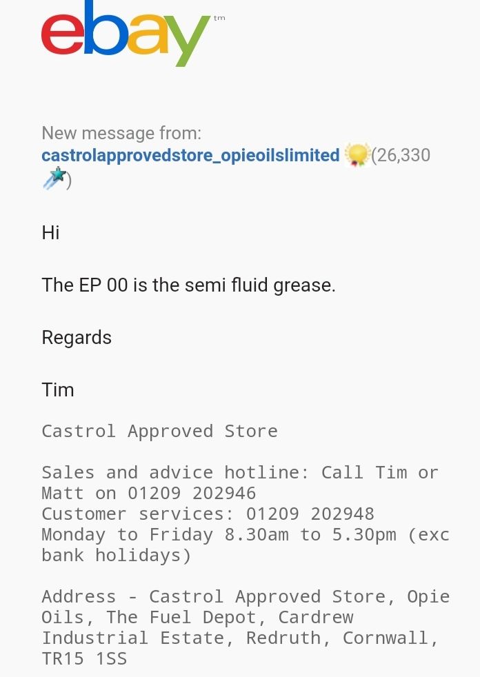

                                                      Andrew, I had a reply from opie oils earlier, they confirmed it's the #00 grade which is the semi fluid grease, if you ordered the #2, it's probably just general purpose grease for bearings.
