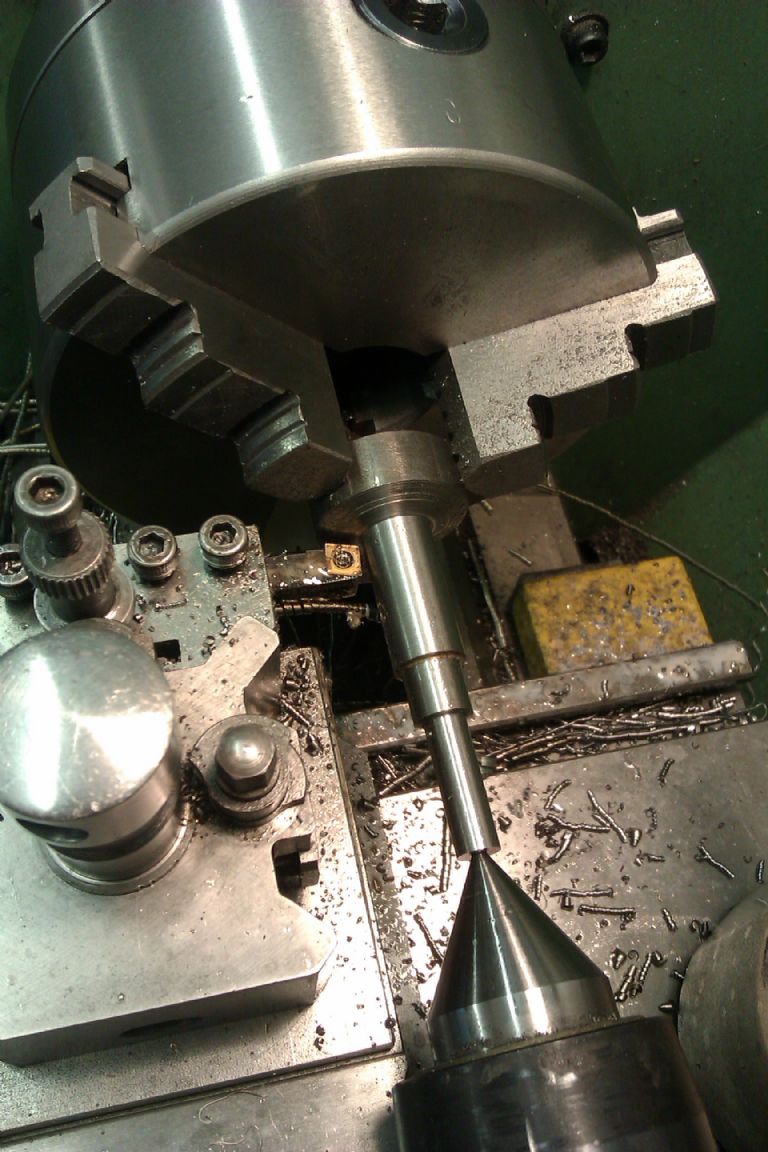

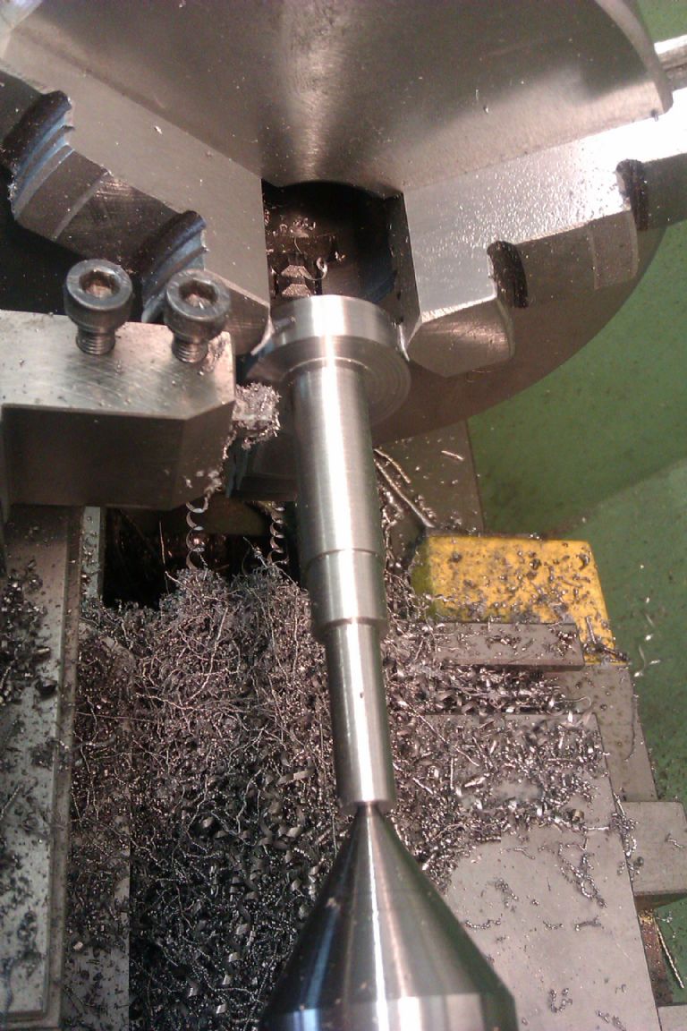

                                  Because of the angle of the cutting edge (100deg+ 5deg clearance) you cannot turn upto a sholder so either have to turn right through to the other side or use the tool to take out most of the waste and then swap for a right hand tool.
                                  Here you can see where I roughed out the crank for my firefly and you have to leave the sholder at an angle. You can take a good cut with these 0.100" if your lathe is upto it.
                                  Firefly138
                                  Then go back and tidy it up.
                                  Firefly141
