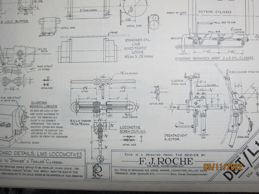

                    Interestingly, my copy of "Historic Locomotive Drawings in 4mm Scale" by F.J.Roche does not show the gedge on sheet DET/L1 for LMS locomotives. Strange because I have always had a good deal of respect for the accuracy of his work.
                    #619663
                    paul rushmer
                      @paulrushmer83015
                      Roche is correct the drawing says details LMS Locos these did not have a gedge the couplings had a slot in them so the eye of a coupling shackle could pass through it. I hope this makes sence, gedges were normaly only used on freight stock.
