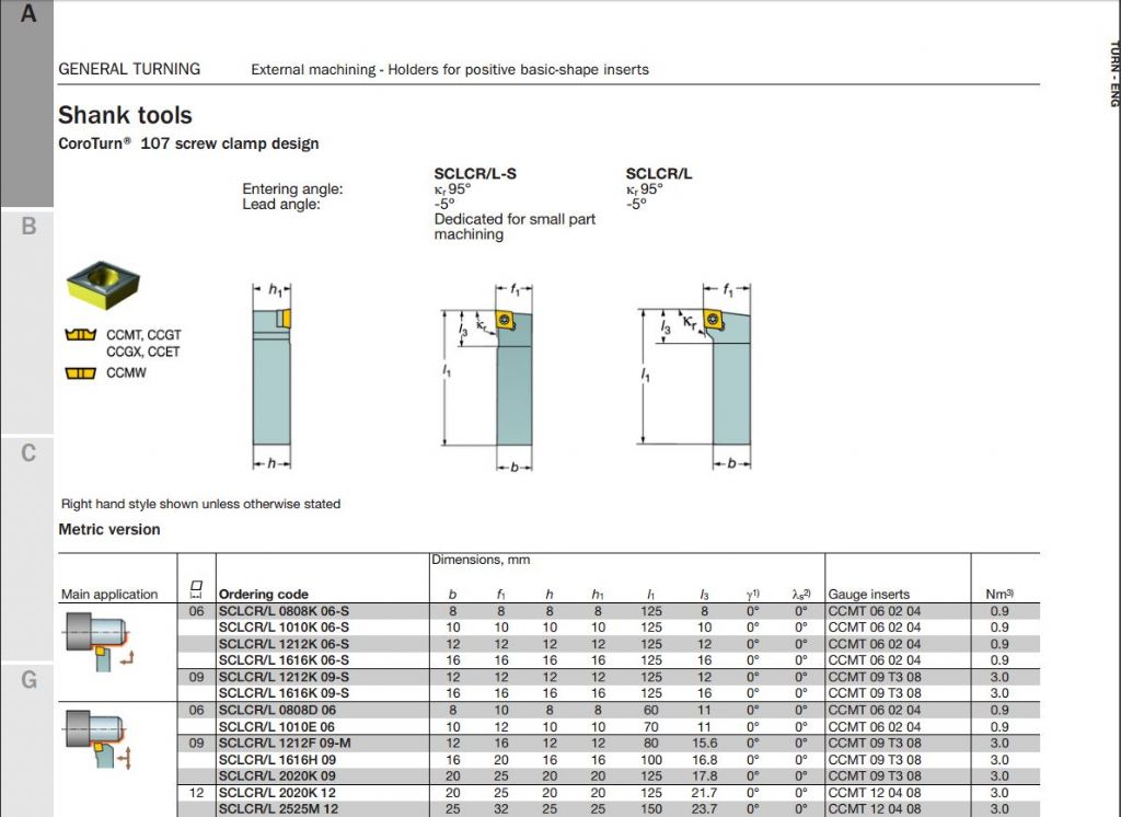

          ega – for CC*T 06-sized inserts, the torque for the M2.5 Torx screw seems to be 0.9Nm according to Sandvik Coromant's recommendations. See page 174 of this massive catalogue.

            Proper Sandvik screwdriver style Torx drivers have handles sized according to the screw size so you're less likely to over torque them, at least that's the hope! I'm not even sure now that they are standard Torx screws?

              Sandvik refer to "Torx Plus" which may, indeed, be different from standard – perhaps, in the shape of the head. These screws are notoriously expensive and easy to drop.

                  I have now discovered that Sandvik do a range of specialised torque drivers for tightening Torx screws:
                  http://www2.coromant.sandvik.com/coromant/pdf/smallparts/catalogue_04_2/inch/194-200.pdf
