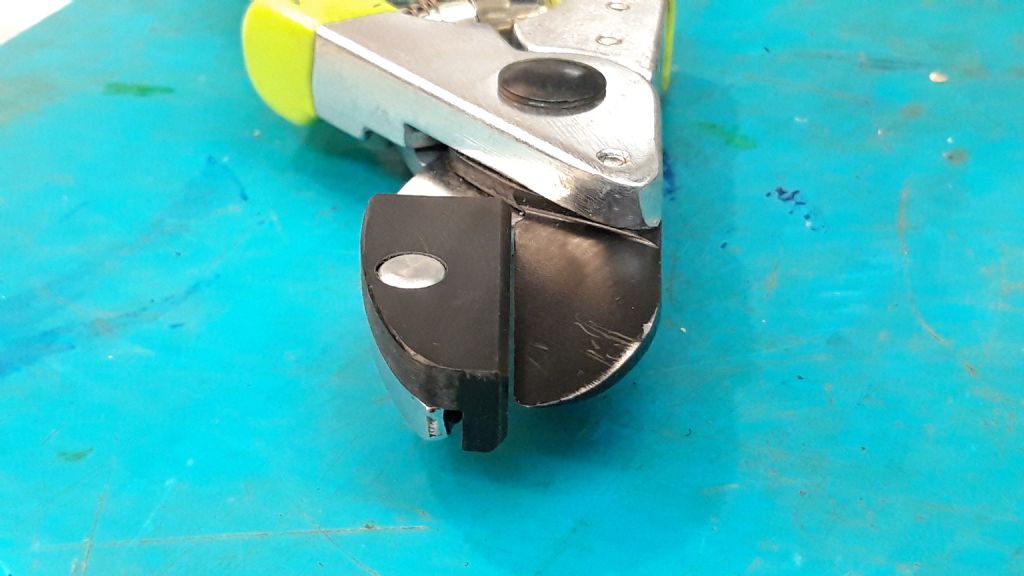

      Posted by Mike Poole on 02/09/2019 00:12:34:
      That’s the sort of thing I do but does it make sense? A new pair are not expensive but the pleasure derived from an effective repair is huge, not everything is about economics.
      Mike
      Yes Mike it's not just economics, and it was fun little job to do. Works great too laugh

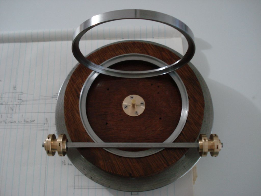

          Today I finished the wheel build jig and made the axle for a 1" scale water cart –
          Spokes are next….they may be some time!.

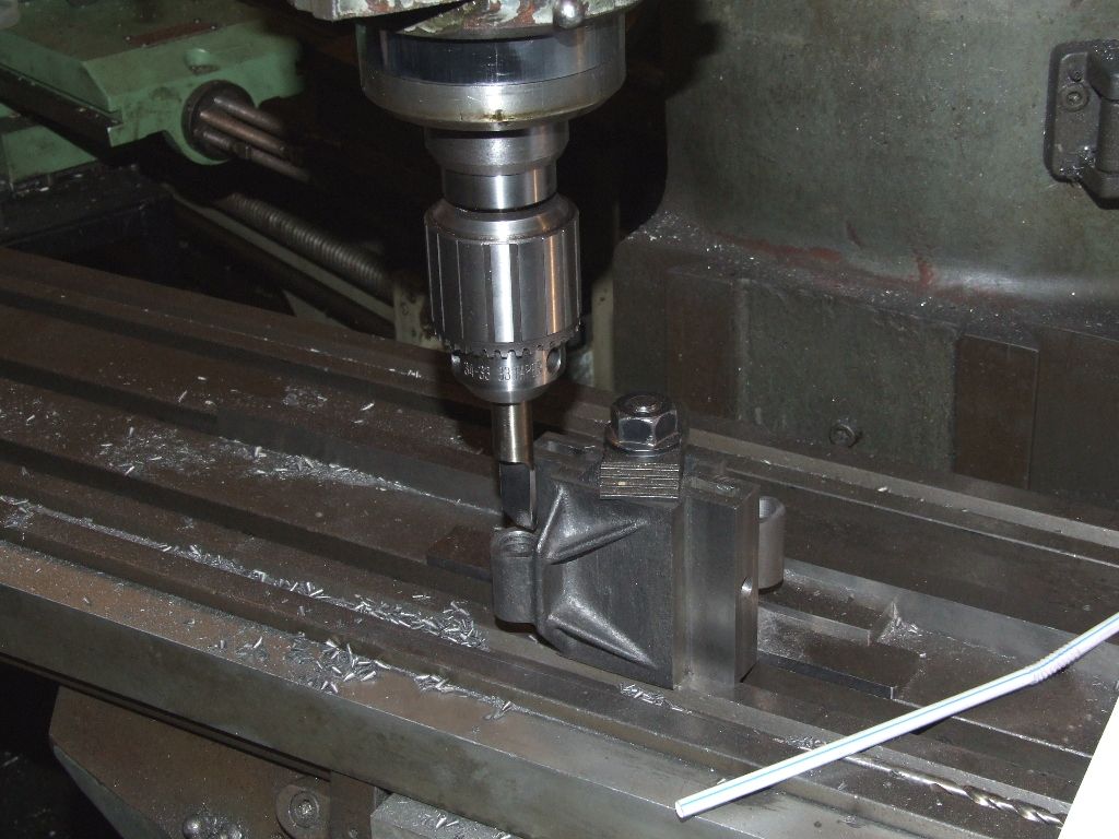

                                After the previously reported fumble of using a secondhand reamer and my home made D-bit I created a trial hole in steel using just the D-bit after normal drilling. Worked perfectly, the hole was a nice push fit on the piston rod with no shake. So this morning I went ahead and made the holes in the crossheads:
                                Total ***** mess; the holes were oversize and the piston rods rattled around. No idea why the holes were a mess compared to the steel block. Although of course the tool has been reset, the clamping arrangement is different and the material is cast iron. After a sulk, and considering various options, I tried fitting a ring of steel shim. One hole needed a 1 thou shim, two a 1.5 thou shim and one a 2 thou shim. This was in conjunction with some fine tuning of the piston rods as a couple of them varied in diameter by a few tenths over the length in the hole. Fortunately the result is now piston rods that fit tightly in their sockets with no shake:

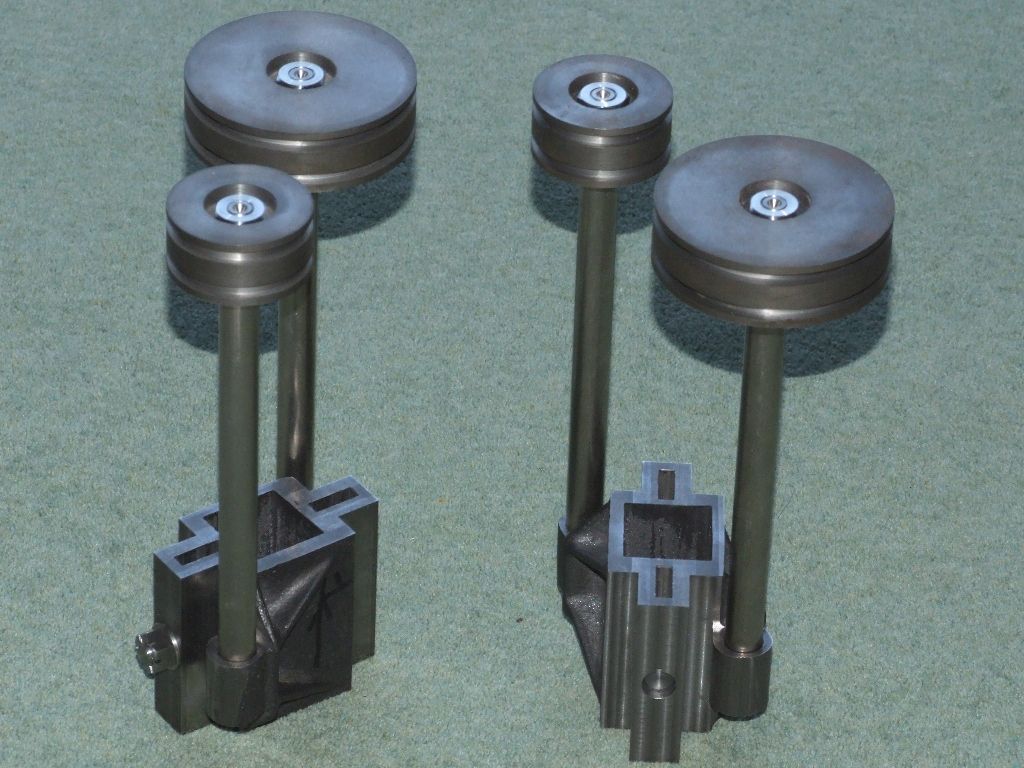

                                From the CAD model the diagonal dimension outside to outside on the piston rods is 4.1447". On both assemblies it measured 4.144"; not bad, especially as the piston rod material is half a thou undersize. The piston rods seem to be parallel to within a few thou as well. Although not an important dimension the distance from the top of the piston to the bottom of the crosshead should be 9.875"; it measured about 9.880".
                                Given the disaster of this morning I'm pretty pleased the way things have turned out. So may be I won't bin the engines and take up knitting just yet.
                                Andrew

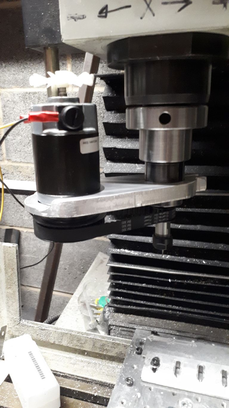

                                                  spindle2.jpgFinally got my calculated 18000 RPM spindle done. Motor and spindle get very hot so will keep me warm this winter. Hopefully will bring the machining times down, 10 hours was getting a bit long!
                                                  Cheers Michael.
