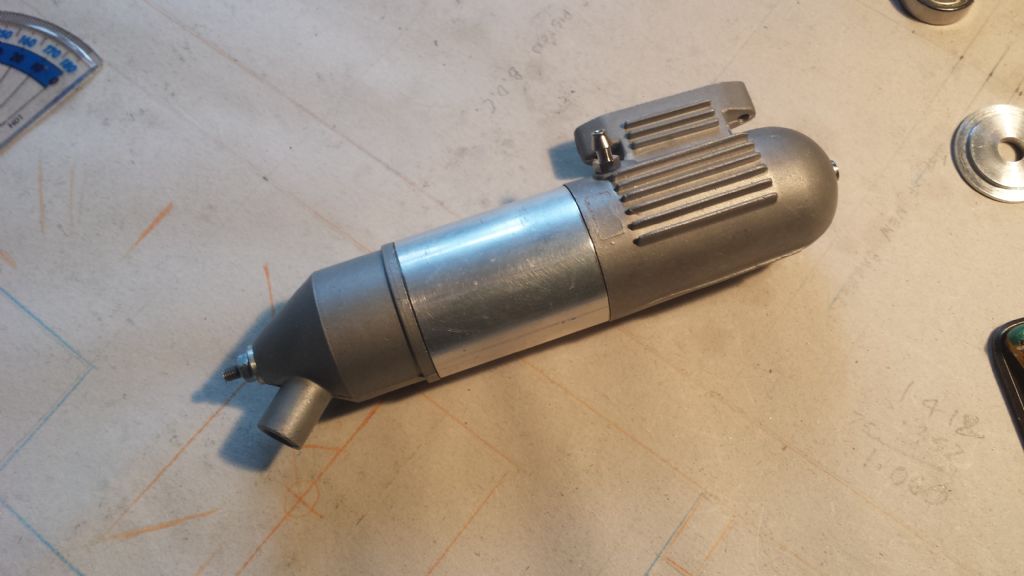

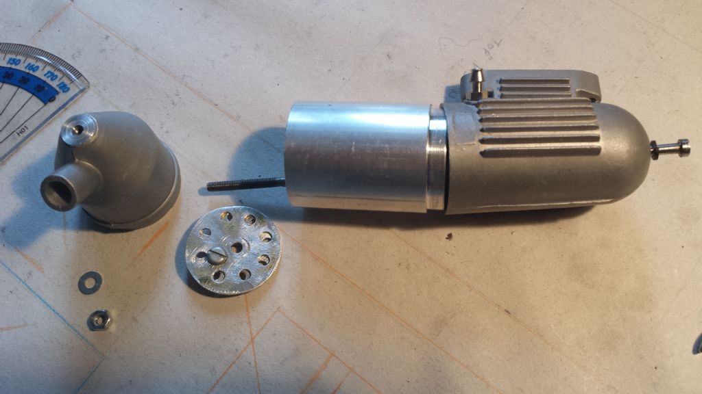

          super quiet silencerHi All,
          This morning I modified the silencer for my aero engine (FIREFLY 46).
          I bought the basic silencer from just engines. All it is is just a hollow chamber, no baffle plate.
          There website shows you how to make a super quiet silencer, which is quite a simple procedure.
          All it involves is is inserting a short length of alloy tube shouldered at one end and recessed at the other to accept a baffle. The baffle I have made is in two parts and joined together with a self tapper. The size of the holes can be adjusted by rotating the upper plate. I also drilled the end of the silencer and inserted a shouldered and threaded bush. The external nut now just acts as a lock nut.
          Not tested yet but my guess is it will be ok. geoffsuper quiet silencer

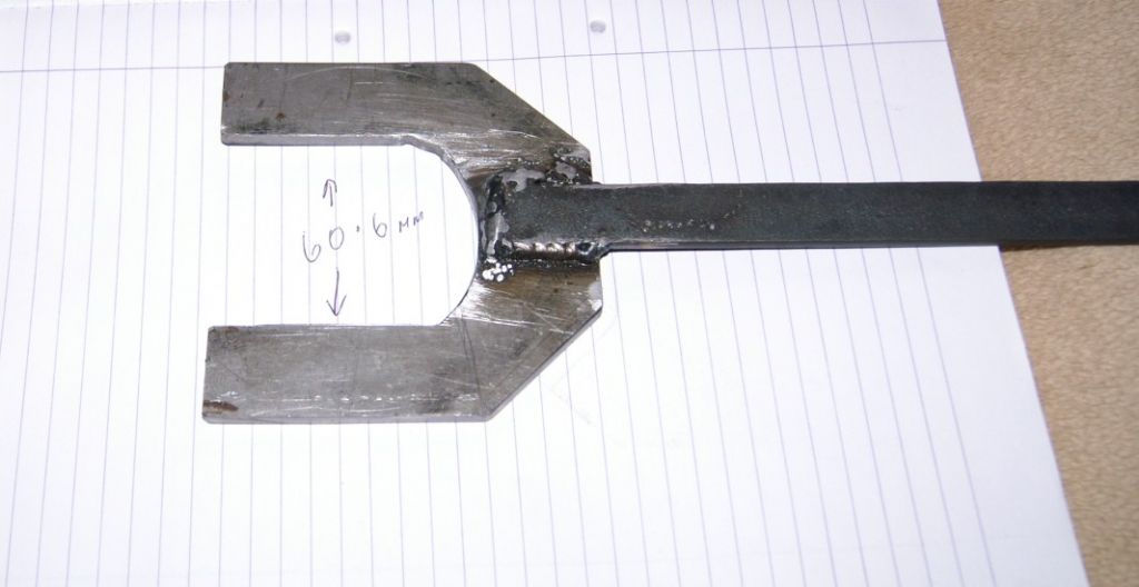

                                                  Today I bodged up an M44 spanner for a mate (60.6mm AF).
                                                  I stamped it '44' in case he gets it mixed up with any similar spanners in his box wink 2
