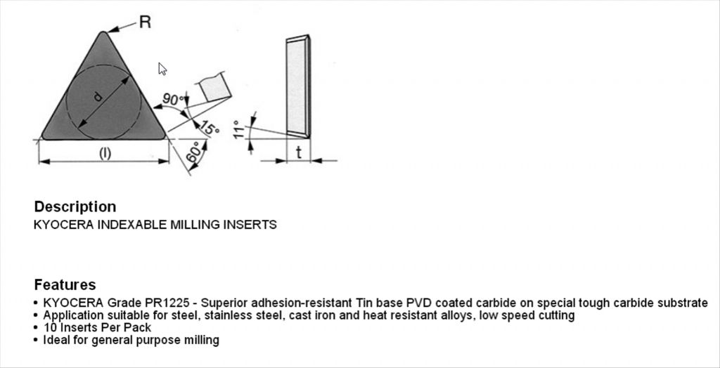

      Does anyone know what these insets are, I have enough to make it worthwhile either buying or making a tool.
      Length across edge is 14.2mm
      Thanks!

          Hi Chris,
          Not exactly sure of what you have but similar to the inserts which I use on my milling cutters. Lots of tools available that use these inserts at a reasonable price. (Take them with you to a local machinery tool store and confirm if they fit their cutters. Easier than making a special holder). Paul.
          ISO TPMN 160308, Grade PR1255
          t =3.18mm, I =16.5mm, d =9.925mm, R =0.8mm

              They look to be " negative " inserts TPMG style, if thats the case, then they will be double sided the the clearance angle is provided by the toolholder. TCMT are the positive rake inserts {amongst other variations of the "T" type.
              Positive rake inserts are the best suited for small lathes.

                I suspect you'd have a pretty miserable time trying to use these. As Raymond says, they are negative inserts, so you'd end up with negative top rake and the tip radius is massive by our standards as Vic points out.
                As Raymond suggests, you'd be better off trying a TCMT (triangular) or CCMT (rhombic) positive rake insert. There are also versions for aluminium with ground finish, different (no) coating and higher rake which give excellent results (TCGT and CCGT).
                Note that as well as the basic shapes and dimensions of the inserts, there are many different cutting edges to choose from.

                    Look closely at the first photo. The triangular faces are flat and parallel and the axial faces are perpendicular. This means that the only way you can present them to the cutting surface is with negative top rake. That would be OK for copper or lead but suboptimal for steel and light alloys. The upside is that you get 6 identical cutting corners. Doesn't really matter if you are turning or milling, the process is essentially the same.
                    In contrast, Paul's illustration shows a zero or positive top rake insert. It isn't double sided so only has 3 cutting corners but you can present it with positive rake with a suitable holder.
                    Are you convinced that your milling cutters are like the photo, rather than the illustration? The common or garden indexable milling cutters from Glanze (Chronos) have positive top rake inserts.

                                Thanks, yes they are negative rake, probably not worth the bother then.
                                I already use CCGT inserts.
                                Thanks.
