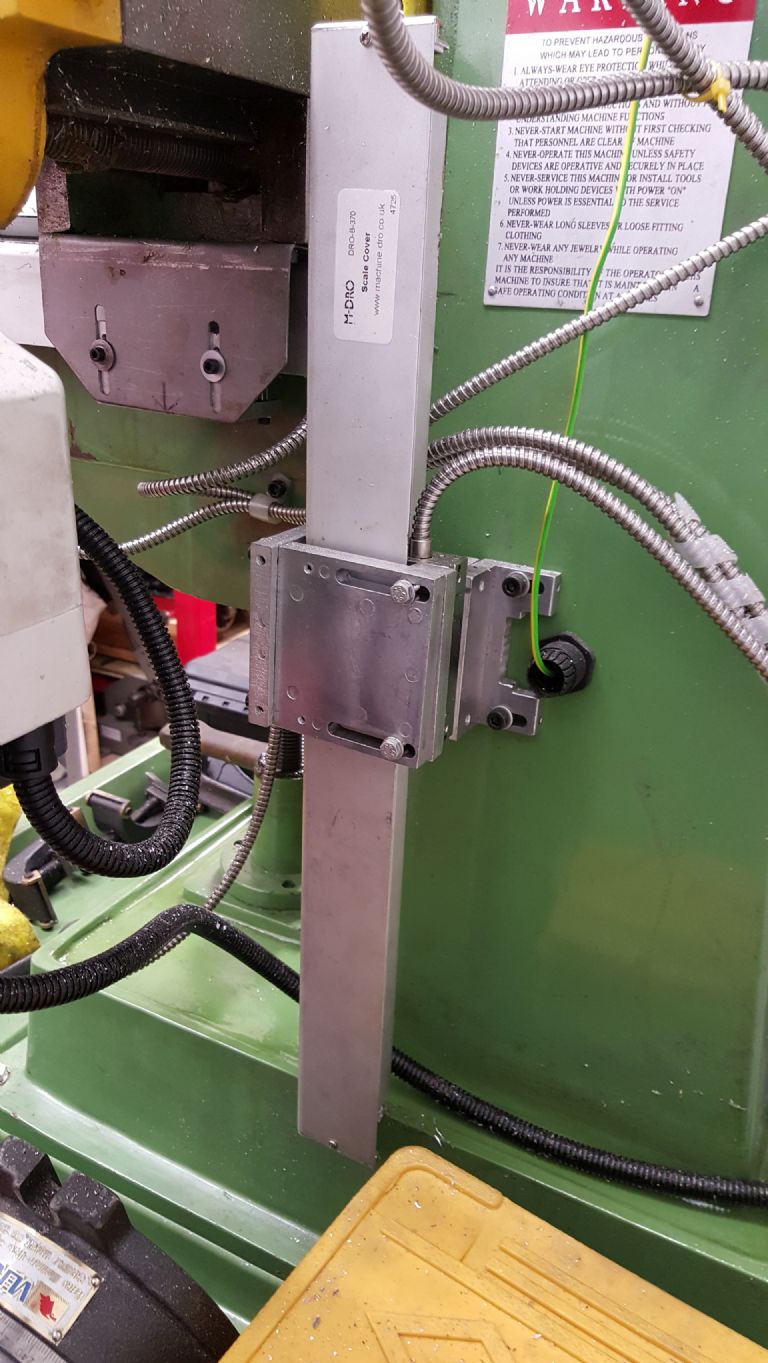

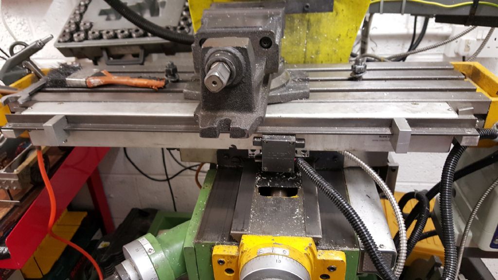

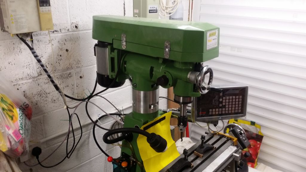

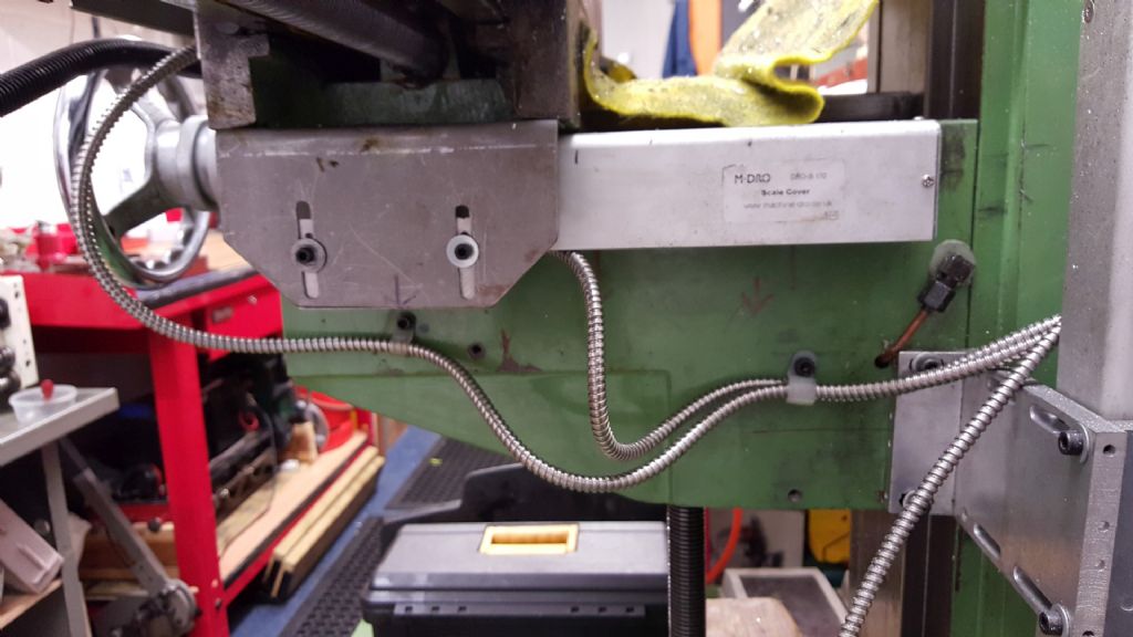

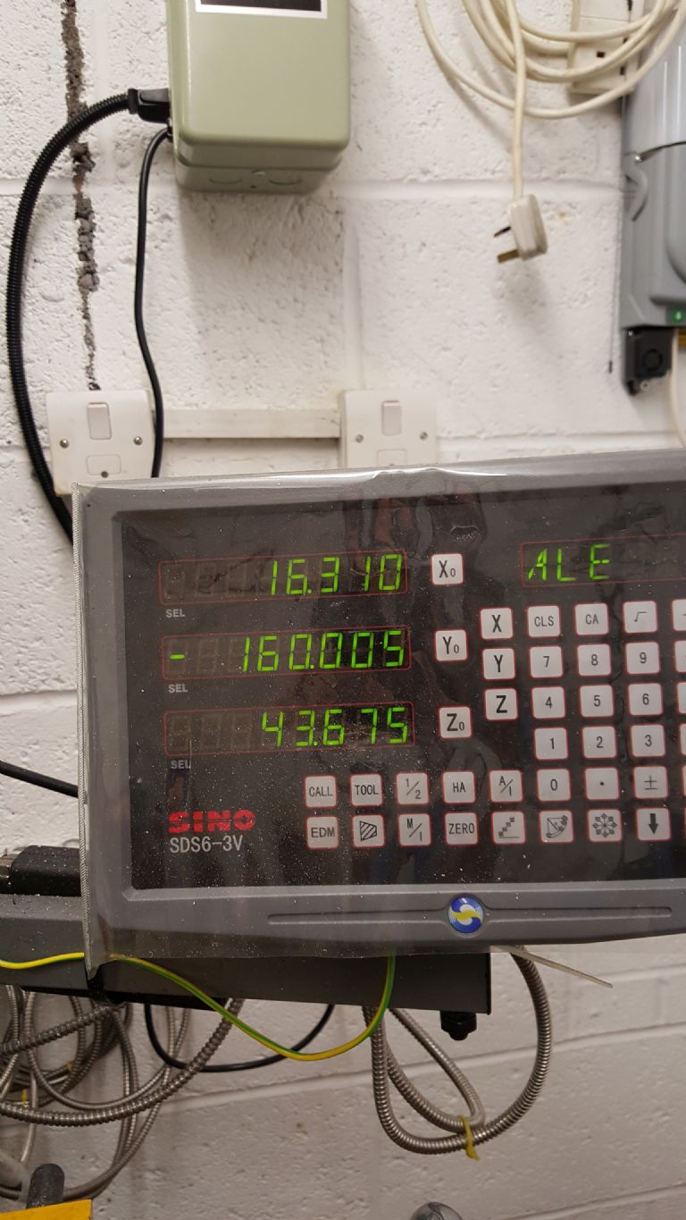

                      I recently helped a friend commission a new Warco VMC mill. We converted it to 3ph with a VFD and added DRO (from Machine-DRO) to all 3 axes and the quill. The latter combines with the Z-axis to give an overall Z-axis reading.
                      We put the X-axis scale in front of the table so as not to compromise the Y-axis travel, which remains at 160mm. Heres the mill showing the raising block.
                      Here's the maximum Y travel
                      Here's the location of the X-axis scale.
                      The Y-axis scale
                      and the Z-axis scale

                        Gary,
                        Thanks for posting the pictures, it's always good to see how others have approached a project. I see you've mounted the z-axis scale on the righthand side of the machine. All the other installations that I've seen have this scale on the left – more food for thought! Now that I have a 200mm scale to fit on the y-axis, I, too, can do away with the mechanical travel limit contraption and use the (not inconsiderable) space that it uses up to mount the scale. I hope to make a start this morning after shopping.

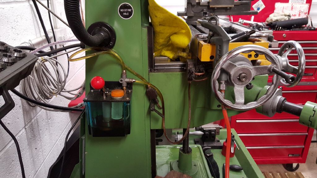

                                Gary Wooding
                                  @garywooding25363
                                  Hi John,
                                  The Z-axis scale was fitted to the RHS because the the oiling system was on the LHS.
                                  We fitted a small piece of angle-iron on the front of the table so as to retain the ability to use Y-axis stops.
