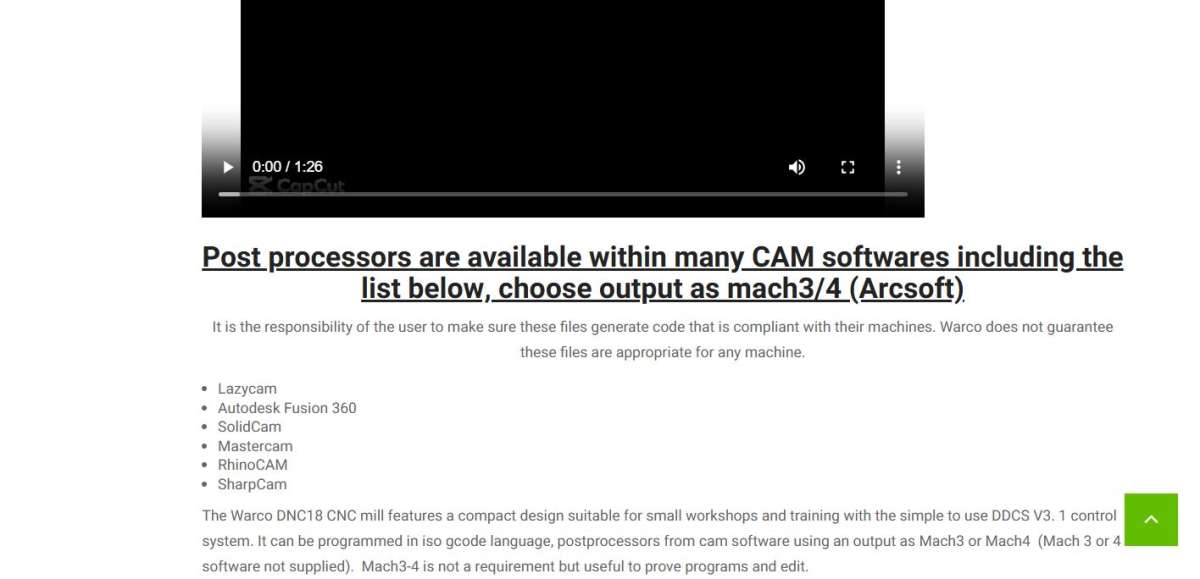

                  Does Fusion 360 CAM have a Post Processor for Digital Dream?  My preliminary research suggests not but does this matter?

                    Warco site says you can use the Mach3 PP. DaveS who posted earlier in the thread uses F360 so should be able to confirm

                      Is use Linux CNC as a post, cant remember offhand of if I have to tweak it. (Currently building a touch probe in the Garage)

                                I design in Alibre Professional but use the free Fusion360 for all my CAM without problems. Seems selecting the Mach3Mill post processor in F360 will work for Digital Dream
