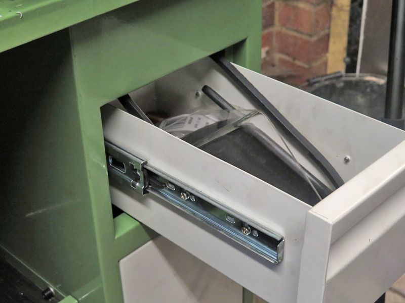

      This one is probably a dumb question , but does anybody know how to get the draws out in Warco cabinets ?
      David

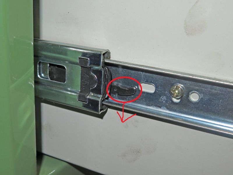

          Hi David,
          There's a little black clip about an inch long just in front of the outer rails. Pushing the clips down on both sides should allow you to pull the drawer out.

            Thanks Ed – no doubt I'm being thick but I'm not having much look. Is this the clip you are talking about?

              Yes that's the one. On mine I just push them down and at the same time and pull the drawer forward. It's kind of a 3-handed job
              I was just thinking if the rails are mounted upside down then pull up instead of pushing down.
              Ed.
              Edit: I just double checked and it appears that you pull one clip up and push the other down. frown

                You usually have to push one down and the other up as this type of extension runner is not hannded, the one in your photo needs to go up. Hold both up/down at the same time and firmly pull the draw then it should come out.

                  Brilliant – thanks both!
