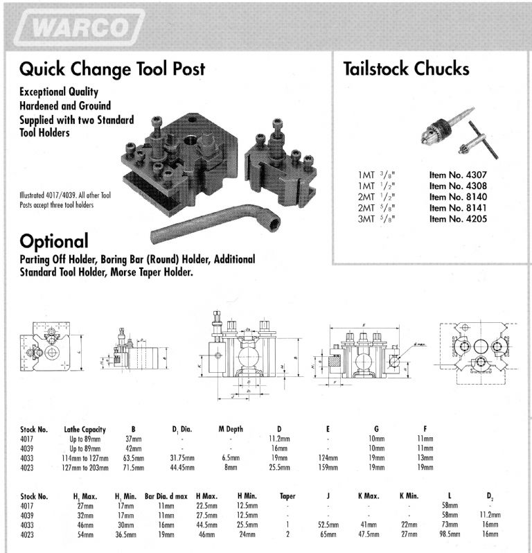

Sometimes, suppliers quote the different models based on the centre height above the Cross Slide, where the Toolpost sits, or provide dimensions of the Tool Holders, so that you can work out which size you need, based on the size of the tooling that you use, and the stud that retains the Toolpost.
