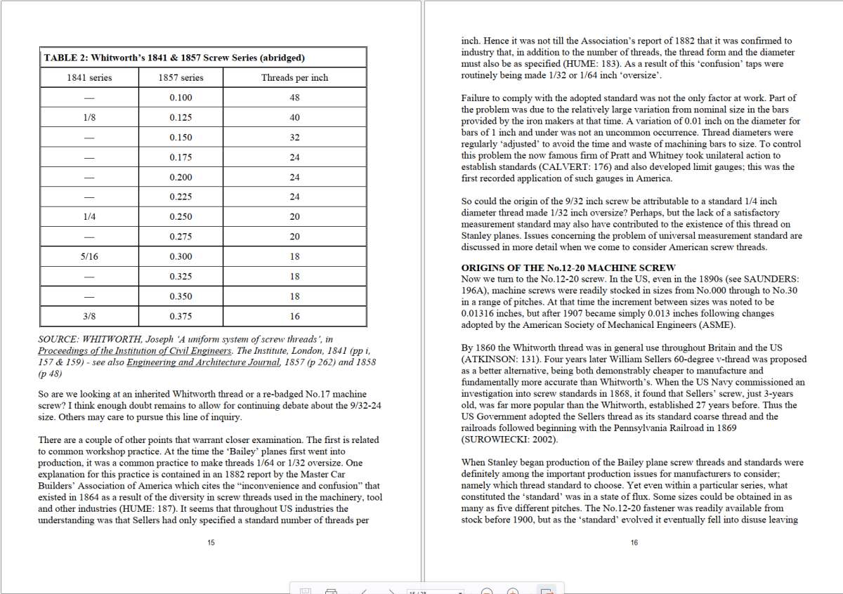

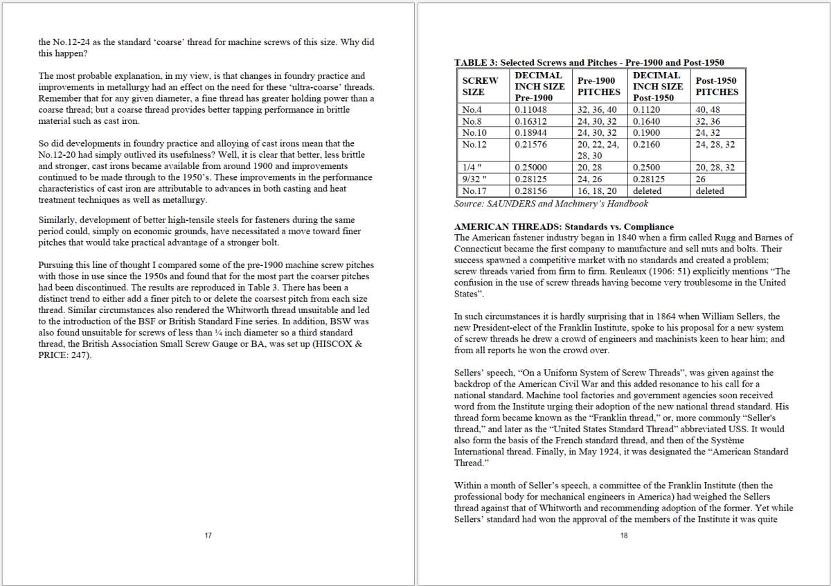

            Here’s a couple of pages from the second pdf. Both are worth seeking out and reading, but outside of Facebook, I can’t find a current source.
            I originally found these on an Australian page, which now seems to have some content corrupted/off-line
            https://tttg.org.au/tttg/about-us
            I believe the author is part of that group.

                      The two documents cited by peak4 can be found as pdfs here and here:
                      https://forums.woodnet.net/attachment.php?aid=16417
                      https://forums.woodnet.net/attachment.php?aid=16418

                                  In the post at the top, one of the requirements was 7/32″ x 20 BSW LH.
                                  Did anyone who read the two documents find any reference to this size?
                                  Sure, there are losts of references to 12-20, which is dimensionally equivalent for practical purposes, but the hand is unspecified and the eBay seller who has the BSW version only offers RH versions.
                                  Hence, are we sure that this size is required in LH thread?

                                      On Michael Gilligan Said:
                                      … excellent reading.
                                      Would you have time or interest to investigate Part I page 16 concerning interchangeability of UN and BSW threads?
                                      Reference is:
                                      Practical Engineering Vol 30, No 758, September 1954, pp 319-20
                                      It has also been cited on the Boxford io group but whether the two are independent discovery is difficult to say.
                                      My searches on the publication are overwhelmed by the YouTube channel of the same name. Maybe I will try an interlibrary loan and see if they can find it.

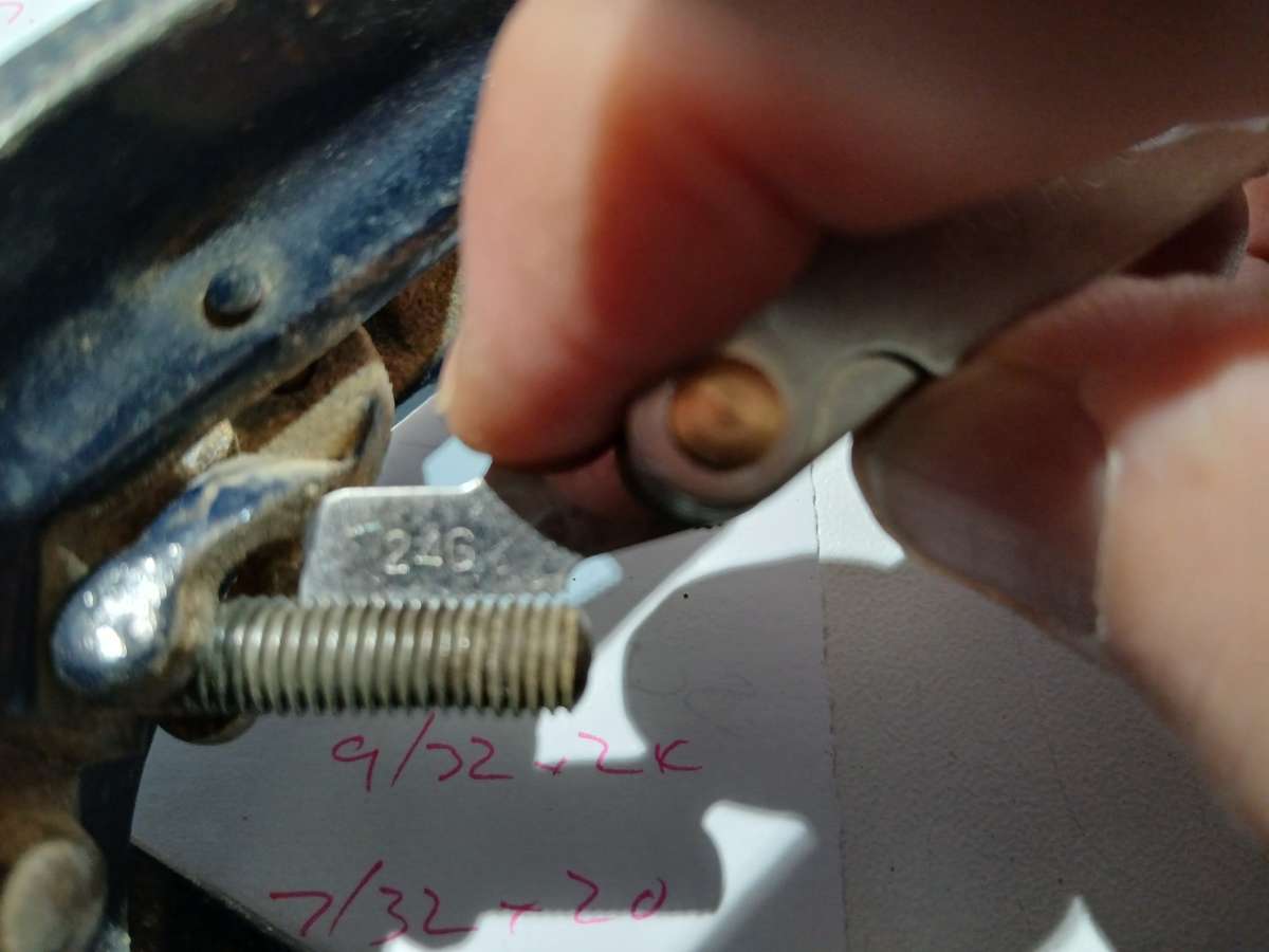

                                        Hi, I’ve just had a look at my Record No. 4 plane, and that has a 7mm diameter LH thread of 55 degree Whitworth form, with a TPI of 24, adjustment screw. Now I think that these are deliberately made non standard so you have difficulty in making your own, or using other manufactures replacements, and while some will go to the trouble of making them, most would probably choose to buy from the original manufactured ones, and of course those that don’t have the gear or knowhow to make their own, have no choice.
                                        Regards Nick.

                                          That wouldn’t be 7mm with an imperial thread would it??
                                          #834692
                                            Unlikely mine measures about 7.1mm so just under the 9/32″ (7.14mm) major diameter of the thread. Which seems about right allowing for several decades of wear, nicks may be worn a bit more.
                                                Hi, well actually it is 7.05mm. Mine isn’t worn very much at all, as although I’ve had it since about 1974, over that time it’s only had relatively occasional use, with respect to those used by a regular user, as I bought it for making my Disco speaker cabinets.
