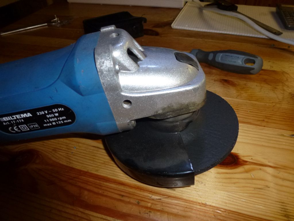

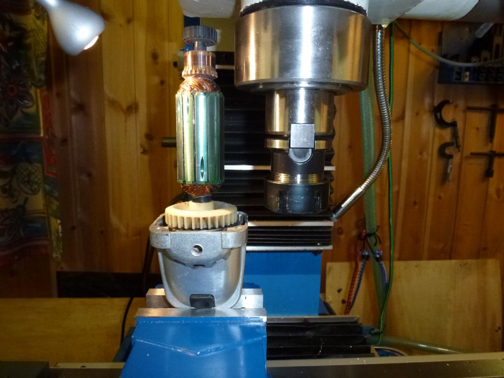

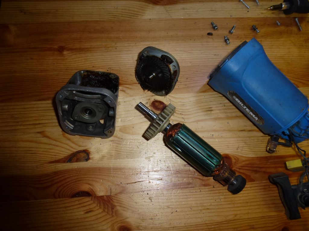

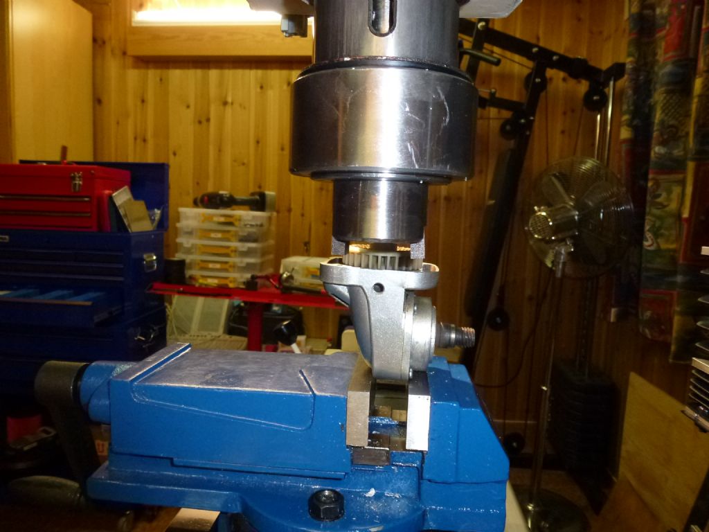

                    Hi Charlie
                    Nice pictures. I see that you have made what I am thinking of.
                    I picked the grinder apart to have a look at it and it looked quite good.
                    The grinder is a really cheap one from Biltema that I bought for about £18 a few years ago.
                    It is 900W at 11000 rpm.
                    The gear has 12 and 37 teeth giving 3.083:1. With my mill this will for 65-3200 rpm give a range of 21-1040, which should be OK.
                    The motor body is centered in the gearbox by a circular flange resting against the gearbox inside of the four holes for the screws connecting the gear to the motor.
                    The Motor shaft has a woodruff key for the small gear. There is one ballrace bearing for the motor in the gearbox, and one on the other end of the shaft.
                    The bearing for the output shaft seems to be quite good, with no play in any direction.
                    The gears also seems to be quite good, although there is a little bit of play there. I can’t imagine that this should be a problem for the intended use.
                    My first thought was to remove the motor and fan, cut the motor shaft to suitable length and fix the shaft in an ER32 collet chuck.
                    This seems a bit long to me, so I’m also thinking of making an adapter between the ISO30 mill shaft and the grinder motor shaft, as this will make the whole thing mch shorter and sturdier.
                    The gearbox is grease lubricated as is, but I wonder if a hypoid gear oil (for car rear axle) might be better. The load on this gear will of course be higher in this setup, but being little bit cautious I think you could keep it down to a factor of, let’s say 2, compared to the design load.
                    900W at 11000 rpm = 0.78Nm
                    mill is 1100W at 3200 rpm = 3.27Nm
                    The only thing now is to make the shaft adapter and the adapter between the gear body and the quill
                    #80360
                    Skarven
                      @skarven
                      A thought I had was to make a ISO32 collet for the grinders motor shaft. I have never seen a ISO32 collet, but it should be possible. Or maybe the cone isn’t right for collets?
