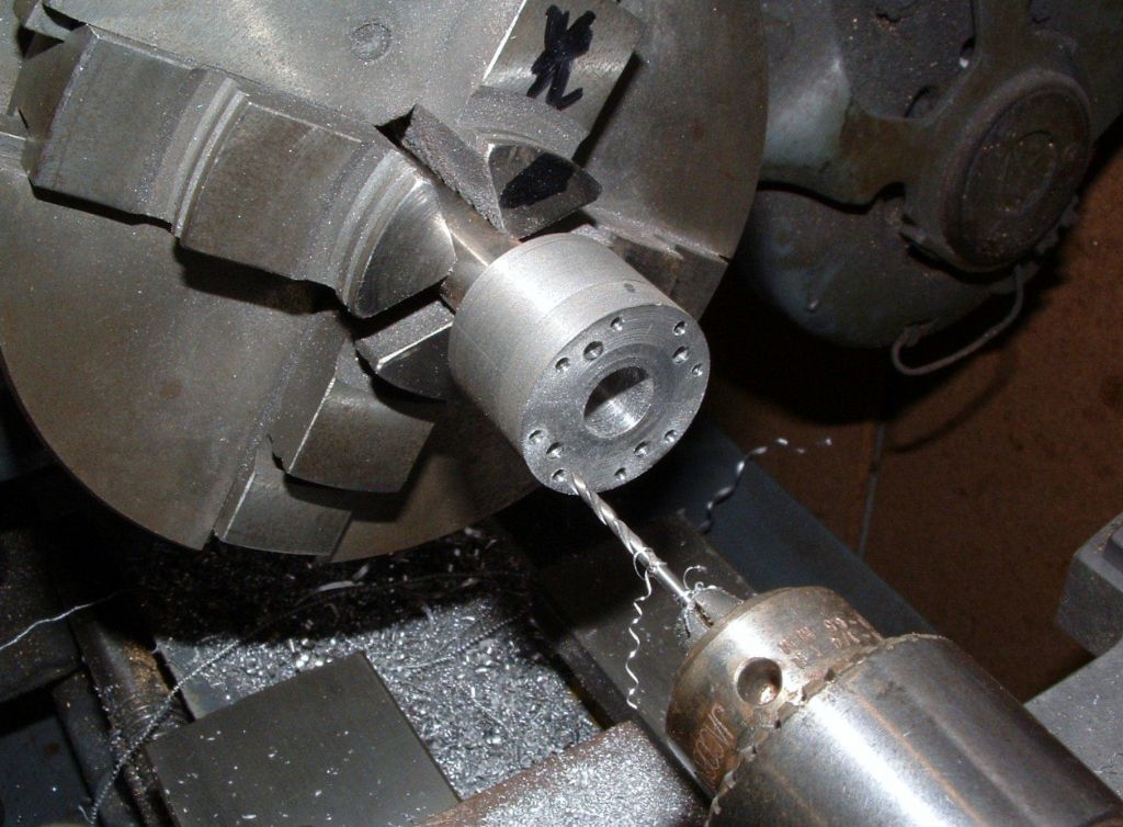

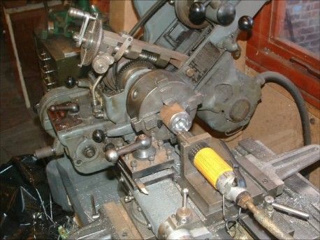

      4-jaw.jpgSome years ago I was given a "Windy" type compressed air drill, I decided to use it along with my GHT Headstock Dividing Attachment. So I made up a right angle bracket, clamped it to the cross slide and bored a hole at centre height to suit the drill. I then drilled and tapped for a clamping screw. The photograph shows making a jig for making cylinder covers.More of GHT Tooling

            The first photo shows drilling the holes for the 4 jaw chuck for the Stuart model lathe.

                        When I was a lad we had men come round to clean the machines, well the big ones. I use an old foot pump for air supply on the lathe. A bit of small bore tubing and you have an easily controlled blast for cleaning eg. chucks. Not enough puff to endanger anything.
