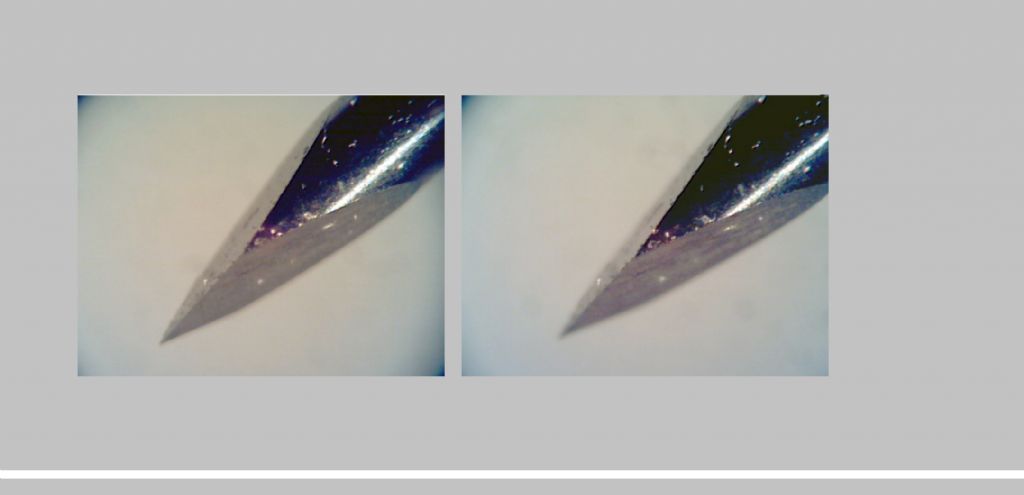

                  I haven’t actually used them in a machine, but I was impressed by the quality of the ‘Roland style’ cutters that I bought cheaply … I can’t see any reason why your plan should not succeed.
                  Here’s a ‘card’ for a stereo viewer [or for ‘parallel’ free-viewing if you can do it]
                  #544791
                  Martin Connelly
                    @martinconnelly55370
                    I can see the 3D version on my screen, same eye relaxation technique as used for SIRDS (single image random dot stereograms).
